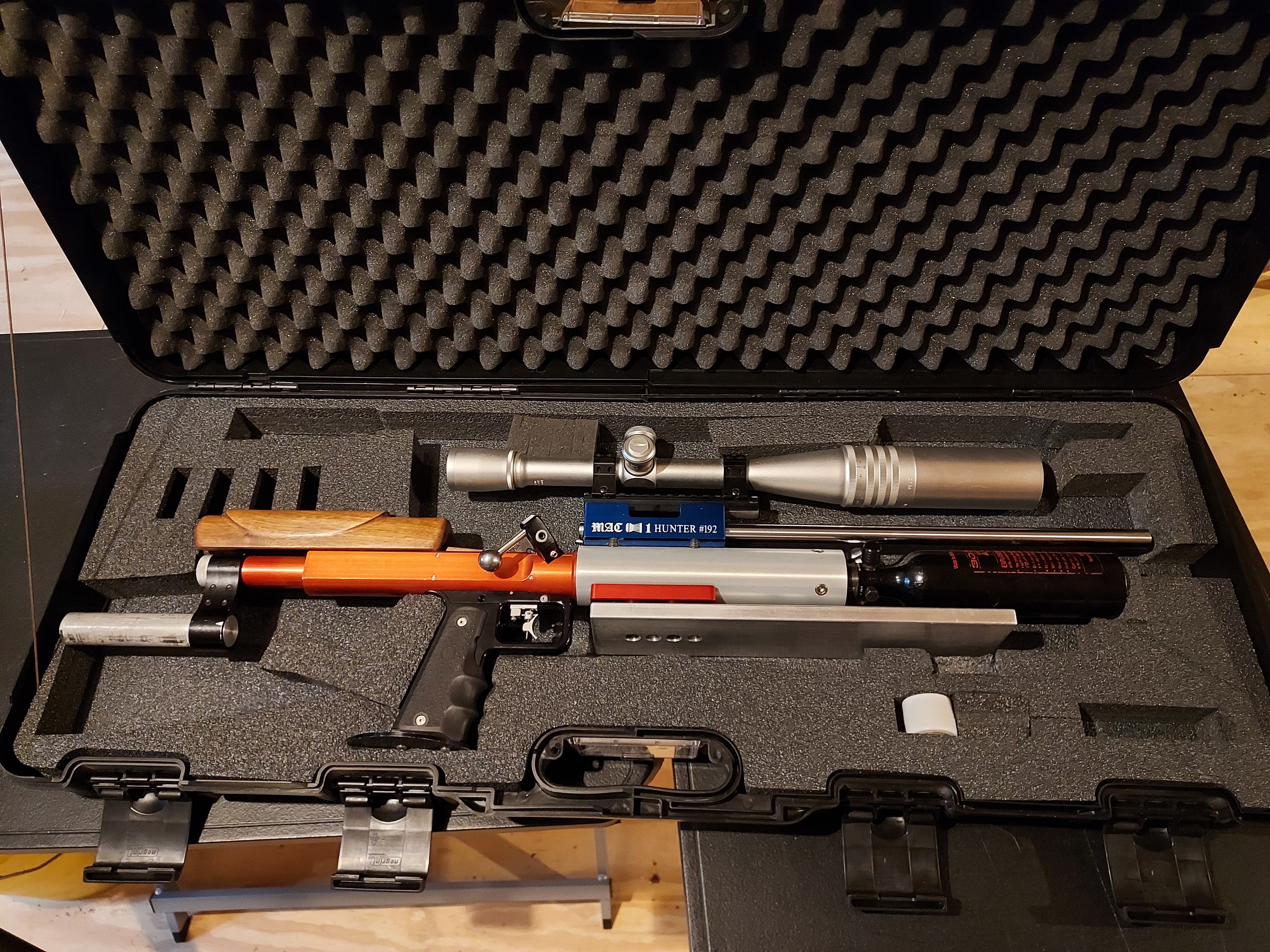

I owned that gun. The barrel was rusted inside and useless and it wouldn't hold air.
Gave it away. If the new owner can get to hold air he will pay me something.
Here it is in all its boat anchor glory:
Rust in the barrel you say? Sounds like it was used as a boat anchor prior to finding it's way to you.
Rust is mistreatment. Leaks are inevitable. Although mine has the same orings it came with when I bought it new in 2018 and no leaks. If I don't replace orings preemptively, eventually it will leak though, as do all PCPs.
Reactions: steve123
It wasn't an oring leak, both the leak and the barrel came that way from MAC-1.
Really unfortunate and quite the contrast to the typical USFT ownership experience. It's been sad each of the 4-5 times I've read about yours. Although sounds like you were at least the third owner. Hard to know what happened to a gun when it was in the prior owner (s) possession.

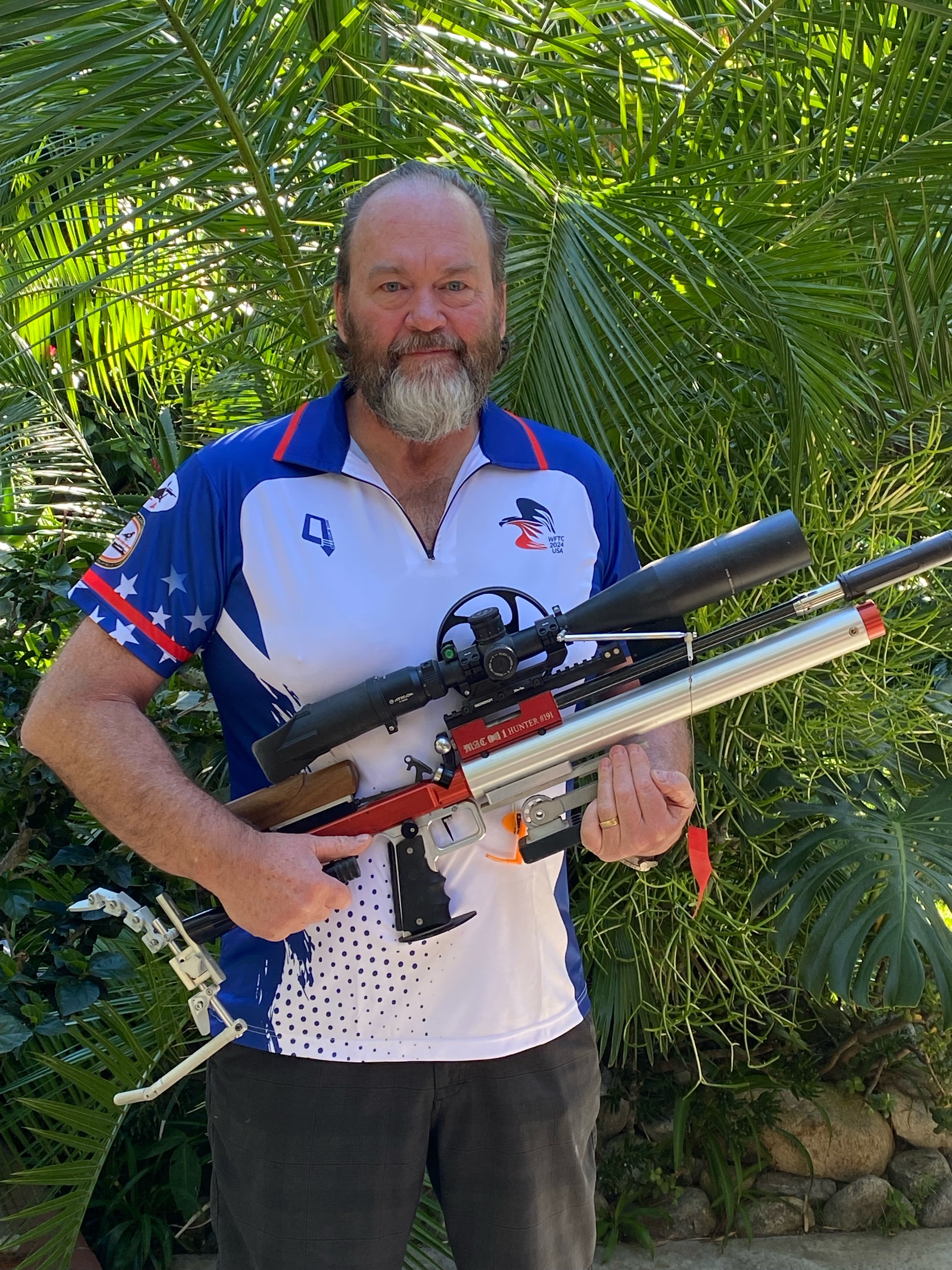

Tuning down my USFT to <12FPE for worlds WFTC in Arizona. It is amazing, 135 shots within 10 FPS SD 2.4 set point ranges 1,200 - 1,100 psi 15 cu in bottle filled to 3K.
Me doping for wind at sub 12FPE, not so amazing. I learning a lot of respect for the WFTF crew.
What'd it take to get down to 12fpe Thane? Different poppet/valve stem? And reduction of hammer spring tension? Or complenty different (lighter) hammer spring?
Also, how's the slow twist poly doing at sub12 fpe? I've heard anecdotals that for <12 fpe a 12 land and groove barrel is better, but I haven't personally had any experience there.
Traditionally a large part of the USFT power tuning comes from changing the poppets diameter. By design the poppet sits within a counter bore above the seat & having a larger poppet decreases flow and creates a greater sail effect to close faster limiting output. Smaller the poppet head greater the flow having less sail effect.
From there it is hammer weight and transfer path strangle screw adjusting. Hammer spring within the rear housing stay pretty much the same.
Reactions: Franklink
Just like Scott says, keeping with the traditional non-regulated USFT, poppet diameter and hammer weight for a proper tune.
My regulated/bastardized USFT is tuned for 20 FPE so for this one competition it's strangle screw and regulator set point. I started with 800 psi set point less strangle screw, 30 fps extreme spread and groups at 50 yds suffered, probably dwell related. Brought set point up to 1,200 psi, clamped down strangle and ten shot groups at 50 yds 3/8". Not the optimal as intended by LD, but very workable.
Slow poly for now, want to test standard twist, but limited with time.
