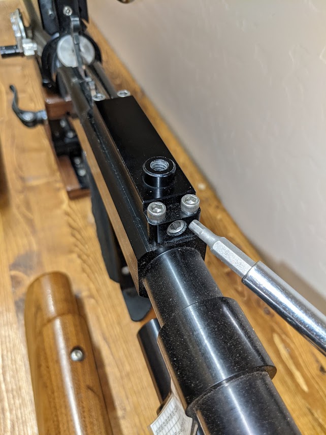

Barrel attachment....

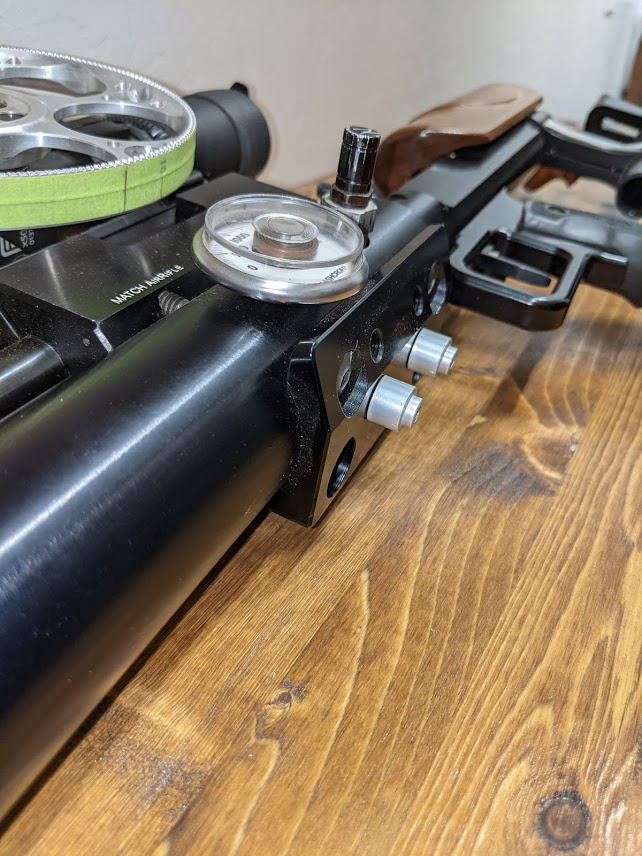

The barrel is held inside the breech by means of 4 large diameter bolts that come up through the baseplate at the bottom of the gun, through the tube, and through the threaded breech. As usual, this is an atypical airgun design feature so here are some photos to help visualize.

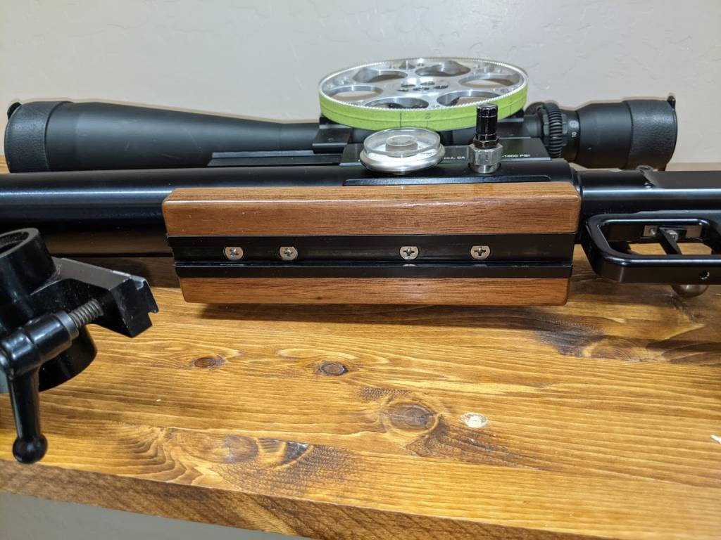

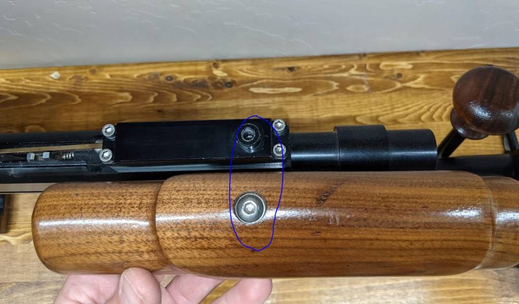

The two phillips head screws to the left here hold the uit rail to the wood block, but the two right phillips hold the rail/block to the gun. (referring to the 4 phillips head screws in the bottom of the Anschutz rail)

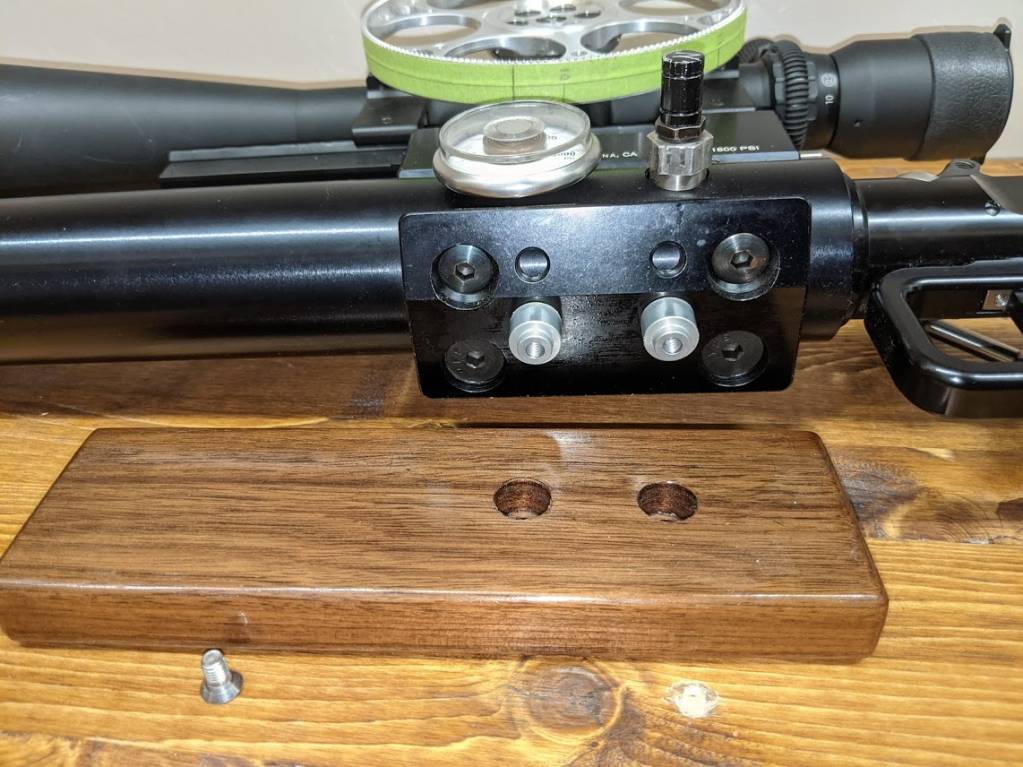

Removing the two phillips screws on the right allow the block to come off the gun, and gains access to the four breech bolts (black headed allen bolts here).
The next couple of pictures show those four bolts, each a couple of inches long, going up through base plate, tube, and breech.

The breech is effectively a giant vise and an EXTREMELY reliable means of keeping a barrel in the same place which = 100% reliable maintaining of scope zero. We're talking about scope zeros that maintain for literal YEARS. Rare in an airgun.

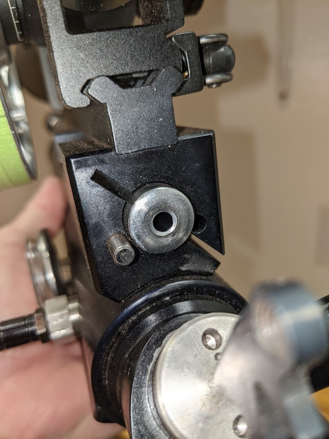

So how does the aluminum breech block open enough to clamp the barrel?
A big diagonal slit
Reduction of the clamping force of the breech on the barrel is mostly done by the two bolts on the same side as the slit, but the two on the opposite side of slit opening also have to be loosened slightly (at least on mine) to be able to pull the barrel.

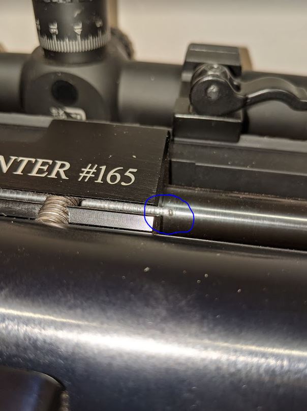

Because I ordered two barrels, Tim provided some hand-written directions on how to replace a barrel on a USFT, in his words:
"For swapping barrels the air can be left in the gun.
To swap barrels: Remove forearm fasteners and remove wood. Loosen two large action fasteners on right hand side of lower base plate 2 turns. Make sure transfer port is closed. Hold barrel so it wont slide out. Witness mark barrel being removed at slit in barrel mount to preserve scope data. Slide barrel out of gun and slide replacement barrel in. Support muzzle by work surface with gun vertical. Pull down on grip and tighten large action fasteners. Test tension of transfer port/breech to barrel fit and adjust for engagement. Transfer port to barrel tension must be set with air charged gun."
Here is the witness mark (in blue) I added to my .177 barrel so that it can easily be returned to the same location if ever removed.

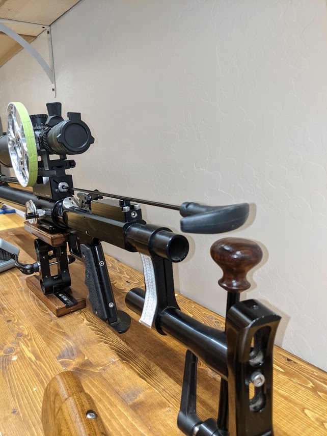

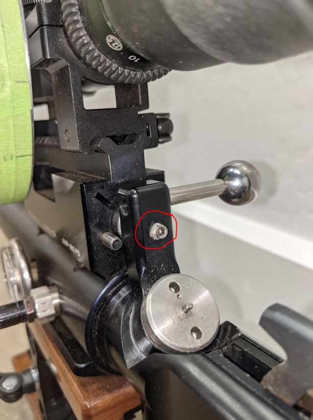

While I'm talking about the barrel, here is one of the really user friendly features of the design.....
After removing the cheekpiece by means of the single silver allen head bolt here
Completely unfettered access to the rear of the barrel is achieved, talk about easy cleaning!!! (well I guess you gotta cock the gun to get the hammer out of the way, but still, easy-peasy compared to most guns)

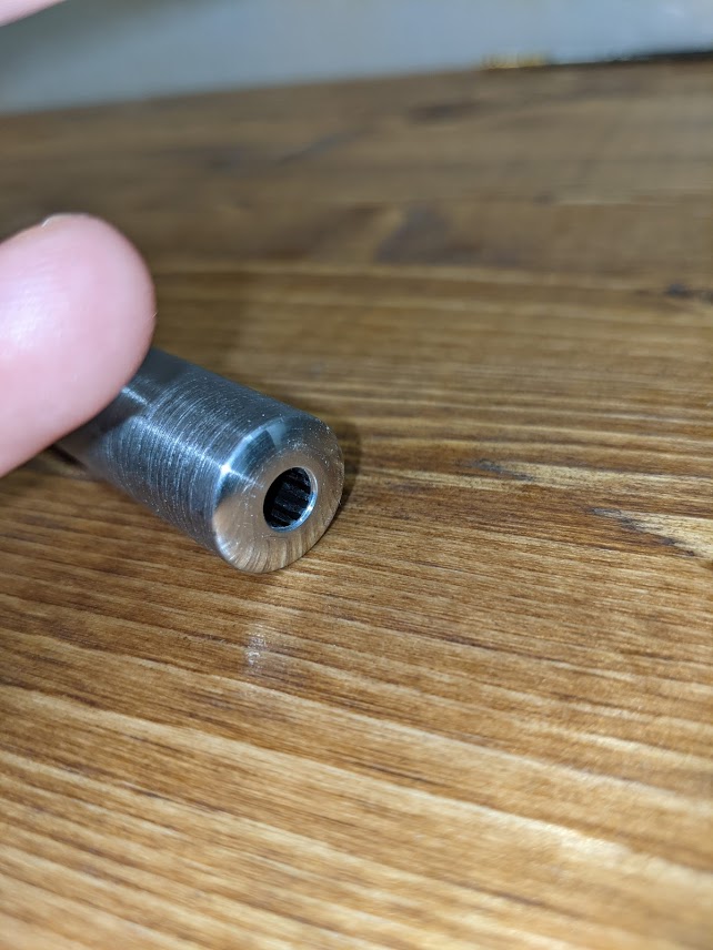

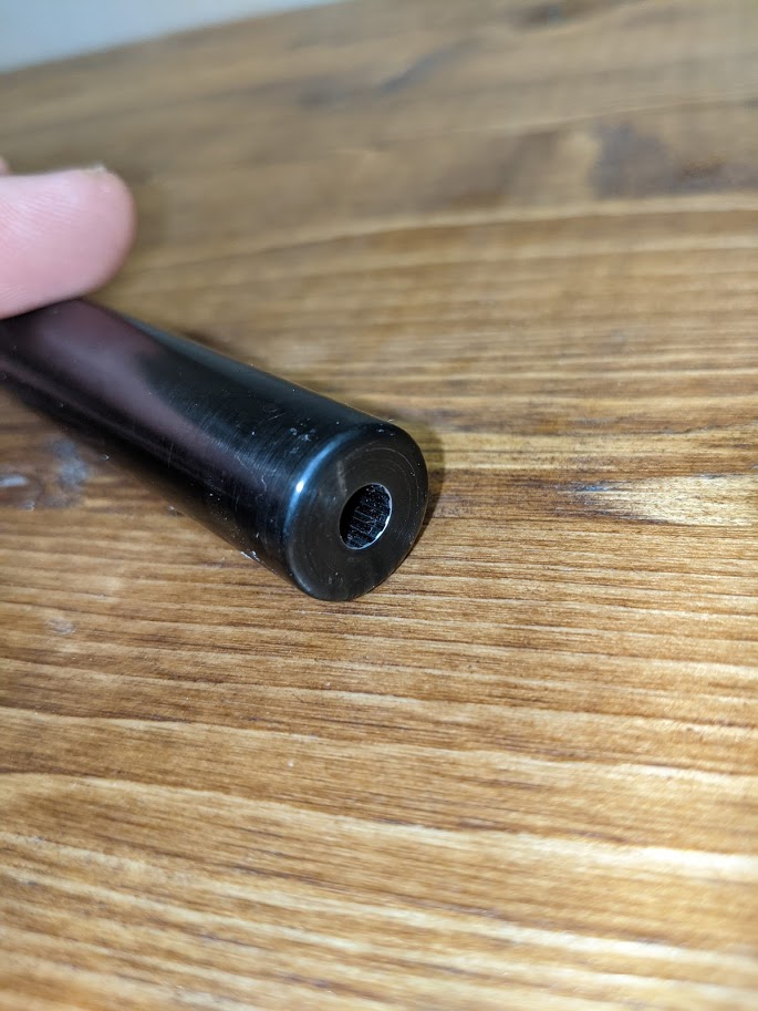

Here is the leade and crown of the .22 barrel

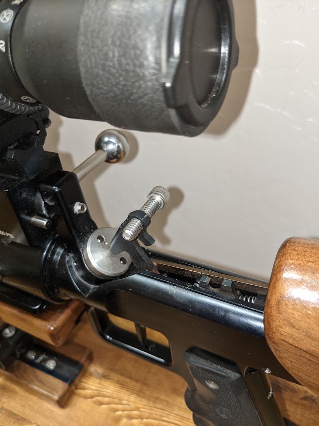

Transfer port restriction: this was not an option on the earliest USFTs but later specimens have a small grub screw in the back of the transfer port that restricts airflow through obstruction, further "in" equals reduction of power. Circled in red here (The white is a little bit of teflon as insurance to keep it from moving). This is more of a fine tuning of the amount of air that hit's the pellet (power output).

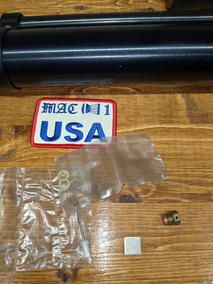

Furthermore on the power adjustments, Tim included an extra valve stem/poppet. Seen here:
(also seen here and supplied with the gun is an extra burst disc, some extra orings (seals swing breech to the barrel I believe), and an extra "foot" which is essentially just the sacrificial piece of metal within the kneeriser that exerts pressure on the opposite rail when tightened-keeps the bolt from marring the trough of the Anschutz rail. Oh, and a patch.
So, for really serious/curious tuning, Tim sent a note with my gun that says, "0.2fpe per 0.001" diameter of valve head." I'm not sure if he meant the valve stem can be reduced by 0.001" to gain 0.2fpe or if the outer diameter of the delrin has to be reduced by that much to gain 0.2fpe. My gun is going to stay at its just under 20fpe power level so I won't every be testing out this theory, just thought I'd include it for any interested parties.

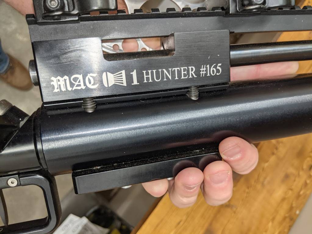

But I caught a guy selling his (#207) in late June, he took delivery in Jan '21 so its almost brand new. Havent had time to get it sorted out yet.
Butt ugly guns, but cool in that same sense. Remember: the target does not care what yer gun looks like :)
Dunno how true this is but Ive heard that Mac-1 has the receivers made in batchs (including the anodizing) and the numbers on them are not a sequential production number, just the number thats on the, say, red one.

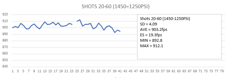

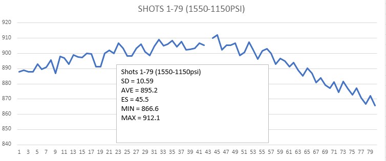

Here is the breakdown from that recycled 2019 string.
I intentionally overfilled, and shot down past the 1250psi, just for the sake of collecting data. (The break in the plotted line was an error in the chrono).
The gun is good for a very consistent 40 shots and actually more than that throughout a match as the temp increases. I've shot 48 shot matches without refilling. The rising temp throughout a morning increases the tube pressure enough to get some extra shots. I've also had the opposite happen to me, with decreasing temps the gun will lose a few shots. The important thing is that I know if the gauge is between 1450 and 1250, I can 100% trust the fps to be consistent enough to have complete faith in where the pellet is going to impact at various distances.

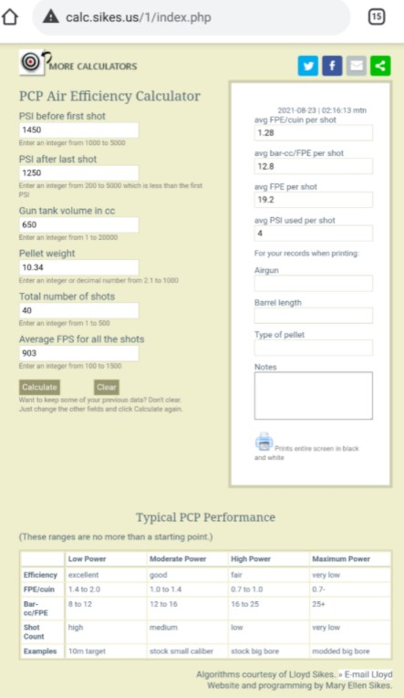

Here's the efficiency numbers, not too bad, 1.28fpe/cu inch per shot-puts it in Lloyds "good" category. (thanks to Lloyd Sikes for making these calculators available for general public use).

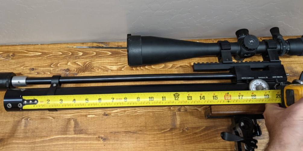

So, how big is that tube?

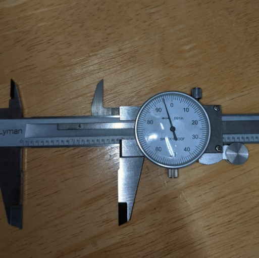

The air holding portion of the tube looks to be 19-20.5 inches long. I'm not sure where the end piece stops at the rear of the tube.
Outer diameter of mine is about 1.995in or 5.07cm.
Arzrover measured the inner diameter of the tubes to be 4cm. That gives wall thicknesses of just a bit over 1cm if you're curious. And using good ole V=(pie)(r squared)h for volume of a cylinder, we're looking at a volume of around 640ccs (using radius=2cm and height = 50.8cm or 20 inches).
640cc giving 40 good consistent shots from 1450 to 1250psi.

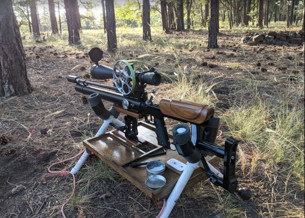

I've not shared much of the actual accuracy of my USFT, as I just haven't shot it much lately. It's the gun that almost feels like cheating when I compete with it, so for regular monthly matches I've usually been shooting something else (in the past year and a half or so). But this past weekend was the STATE match, so I brought out the serious field target gun..
I love to go and spend a night or two camping and hanging out and shooting and talking airguns and spending time with airgun friends. Something bout sleeping in a tent always makes me wake up with the daylight though. And because of that, I was up pretty early on Friday morning. Decided it'd be a good time for a little reaquainting with the USFT, as I intended to shoot it for the competition on Saturday.
Here's an early morning glamour shot from that brief practice session.

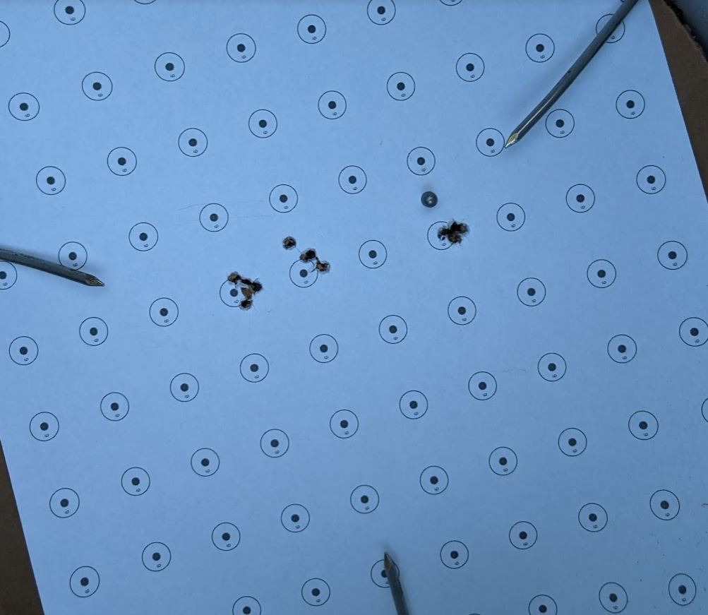

These groups were all from the first 20 or 30 shots that morning.
Off to the left here it took 10-15 shots to get settled into my position, then I shot the 5 shot group on the right. 27 yards from bum bag. .177 pellet sitting there, head up, for size comparison.
And from that tight 5 shot group above, went straight to my other pellet trap, set at 47 yards, and shot this ten shot group. .177 pellet in the frame again for size comparison.
The couple shots in the upper right that started to wander away from the center of the rest of them were shooter induced (operator error).
Shot a bit more that morning but knew the gun would simply do what it does for the comp on Sat.
Went on to shoot 48/52. I think only Lauren Parsons was the only higher first day total than that, at 49.
My 4 misses were 2 of the 6 offhand shots, and 2 of the 4 kneeling shots. So, the trusty USFT went 42/42 on the field target standard bumbag position shots, and 6/10 on the forced position shots. That says a lot more about myself being out of practice than the gun not performing up to snuff.

Actually, the air volume begins around 5/8” behind the rear screwhaeds in the front plug and ends around 2 3/8” or so ahead of the pressure gage, entering a much reduced plenum bore area between the four large thrubolts . Your gun is a Carbine version with around 125cc or so less volume than the “regular size” rifle like Bobby’s. 40 to 45 shots at around 19fpe is right on for that gun, and if its tuned to an unusual extent, even 50 plus good shots is to be had (I’m getting around 53 shots between 895-905/10.3gr from a 1450ps charge from my own carbine). I say yours is prolly just under 500cc, depending on the particular design front plug assy, and receiver de-ping parts in it, since there have been some variations that take up more internal volume than others. Don’t forget, since you only use around 1/7 the fill, and the usage of that roughly 70cc of air that averaged around 92 bar … the true usage is really low, less than many regulated guns that seem much larger, but need twice the pressure to operate well.
Early guns all worked best with “good” 10.5 Premiers at about 18fpe using HW barrels, since most LW barrels back then were so over-choked they did’nt do that well with the Crosman Heavy, and that was the best there was for our power levels back then.
I advised folks to clean the barrel at least every 100-150 shots back then … still good advice.

Glad you like it. It doesn’t need much care, but I do notice some rust on the hammer strut that can, if left alone begin to cause a little velocity variation due to drag on the side of the hammer.
BTW, all the older guns had an oring “on” (but not inside the bore of course) end of the barrel, and for good reason, since if a pellet stuck out a bit and you close the breech on it, it can damage the o’ring or even pull it loose so it falls on the ground somewhere and leaves you hanging in mid-match if its on the swinging breech, but not so if its on the end of the barrel.
Something you may not know …. The sear hook that catches the hammer can be manually cocked (without pulling the hammer back) and the gun dry-fired like many high end 10M match guns.
The gun was designed for Field Target, which is what you use it for. The port screw is a useless affectation better left alone (in my opinion), as are the two tiny “adjustment screws” for trigger and sear travel.
If I see you at Morro bay soon, I’ll show you more.
LD
Yes, I very much like it. Thank you for creating such an amazing airgun.
As to the rust, when I got it, Tim had some sort of red looking grease on that pin/shaft that holds the hammer to the hammer strut. I'd always just left it alone but your talk of rust had me concerned. It wiped right off with a qtip, some sort of lubricant I think. The strut itself has the color of heat treated steel, as does the sear hook, at least to my eye. Here are some close ups.
(more visible if screen is maximized)
https://www.youtube.com/watch?v=YxMUmEwU3jw
And you are correct that I had no idea about the ability to bypass the hammer and cock the gun for dry fire practice like 10m guns. Here is that action:
https://www.youtube.com/watch?v=8ae38hqIT08
As for the port screw, once I got it where I wanted it, have not messed with it since. Same for the trigger screws, I've never adjusted them.
