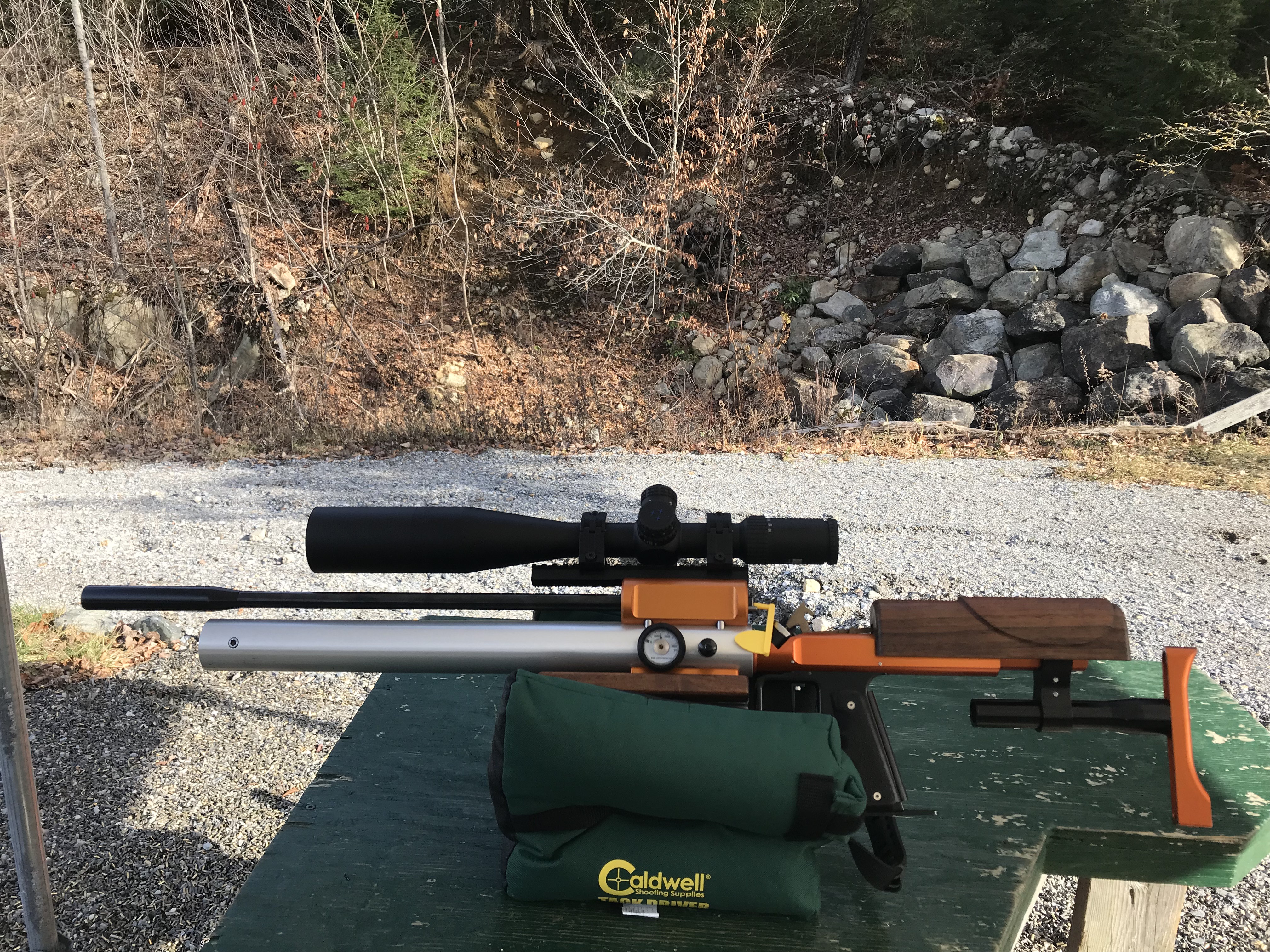

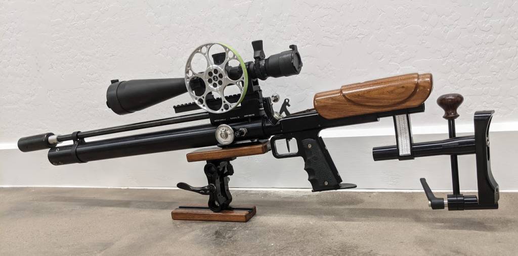

Top one is how I received it. Bottom one how it looks now.
I do not like the looks of the bottle conversion, but it made the rifle more consistent through the Ninja regulator. I am sure I could shoot 200 rounds before needing to refill.

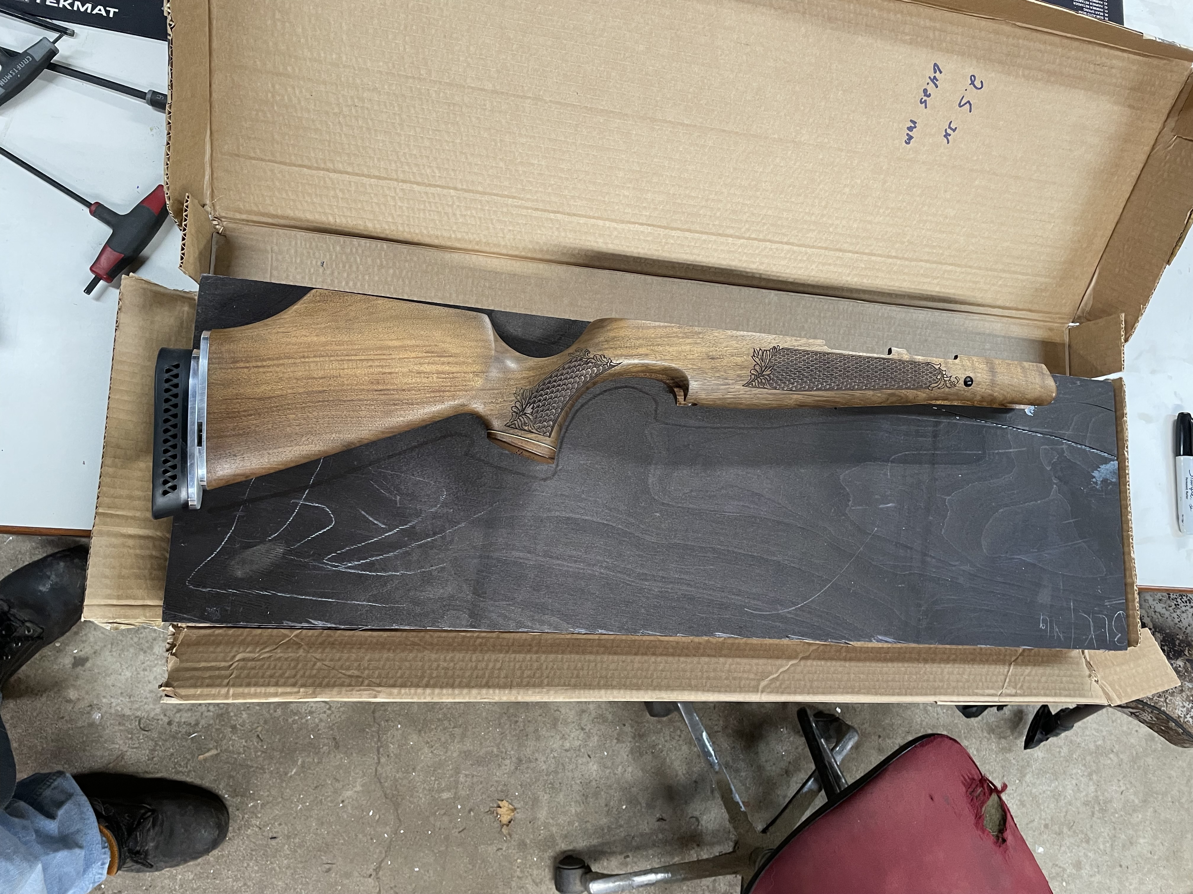

Right now the plan is to make a stock for the TX 200 and a cheek piece, AR style grip and matching forend with UIT rail for my Mac1. I traced out the tx stock and used my 12” band saw to cut the block in two last night. I plan on making more cuts tomorrow.
