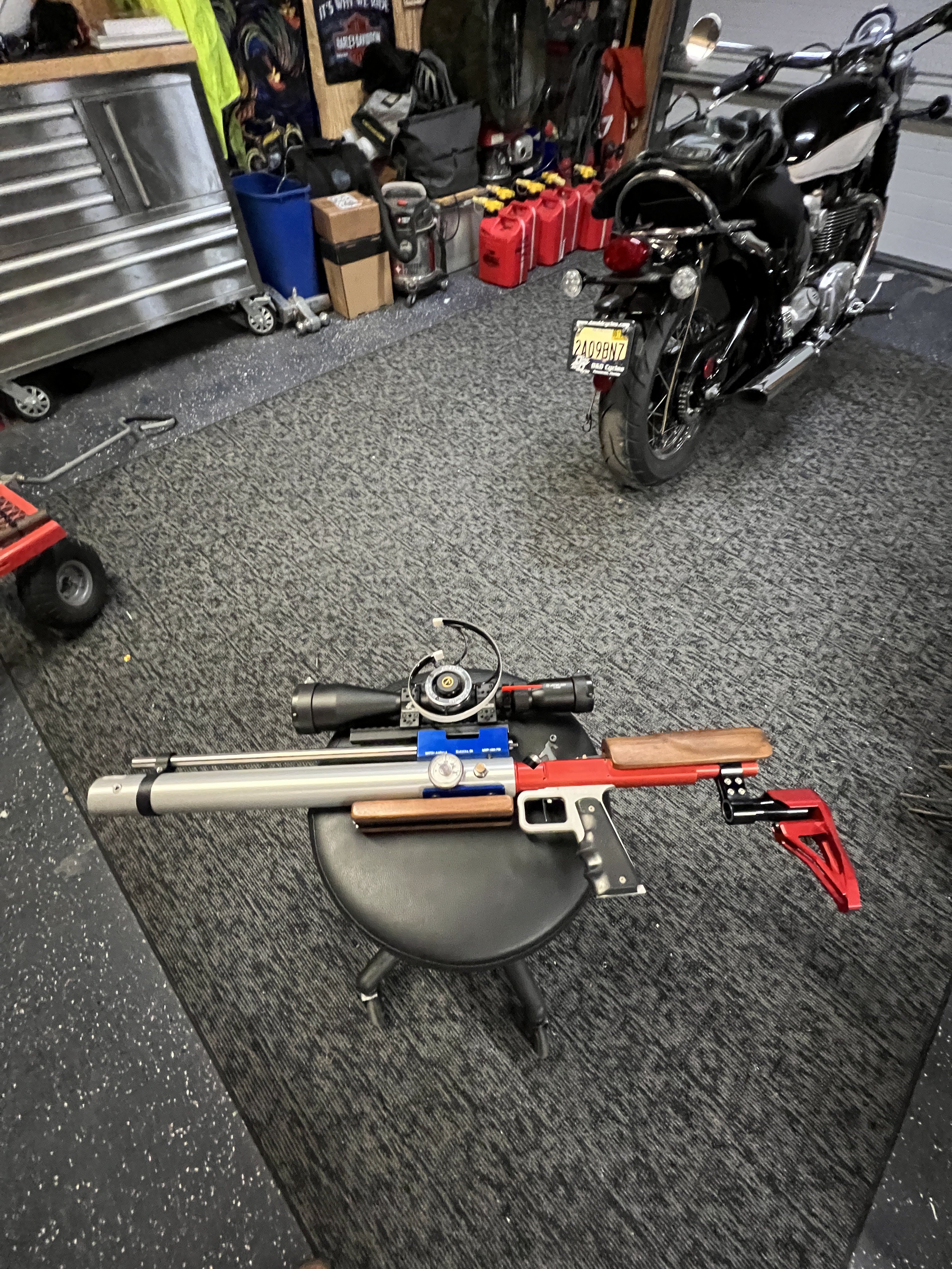

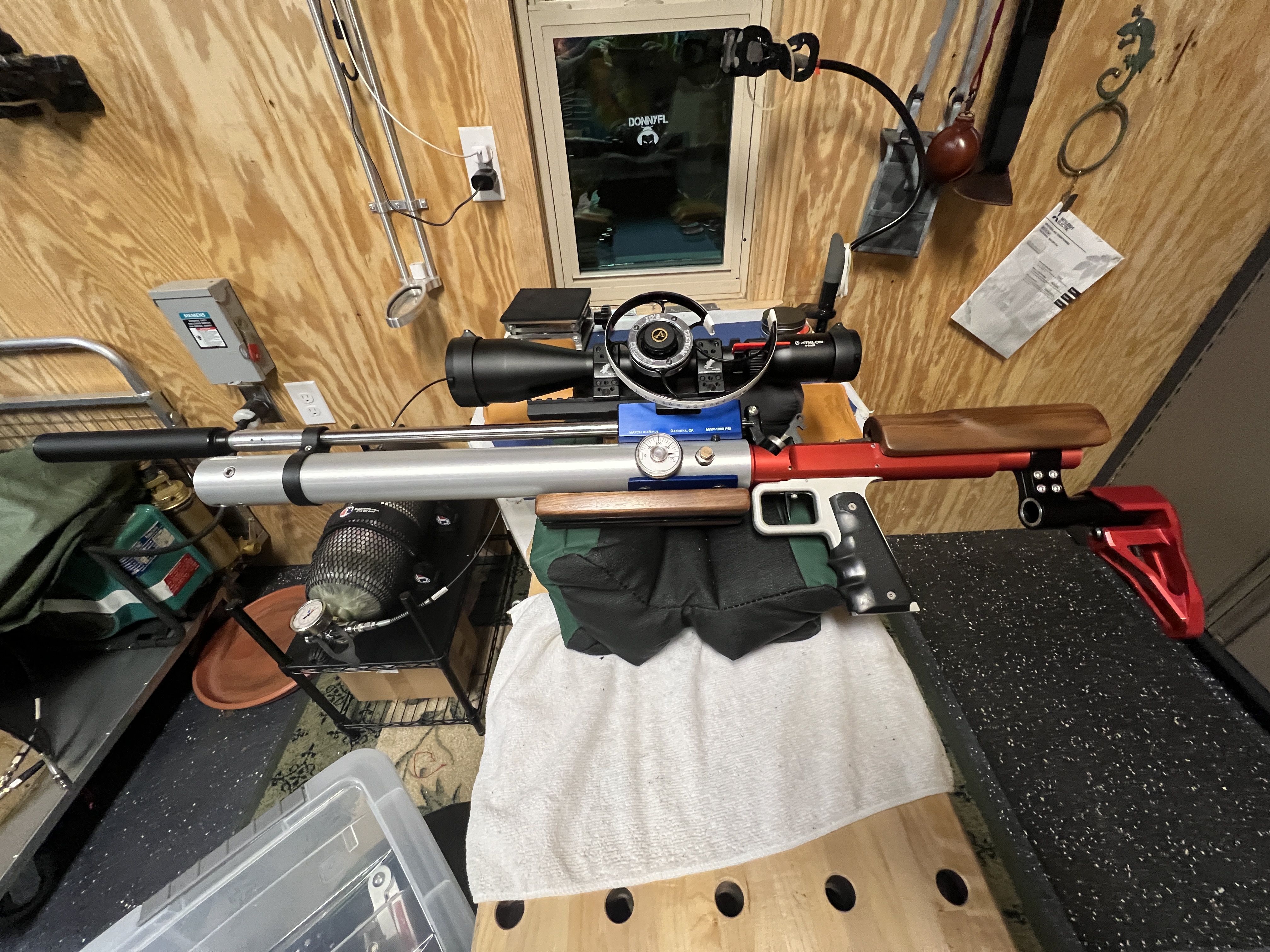

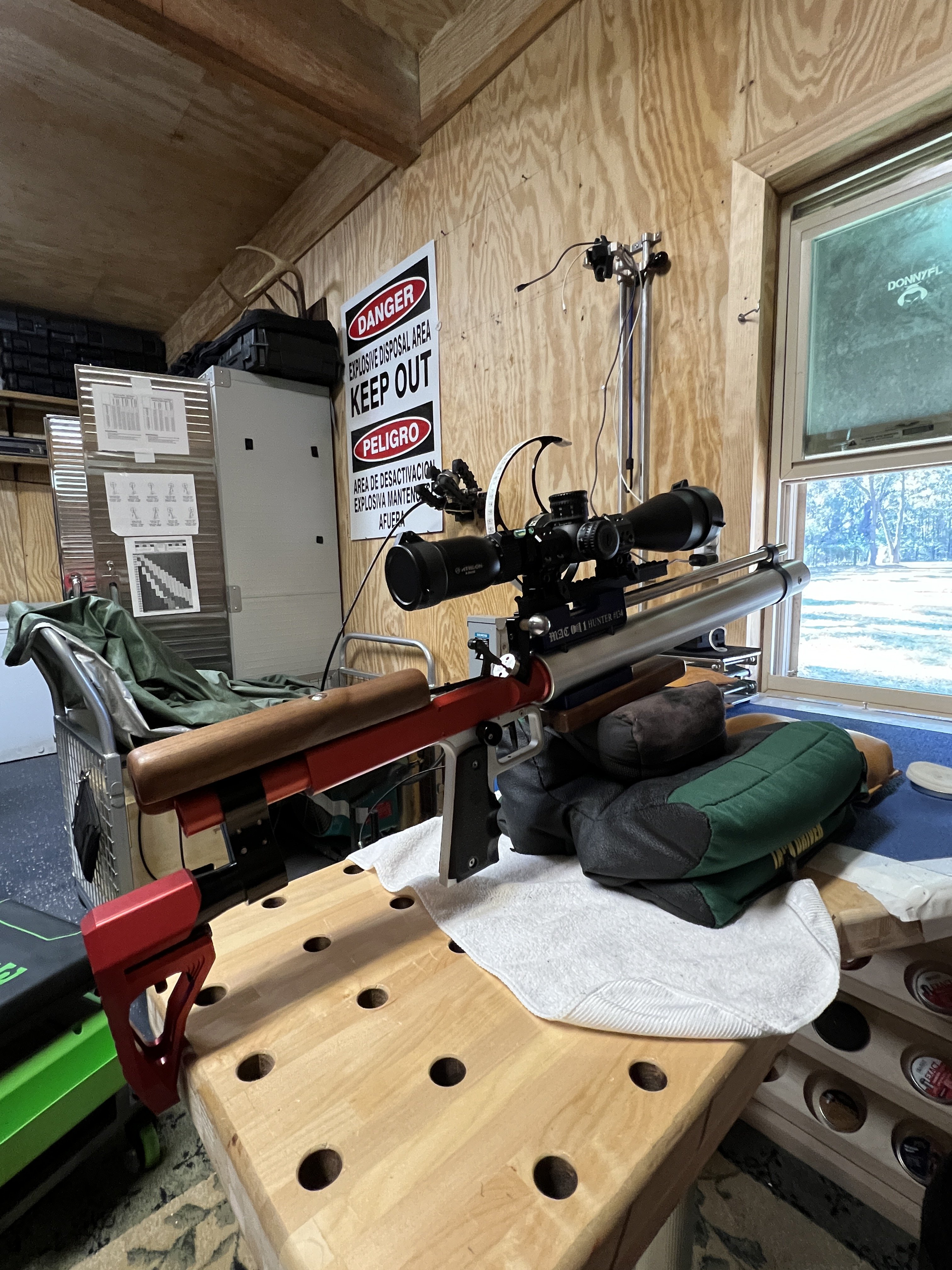

Spent hours playing with this thing
Thanks @BC
Welcome to the club.
Would be interested in your first impressions
Learning curve - not too bad
1800-2100 psi fill and 50 shots b4 refill
Easy to scope and easy to get a good eyebox and cheek weld
Nice trigger
Much easier to load than a TM1000 or a Steyr because of more open and direct access to barrel without finger gymnastics- huge plus for me
I never shoot <12 jsb 8.4’s but I do now 😳 They certainly behave differently than my <20 jsb 10.3’s
785 fps with the 8.4’s
My total rig weight with scope was 11 lbs11 oz but no hamster installed yet
I did only bench work today-no standers or kneelers so holding a POA hasn’t been challenged yet.
LOUD! Definitely needs moderation!!!
