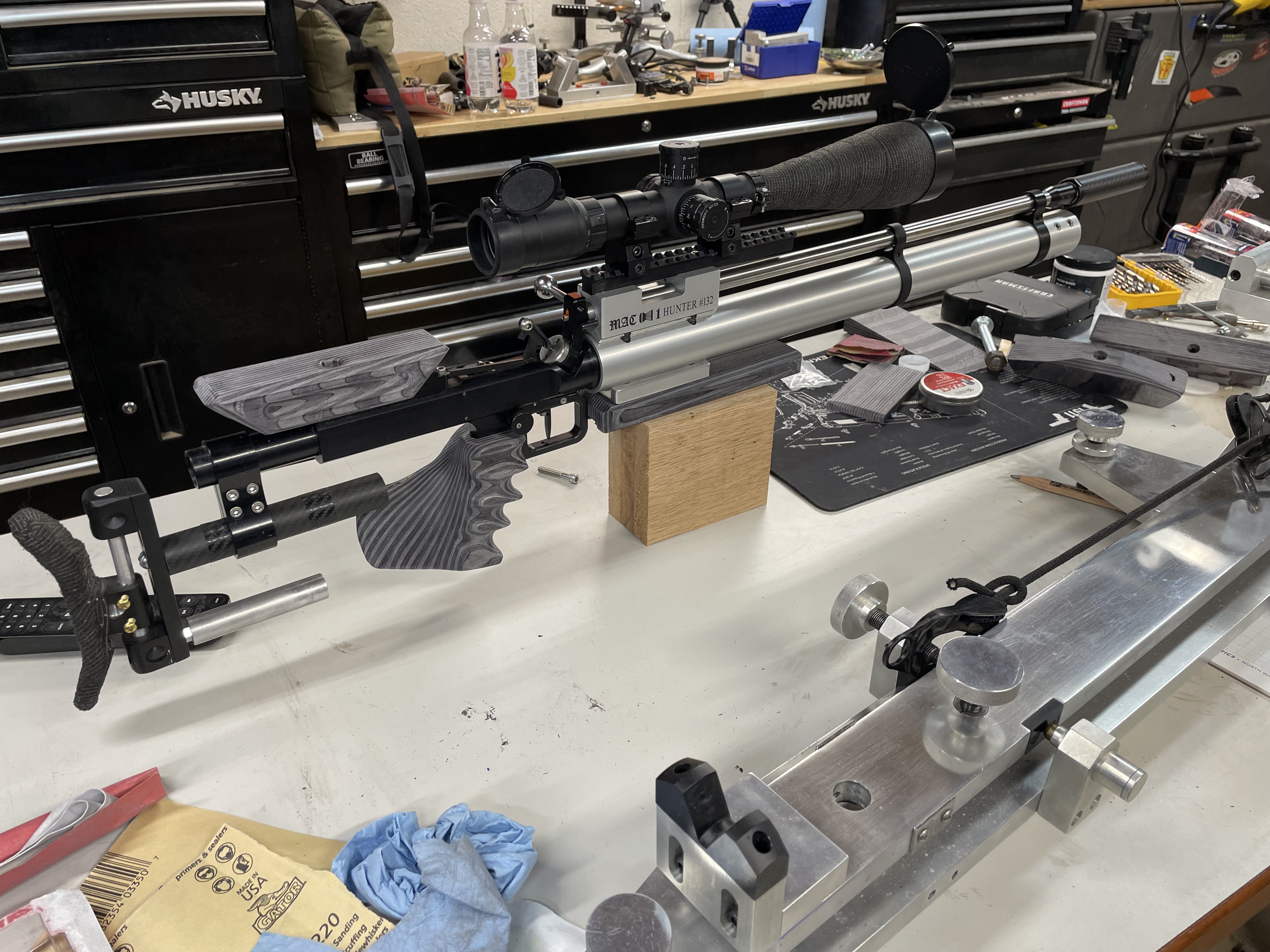

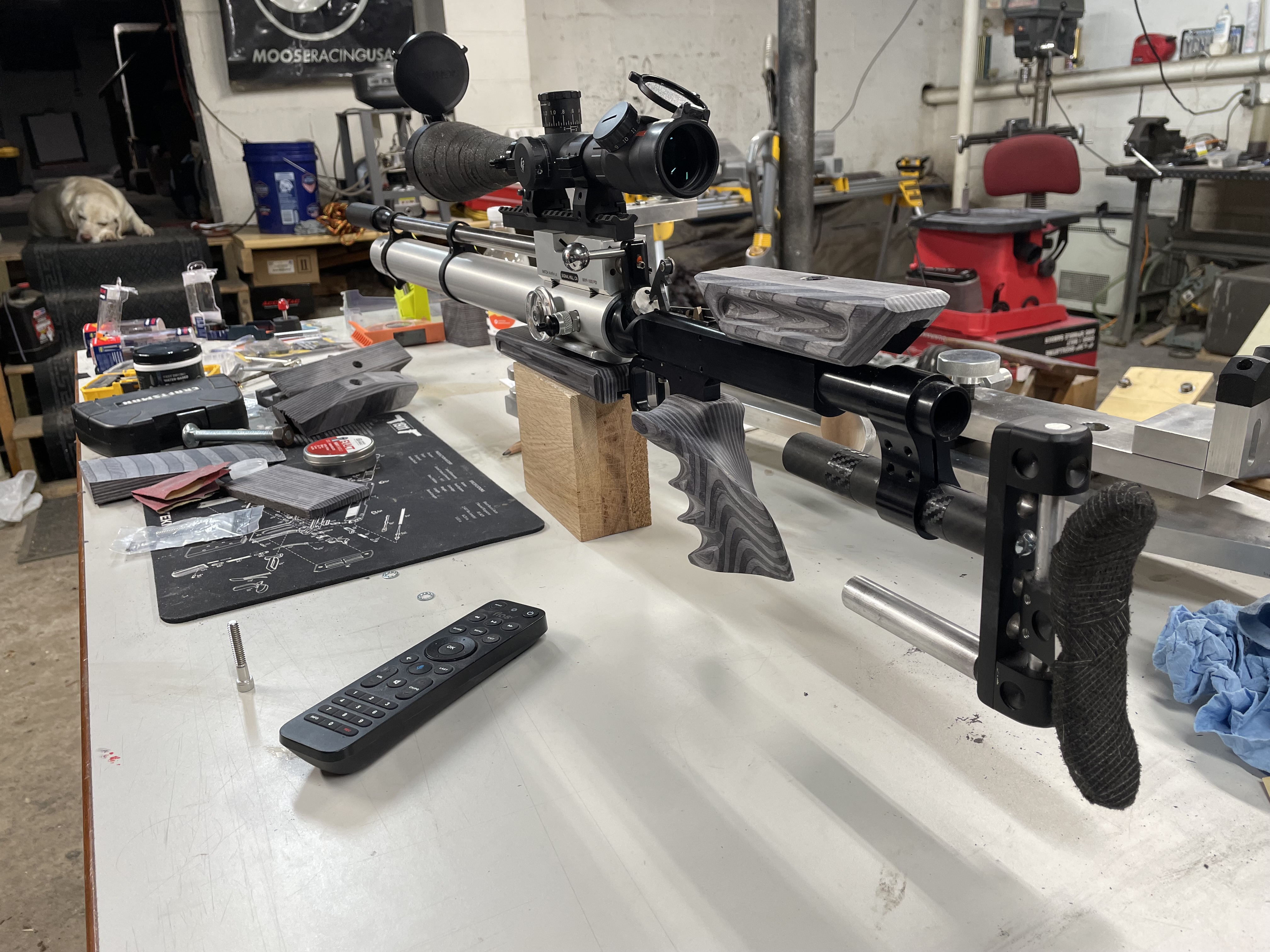

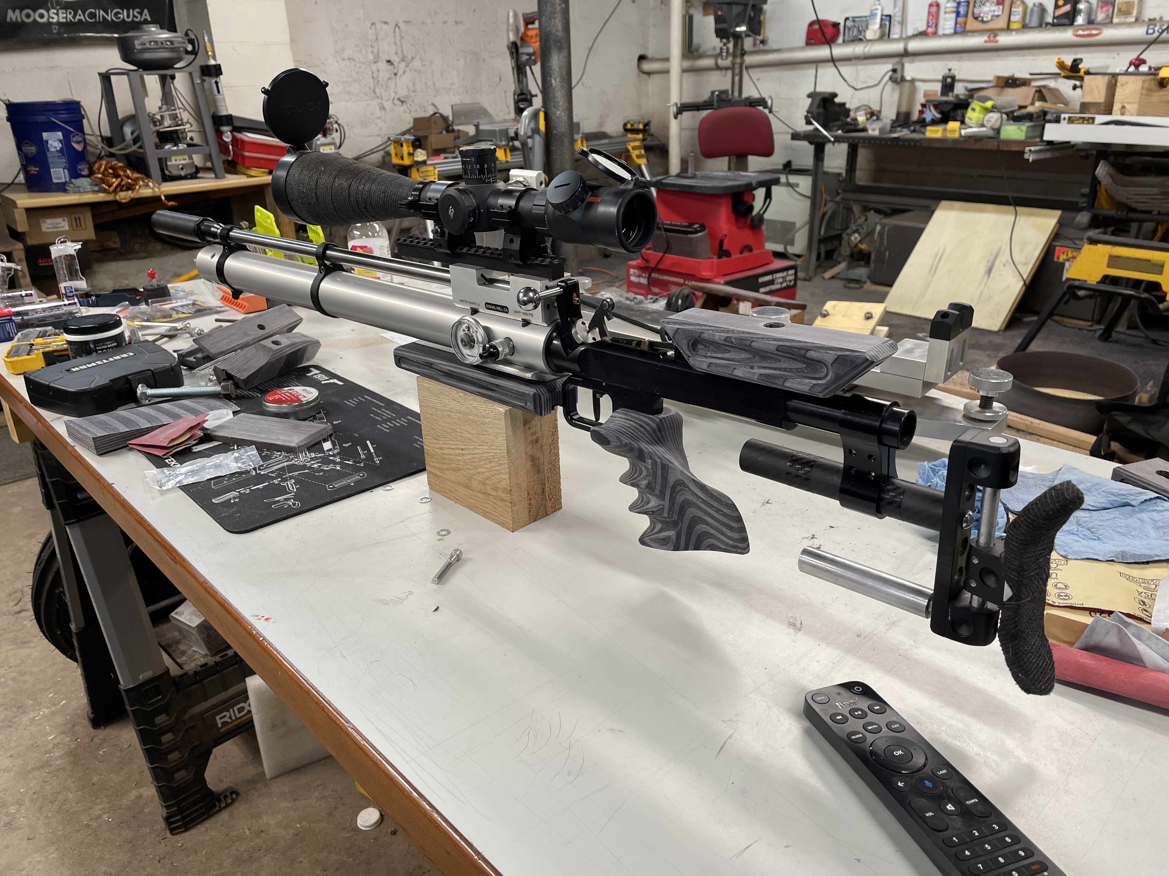

Finally got around to making new furniture for the Mac. Ironically the piece I struggled with the most was the cheek piece. Im still not sure that I am 100% happy with how this one turned out, but I’m out of material. The grip I got on the first try, thanks to YouTube. Not sure if was a good idea or not but I made the finger groves as deep as I could and the thumb shelf worked out well also. The forend was pretty straight forward. I just tried to get fancy and cut the block at different angles as to try and get more action for the wood grain. I did the same angle with the cheek piece. Overall I am pleased with the results. I am open to any suggestions for the cheek piece.

The converter is actually a 16mm adaptor that i bought from Donny FL. It fit right on and works great. I put a link down below. As far as the air stripper you currently have, I’m sure that it’s solidly glued on. When I was in the process of getting my gun, I talked with Tim about getting one of his air strippers. He made it known that it wouldn’t be something that you would just take on and off between say a moderator. That they were glued on and that it would/ could take a lot of heat to remove. If I recall the word torch may have came up. I could always look back in the text conversation to be sure. He essentially talked me out of getting one. If I were you I would start with a heat gun.
And the award for Best Looking USFT goes to...@oaks1450!!!!
Wowza. GREAT job. You selling USFT furniture now? Kidding....kinda.
Thank you very much! I appreciate your comment. And honestly it wouldn’t be out of the question, especially now that I have the cheek weld kind out sorted out. The forend is not that hard and the grip is just plain fun! lol.
Maybe look into Tyroleon stocks to see if you can create a similar cheek cup. Aesthetics might be challenging, with the modern, angular approach you took, but the finger grooves have the curved, elegant approach.
And just to be clear, I like the overall modern, angular look of the general design of your cheek piece.
