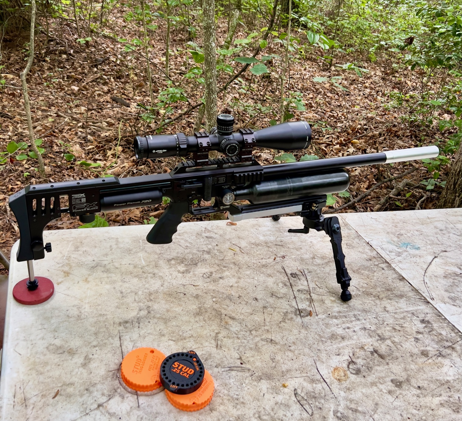

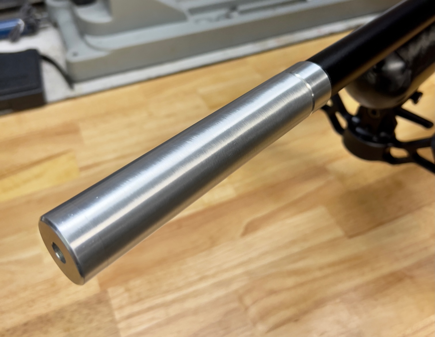

I made a new moderator for my MK 3 today....it definitely made a difference in the sound level compared to the FX one that came with it. I machined it out of aluminum and machined aluminum K baffles for it. I just got done testing it out on my woods range this evening and it was working very well until it started pouring rain and I had to quit...lol

Nice and todays question is, how well does it work?
It works very well in my opinion.....I don't own a decibel meter but to my ears it's a big difference in sound level compared to the FX Donny FL that came with the gun. I made one for my Gauntlet 2 when I first got it and that one worked just as well. I made this one a little longer than the one on the Gauntlet and also added a blast baffle that I came up with and it made it a little quieter. There is definitely no clipping with it as I was shooting some nice one hole groups at 50 yards...:)

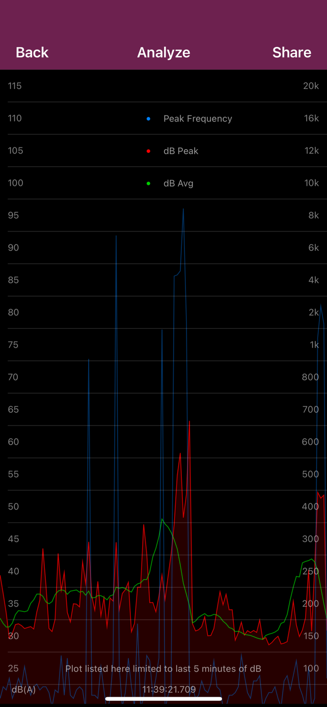

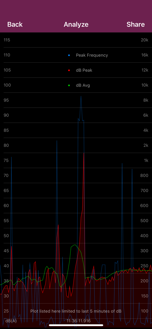

I downloaded the Decibel app to my phone last night and tested the factory Donny FL moderator and the moderator that I made on my MK3 this morning. I set my phone approx. 3 ft. to the right, level with the muzzle of the gun on a tripod. This is just a simple test I did.... I'm not trying to prove nothing to anyone, I was just curious of what the difference was between the one I made to the Donny FL.
This is the Donny FL
This is mine
Impressive 34db reduction.
I prefer the look of a moderator that closely shares the barrel's diameter.
Will you anodize it to match the gun?
I used to do anodizing, I had a full set up in my shop and I ended up getting rid of all of it.....the hobby shop type anodizing is not good for your health. it entails using acid and having the problem of acid fumes requires very expensive air filtration systems. I just quit doing it....I will probably just spray paint it...LOL
