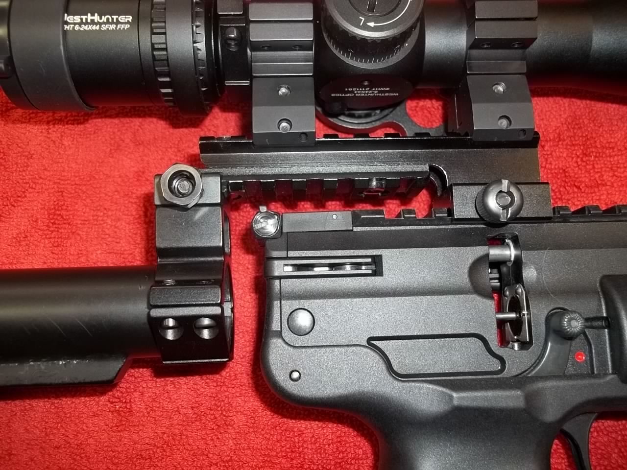

Going thru my parts yesterday decided to see if my HW 44 butt stock idea would work. Parts of adapter consist of
#1- Weaver scope extension 1/2" high riser base adapter,(tried low profile base it had to much
flexibility),
#2-
Screwed inverted piece of picatinny rail to bottom of extension.
#3- 30mm scope ring high placed on buffer tube inverted (fit tube perfect)
#4- AR style buffer tube and butt stock.
It all works great. Scope/ Dot eye window height can be adjusted by using different height scope rings on buffer tube and on scope.
I ordered these pic rail covers , to use with the pic rail riser, to put under the bottom of the air tube, for a front support surface

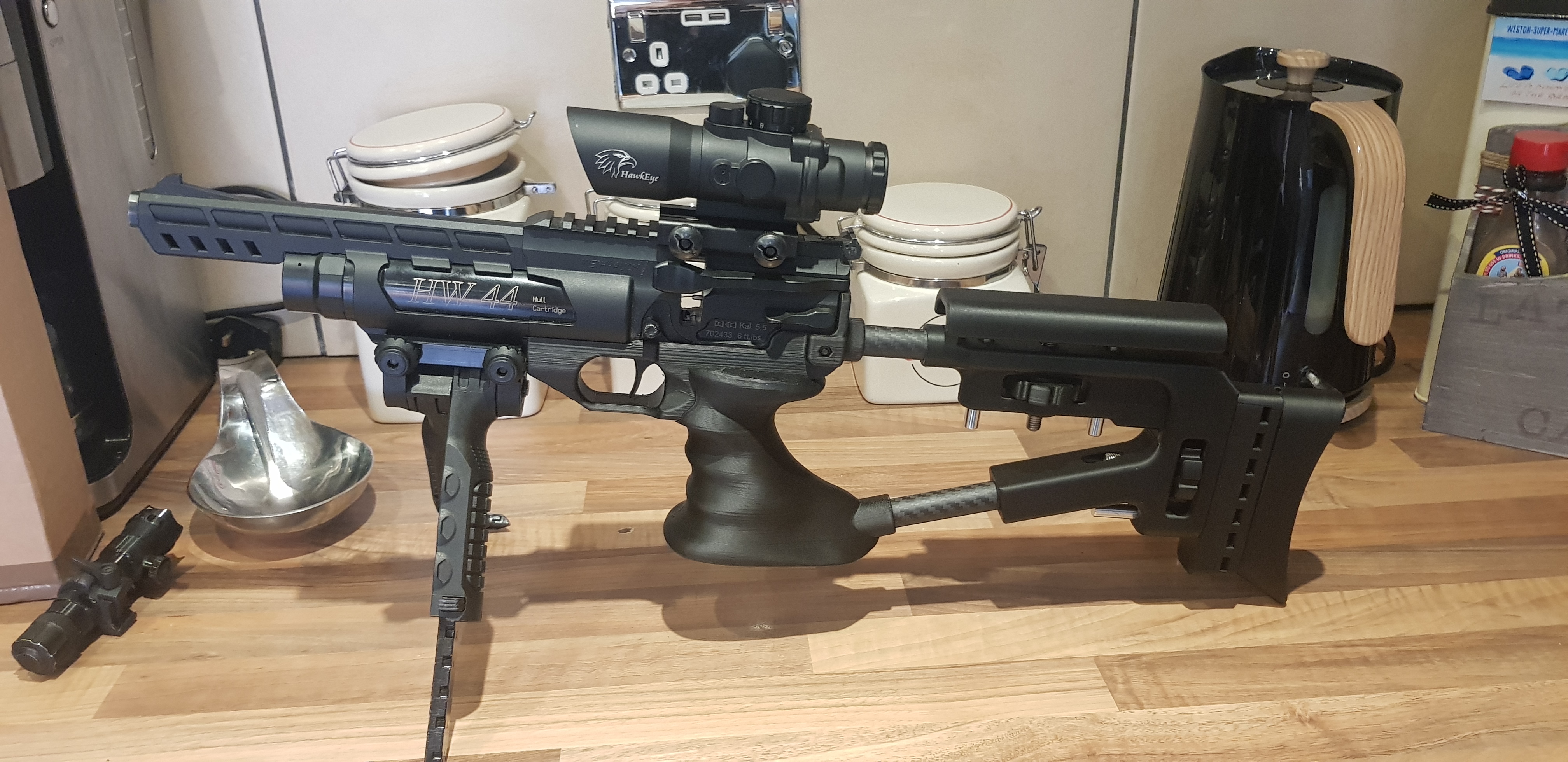

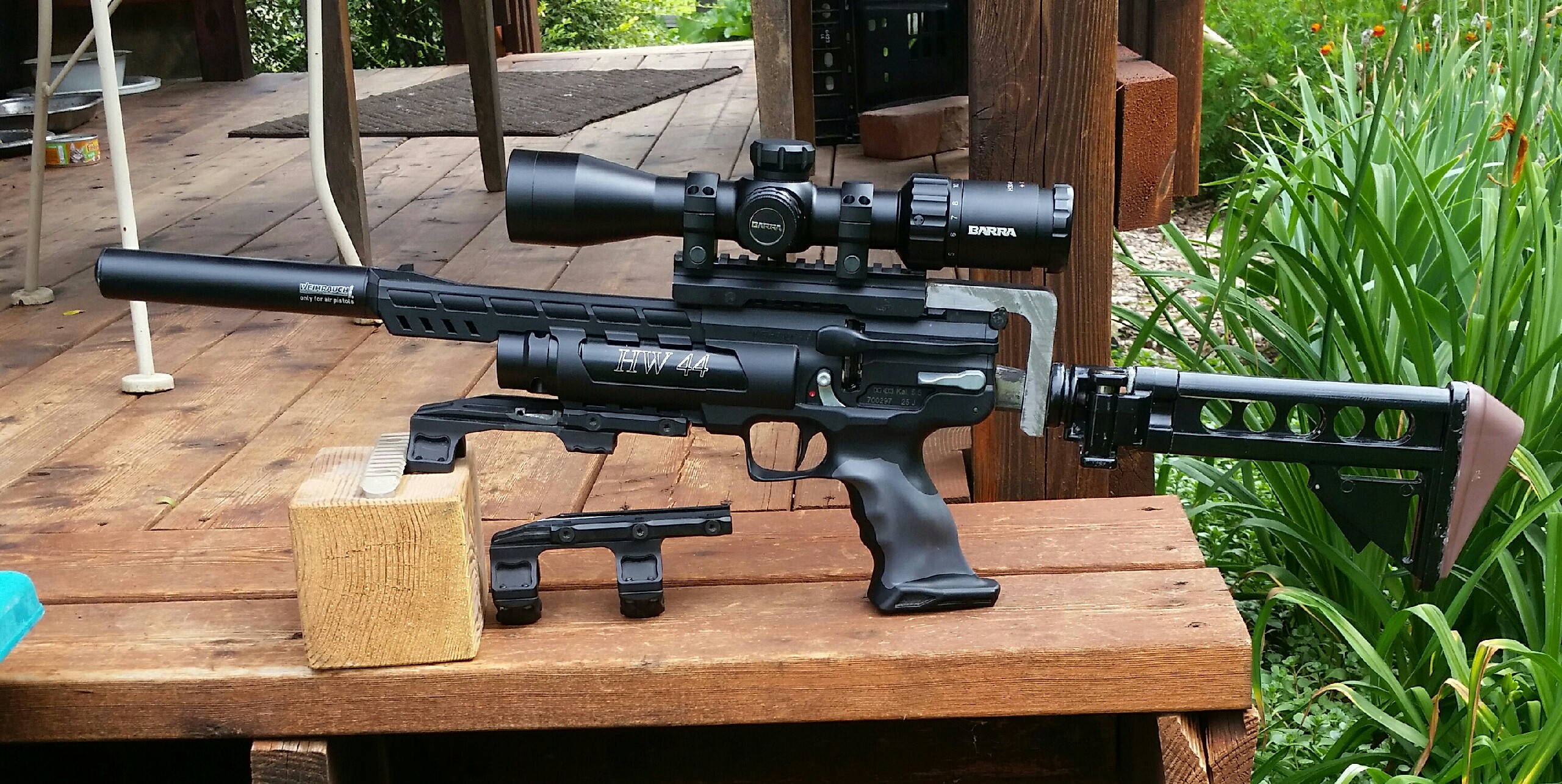

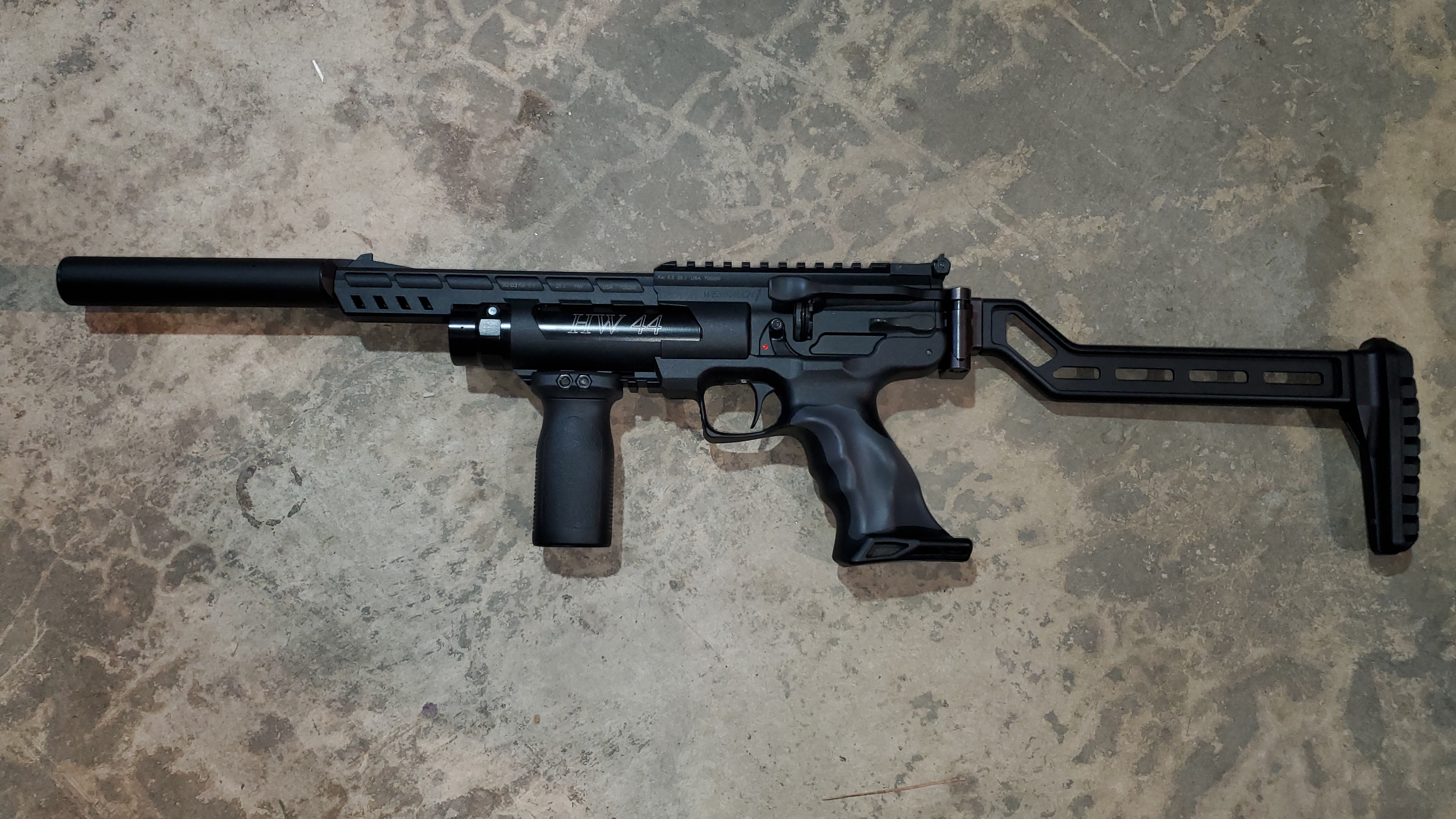

I chose the easier option 3d printed stock by bob p.

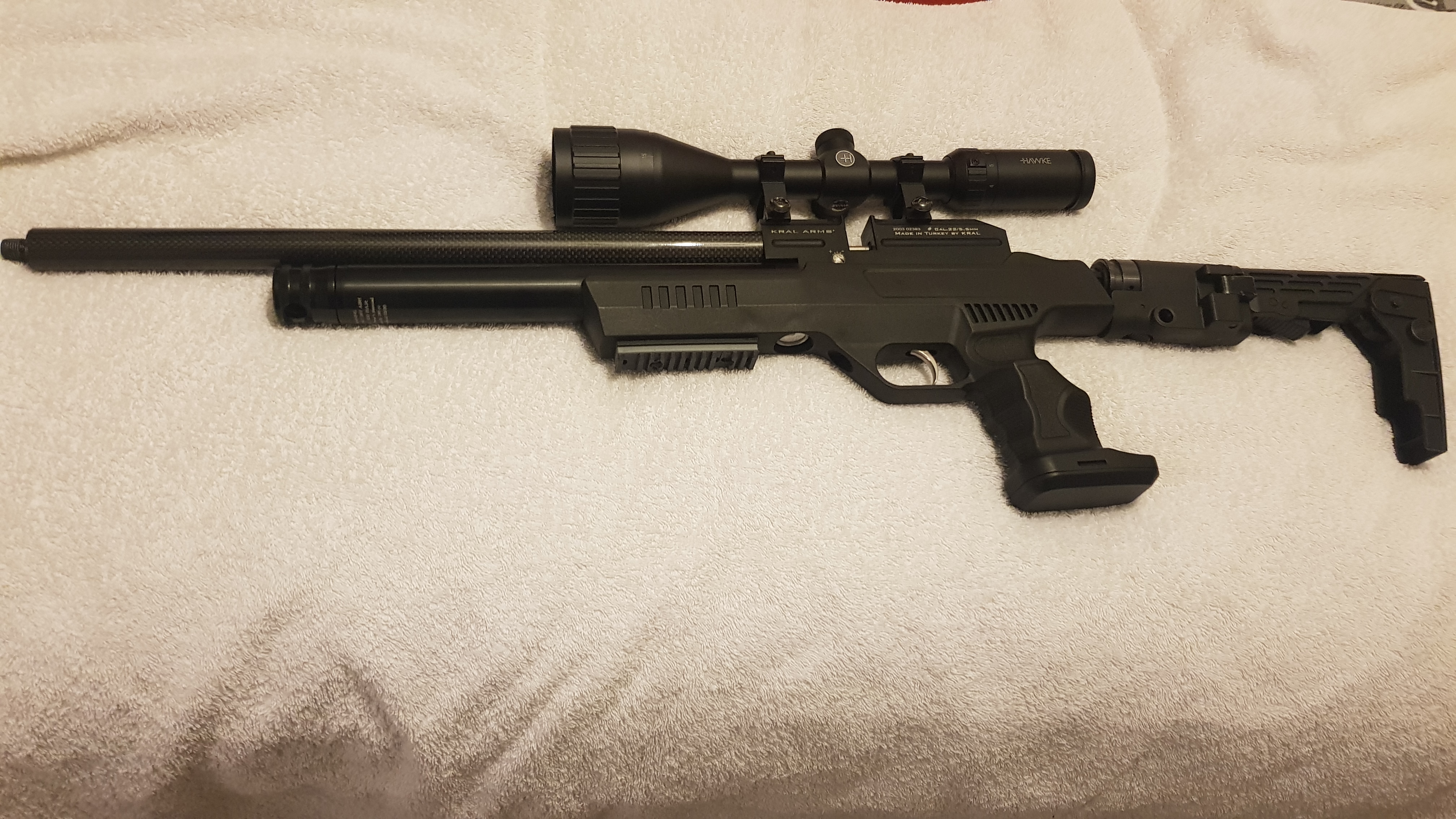

But I did put a folding stock on my kral np03 if that counts.
You cant fault the hw44 in any department it is a great pistol.
I'd love one of Bob P's stocks and even his single shot loader, unfortunately he won't sell to anyone out of the country.
I even asked a UK business partner to contact him on my behalf and he never responded.
I also tried to purchase a bob p stock from England, but no way was found, so I bit the bullet and ordered the Rinks stock, paid my money and waited the many months. Mean while I went with the Frankie stock to let me play till the Rinks arrived.

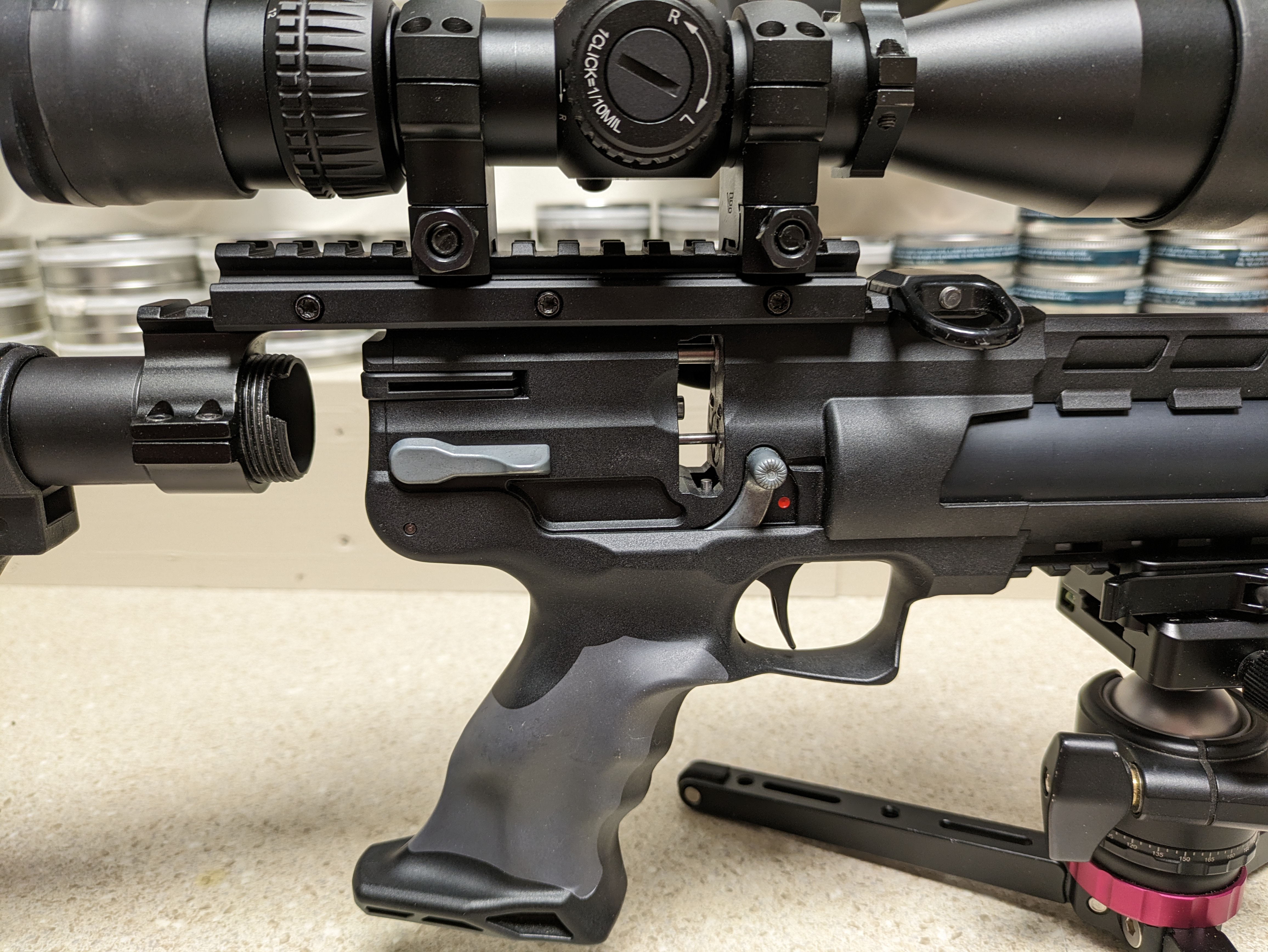

flexibility),
#2-

Brilliant creativity! If I can't find a way to attach my stock closer to the gun, I will go this route. Thanks!

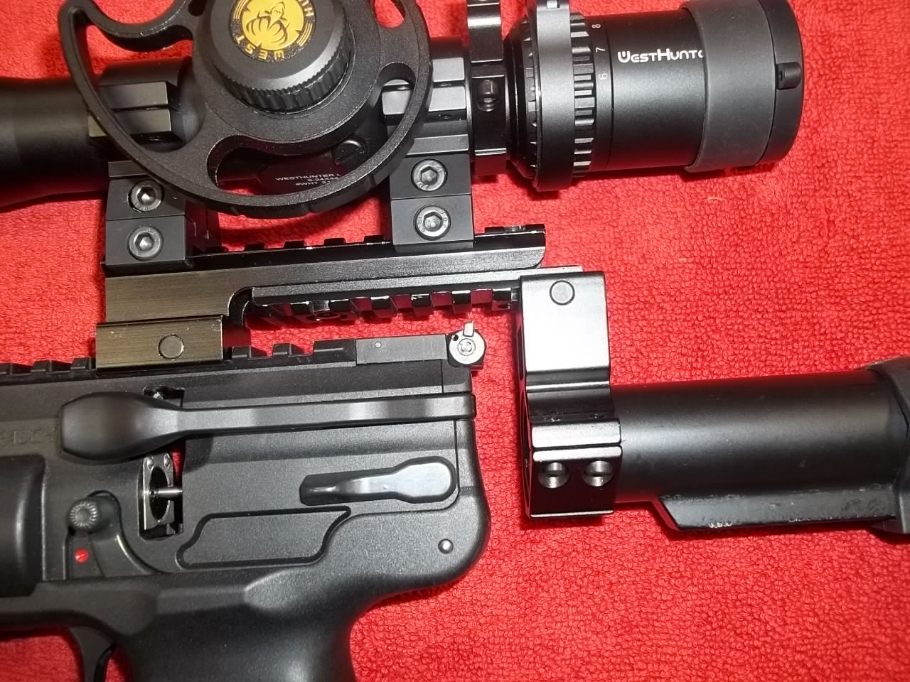

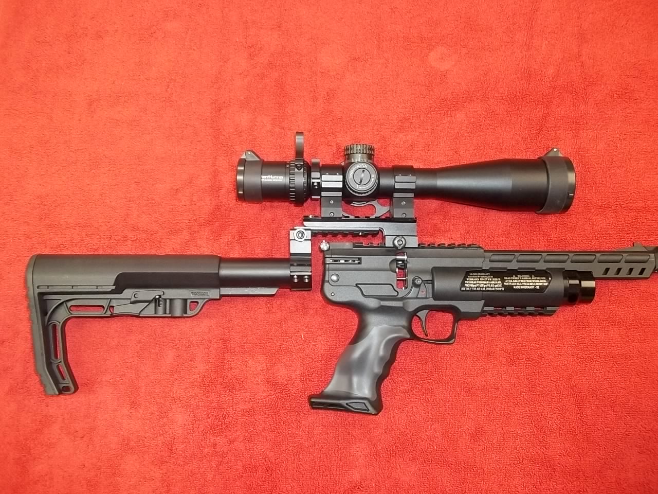

Here is a mock-up of what I am trying to achieve:
Leon's idea was brilliant! Here's a slightly different method to his version. It works great. Like Leon, I already had everything on hand. I had to remove the rear sight, but it makes for a very solid mount. Since this picture was taken I've trimmed off the exposed threads and plugged the buffer tube just to dress it up a bit.
