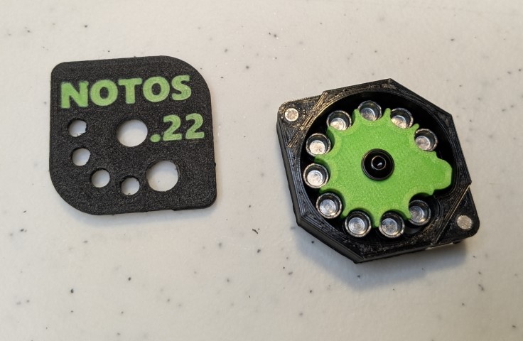

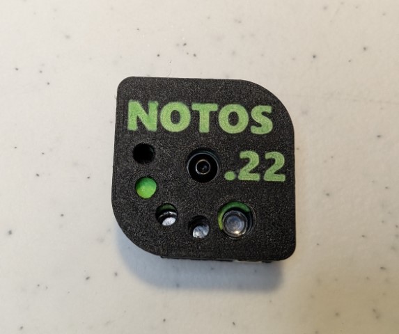

Fist of all, I know that there are plenty of good aftermarket Notos Magazines (Carm, Maple, etc.). Partly I just like the challenge and the fun of trying new things. I designed a Avenger magazine previously, but made this one a bit differently. So for, it is working well, but I think I have a few small adjustments I will make.
- 10 rounds
- removable lid (attached by magnets)
- shot indicator for the last 4 rounds (although the last one is hidden when in the gun)
- I inlayed the text by printing a 2 layer STL of just the text, then switching filament and printing the rest around it (first time I tried that technique, and it worked very nicely)
- it doesn't have the ridge on the back, making it easier to print, but it still locates just fine (and take less fumbling to get lined up).

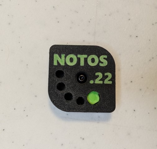

Okay, I think I did the last change. None could probably tell a different except me, but I added a 0.2mm ridge on the bottom that sits on the right edge of the magazine well. That removed a very slight potential to tilt (up an down) at tiny amount, pivoting where the magnet is. Now its very stable and holds the exact correct position. I shot about 150 pellets using the last version, and it worked flawlessly.

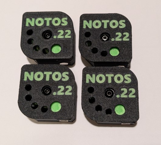

Very cool, I like the shot indicator! I also like your manual-multi-filament solution, I'll have to give that a try.
This is the first time I tried doing the "manual-multi-filament" (I like your name for it :cool: ). I have to say, its the thing that made me the giddiest while 3D printing in a long time. I can't believe how well it worked. Here are my last 4 prints:
The only thing that wasn't exactly how I would want it was that for some reason PrusaSlicer doesn't seem to do the travel z-lift on the first layer (not sure why).

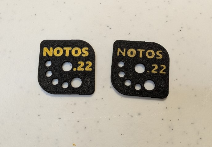

I tried out the slightly less "manual-multi-filament" technique. You essentially tell your slices that you have a dual filament capable machine, and have it pause when switch between the colors (and then you do the manual filament change). This way, you could put the color anywhere in the print (not just the first layer), but you have to do a filament change at each layer that has multiple colors. That could get tedious very fast. The process worked exactly as I expected, but the result was not as good:
The lid on the left is what I was doing (print the two layer of the lettering as a stand alone print, then run the next print over the top of it). I am pretty sure the difference came from the fact that the second method prints the black (non-lettering) first. It probably flattens out a bit into the space the lettering the later printed into. I didn't find a way to control the order the colors are printed in the new method. The result from the manual method is nicer, even if it sometimes drags the nozzle across the already printed letter sometimes (for some reason PrusaSlicer doesn't do the travel lift on the first layer).
