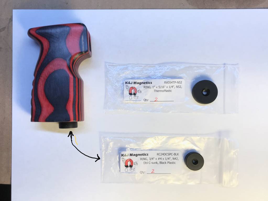

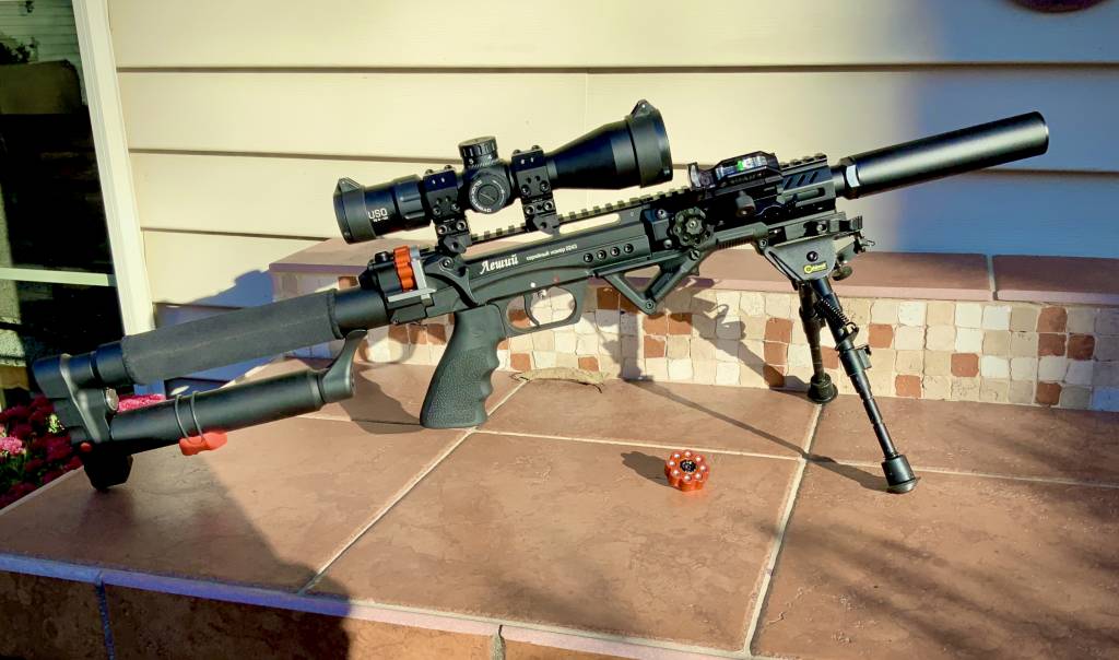

Thought I would put out what I have found in magnets that can be mounted easily on the LESHIY 2. K & J magnets .com sells magnets by the piece and have a lot of different options to pick from depending on what you need. I didn’t want a shiny silver magnet on the all black gun so I found they have plastic and rubber covered Ring magnets but they are only available in 1/4” thicknesses. You can see on my gun with the Sho Pot forearm I have mounted a 1” plastic covered one in the M-Loc slot . It’s pretty powerful and the dull black finish blends right in with the rest of the gun. The button head screw tightens and is recessed down into the hole so it is flat . You will need an m-loc nut for this which you can by a pack of screws and nuts on Amazon. . I also got some with the rubber coating but they were only available with 5/16” hole. I plan on mounting these in a way that it will do double duty and become my magazine holder and also will take the cover off. This will be mounted on the scope rail Using a 90 degree modified picatinny mount. I am doing this for two reasons, one I plan on running a carbon fiber bottle and two, I like the Mag Pul forearm on the rail all the way back so that eliminates useing the red plastic magazine holders that came with the gun. For those who will be running their gun with the standard moderator and grip , K&J magnets have magnets with recessed holes in them that make a clean mount on the bottom of the grip with a screw. I would stick to the 1/4” thickness for the stronger power magnet.
