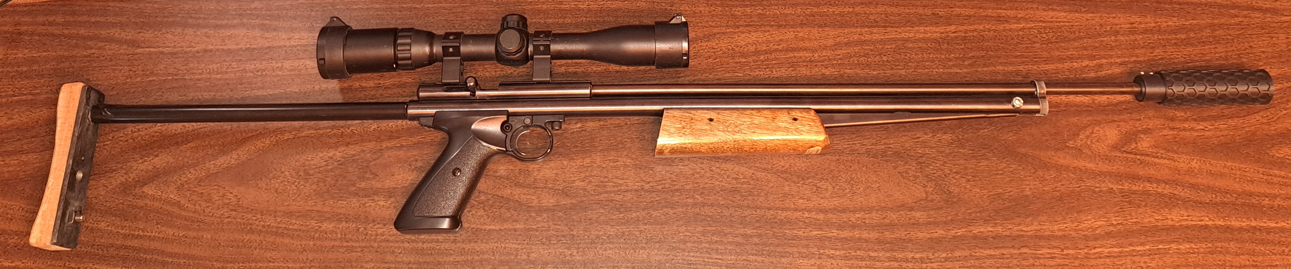

When I hear magnum pumper I think hunting, using that much fpe on paper may not be worth it. I have, and will continue to go down that rabbit hole of msp and power. The biggest problem I see is valve volume in pumpers. I once moded a 392 to shoot 15.49 at 740 fps at 12 pumps all done by increased volume, added internal valve mods, and some spring work. In all honesty, if it's not robust than things will start to break or wear out. The closest I've gotten to a magnum pumper is a 14xx build that will launch .177 over 1000fps in 12 pumps, hits 17ftlbs and stacks pellets at 25 yards (haven't taken it further than that yet or pumped it more than 12 times) to include is super light and quiet but not pretty as seen below. Built one in .25 too but haven't chrony it since adding some more performance mods and I'm sure it's in the 20fpe range in 10 pumps. Also stacks pellets at 25 yards.

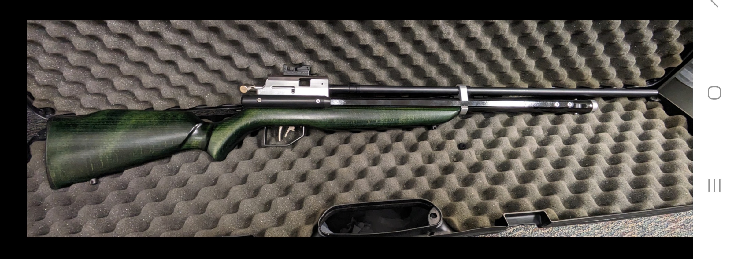

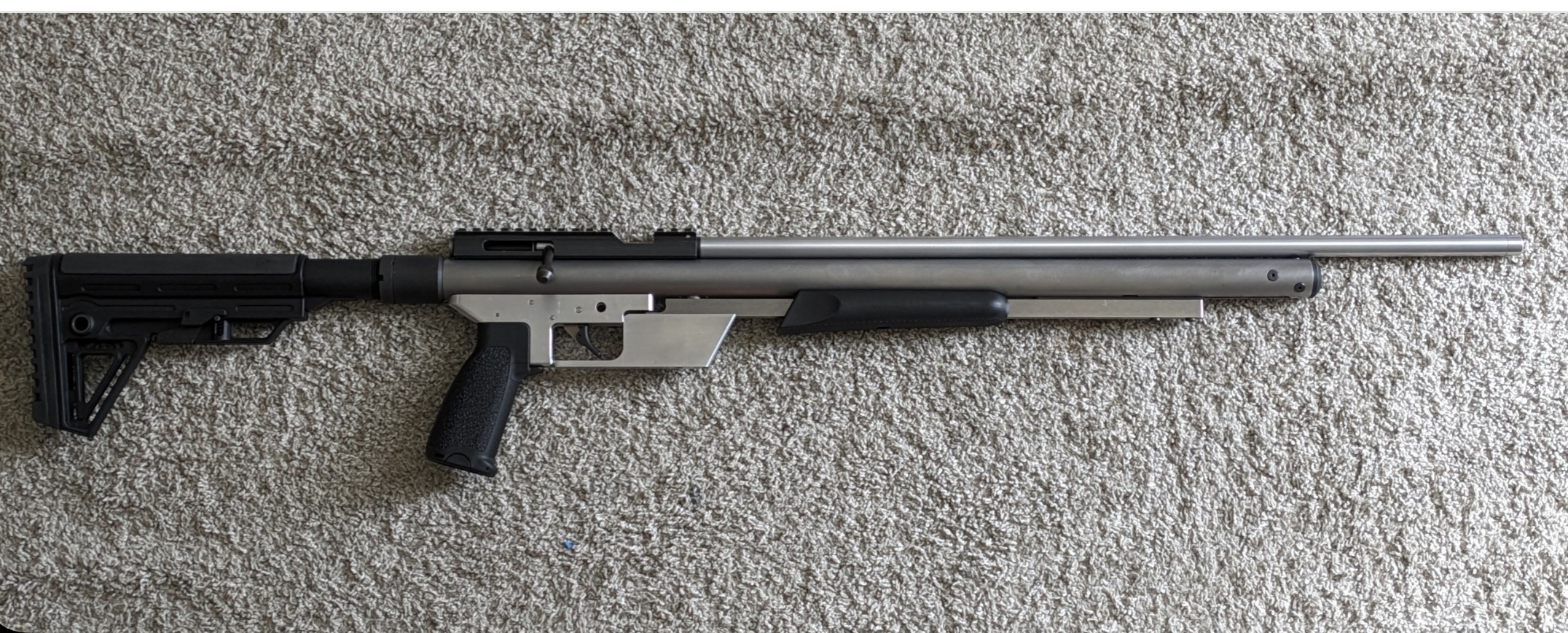

A member to another forum built some big power on a 357 build, but I don't see it going to market as it's all custom work.
One does 120fpe
And a carbine that does 75fpe
His work is amazing

When I hear magnum pumper I think hunting, using that much fpe on paper may not be worth it. I have, and will continue to go down that rabbit hole of msp and power. The biggest problem I see is valve volume in pumpers. I once moded a 392 to shoot 15.49 at 740 fps at 12 pumps all done by increased volume, added internal valve mods, and some spring work. In all honesty, if it's not robust than things will start to break or wear out. The closest I've gotten to a magnum pumper is a 14xx build that will launch .177 over 1000fps in 12 pumps, hits 17ftlbs and stacks pellets at 25 yards (haven't taken it further than that yet or pumped it more than 12 times) to include is super light and quiet but not pretty as seen below. Built one in .25 too but haven't chrony it since adding some more performance mods and I'm sure it's in the 20fpe range in 10 pumps. Also stacks pellets at 25 yards. View attachment 522598
One does 120fpe
His work is amazing
