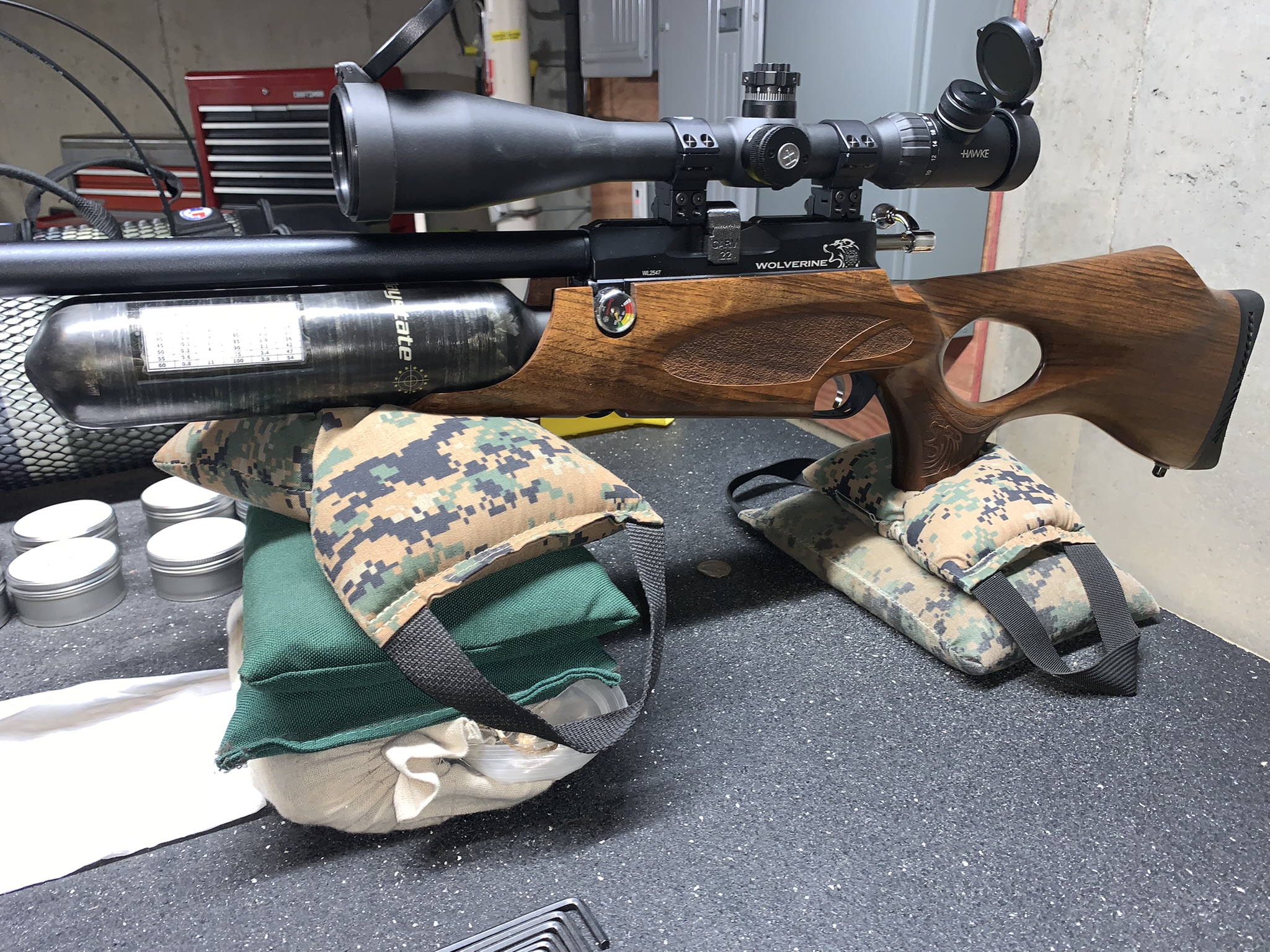

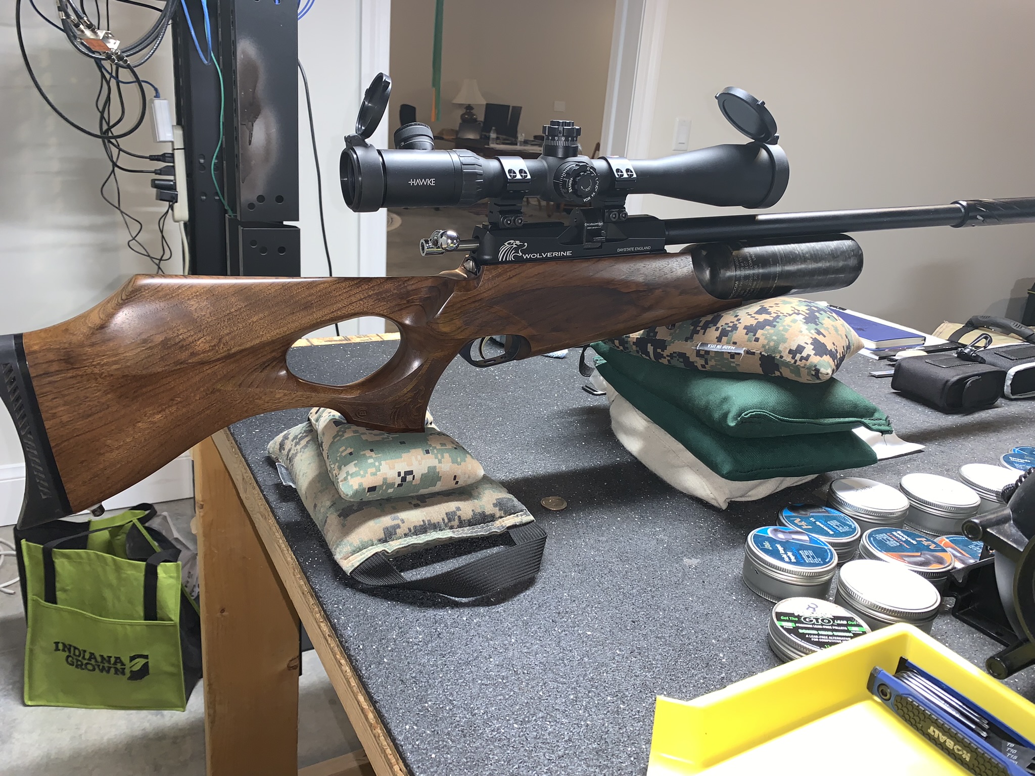

Next on my maintenance check list was a .22 Daystate Wolverine B HiLite (non regulated) rifle. As I haven't had it more than a couple of months, I didn't expect the need to do much. This rifle has one of my original Hawke AirMax SF 30 IR 6-24x50 scopes on it - probably close to fifteen years old, and it remains as dependable as the day I purchased it. Carefully tested at 5 yard intervals and entered into Strelok Pro, comparing the actual testing with the Stelok calcs, this rifle is set to shoot utilizing click adjustments and does so with ease.
The barrel was nearly spotlessly clean inside but I ran a couple of patches through it anyway. I setup my rifles with the maximum amount of elevation possible to achieve using SportsMatch vertically adjustable rings so I can get the maximum amount of click adjustments out of my scopes.
