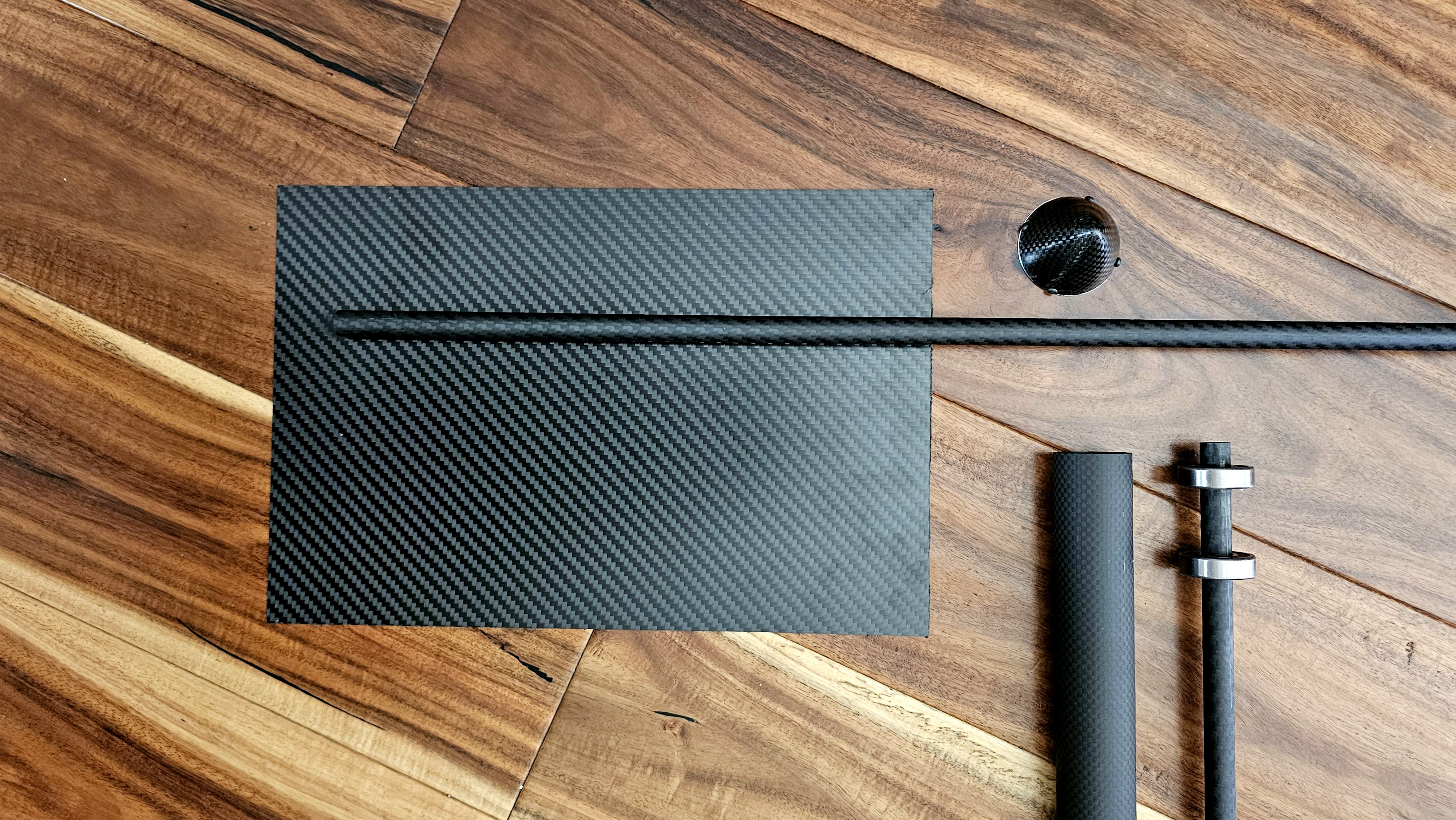

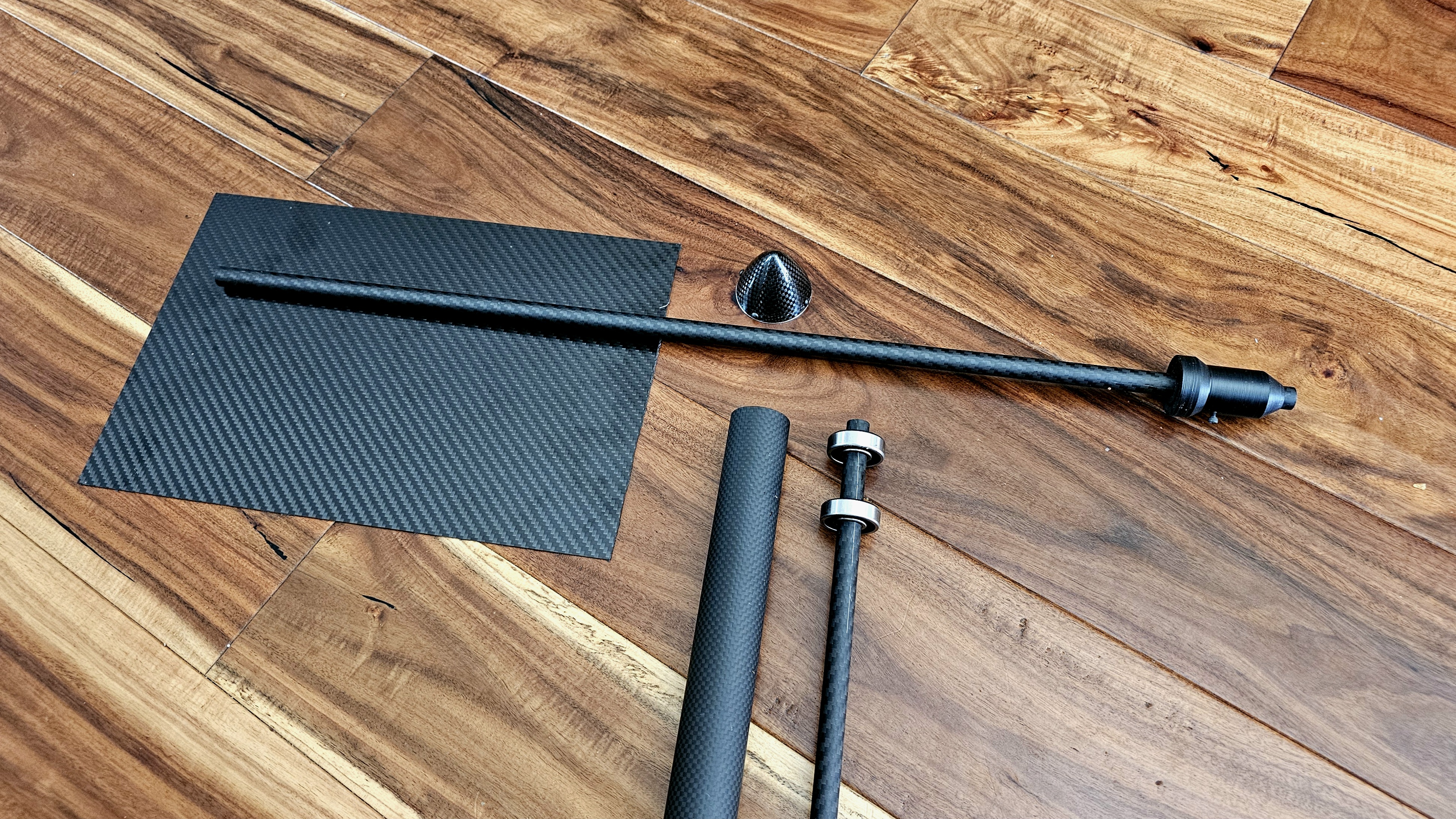

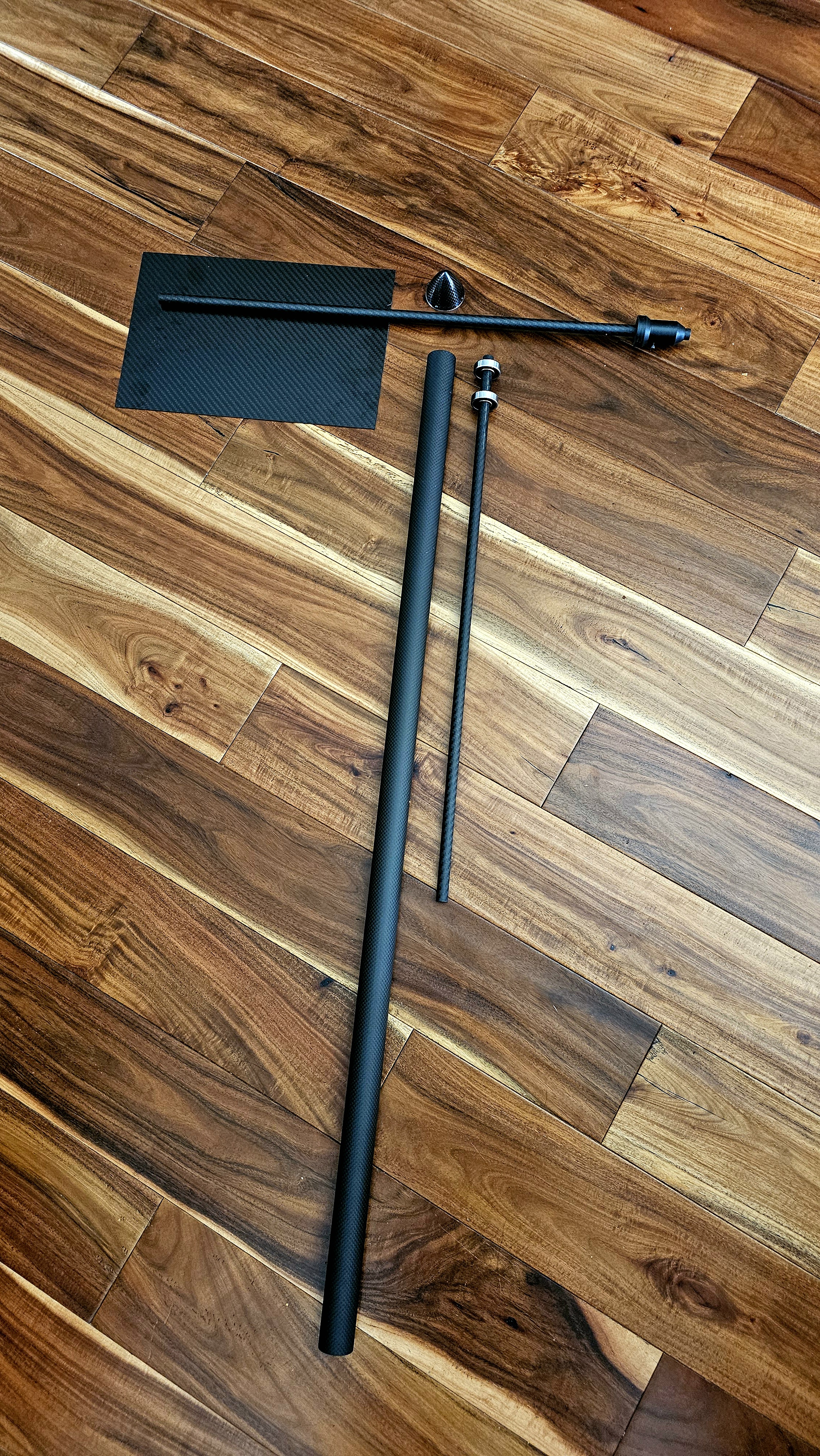

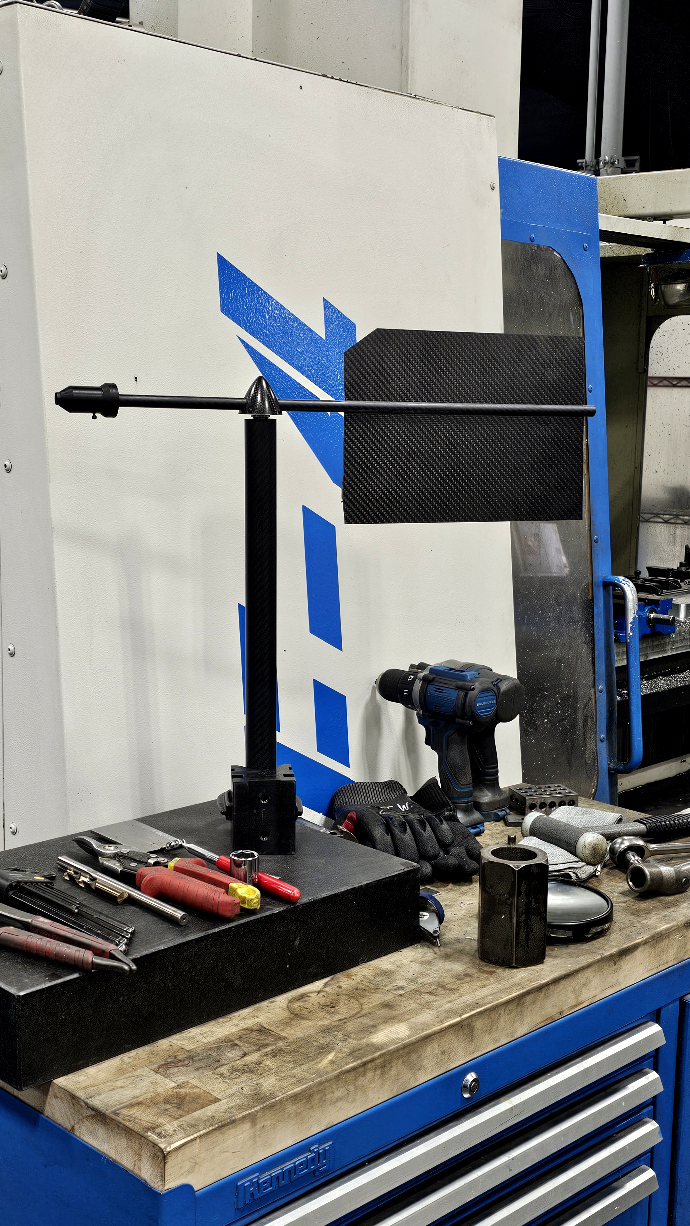

Starting on my next project. Some carbon fiber wind flags. Still waiting on a few more parts
Your's is going to be nicer than mine considering the components you are using.

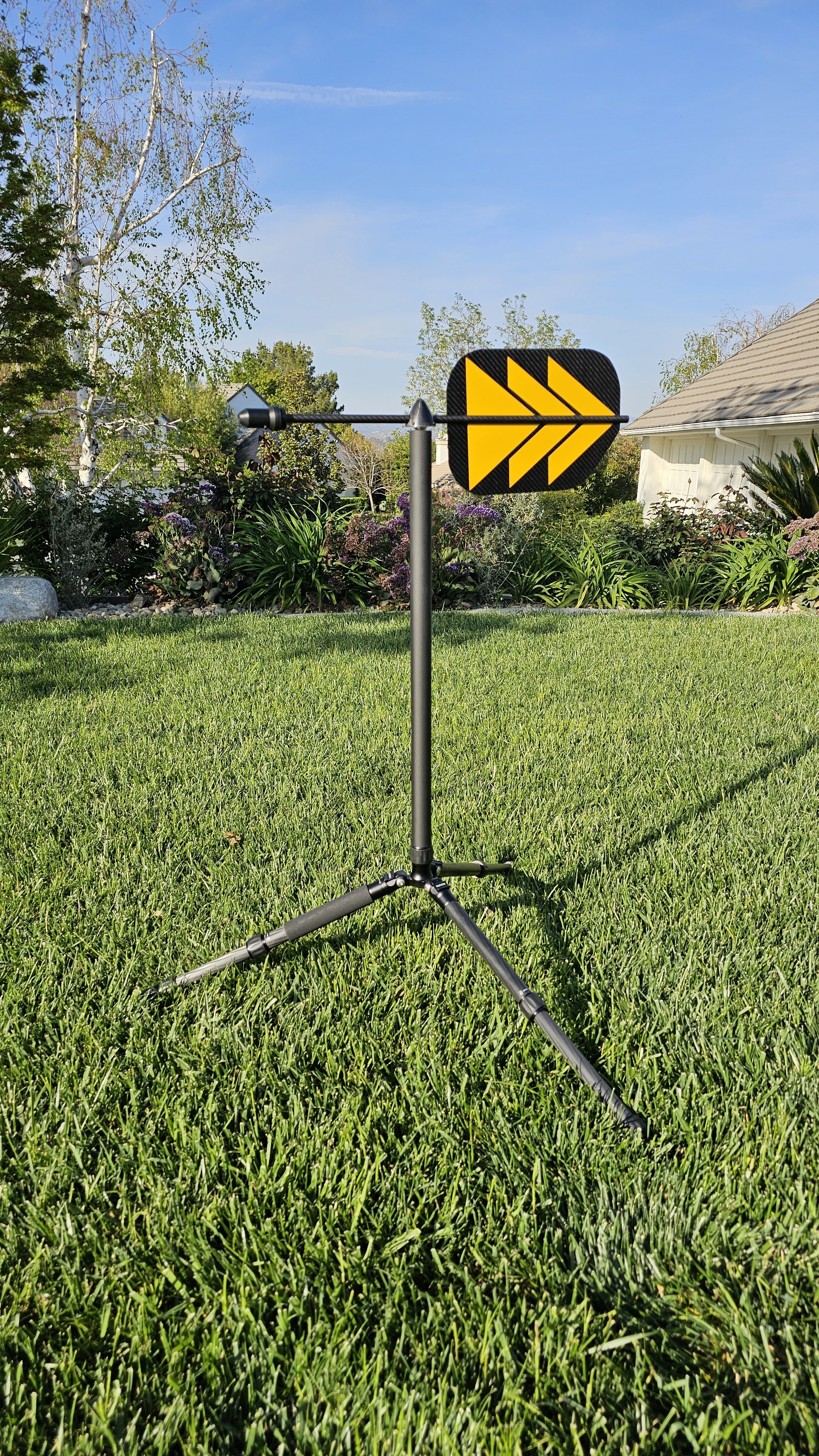

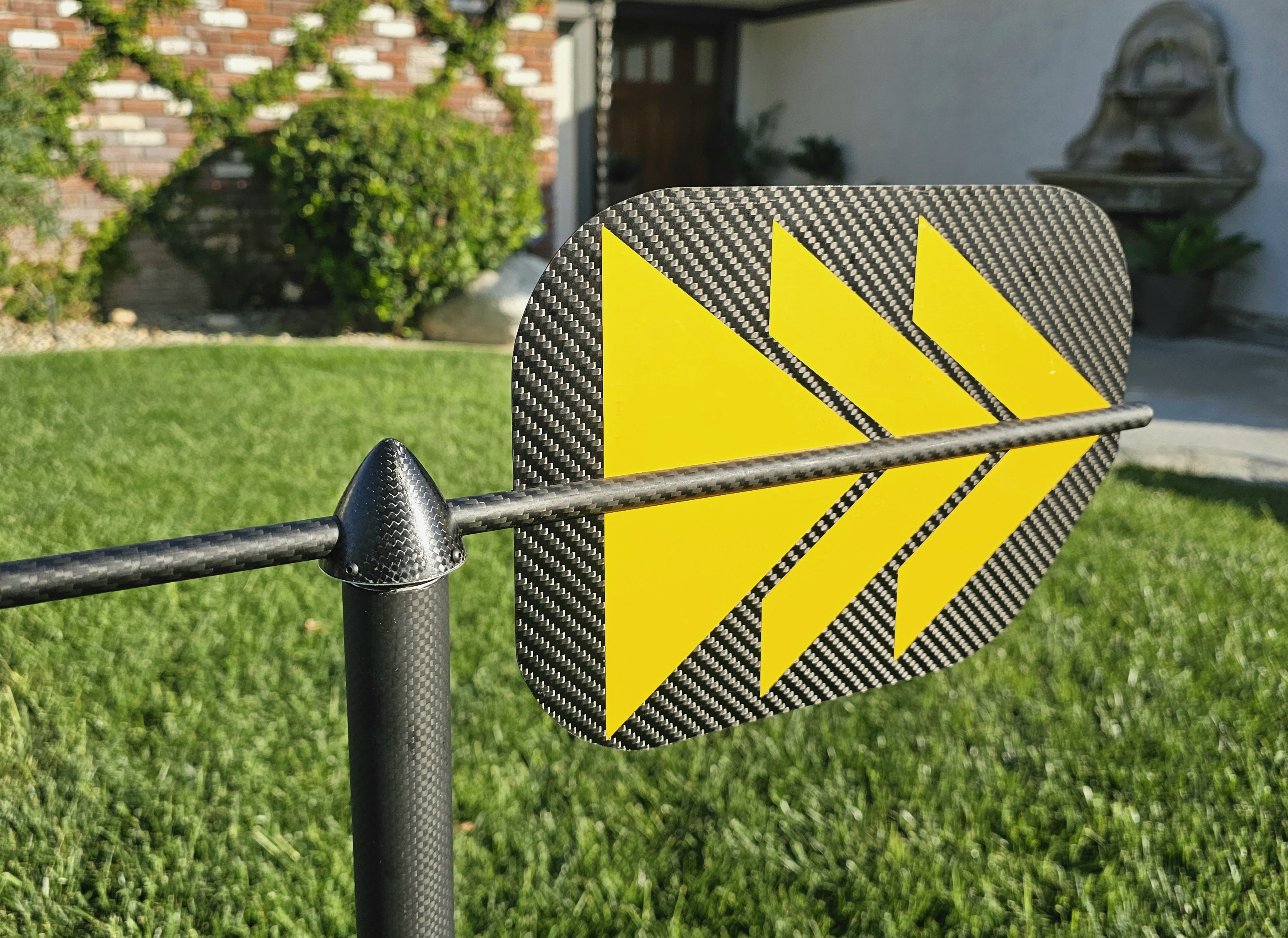

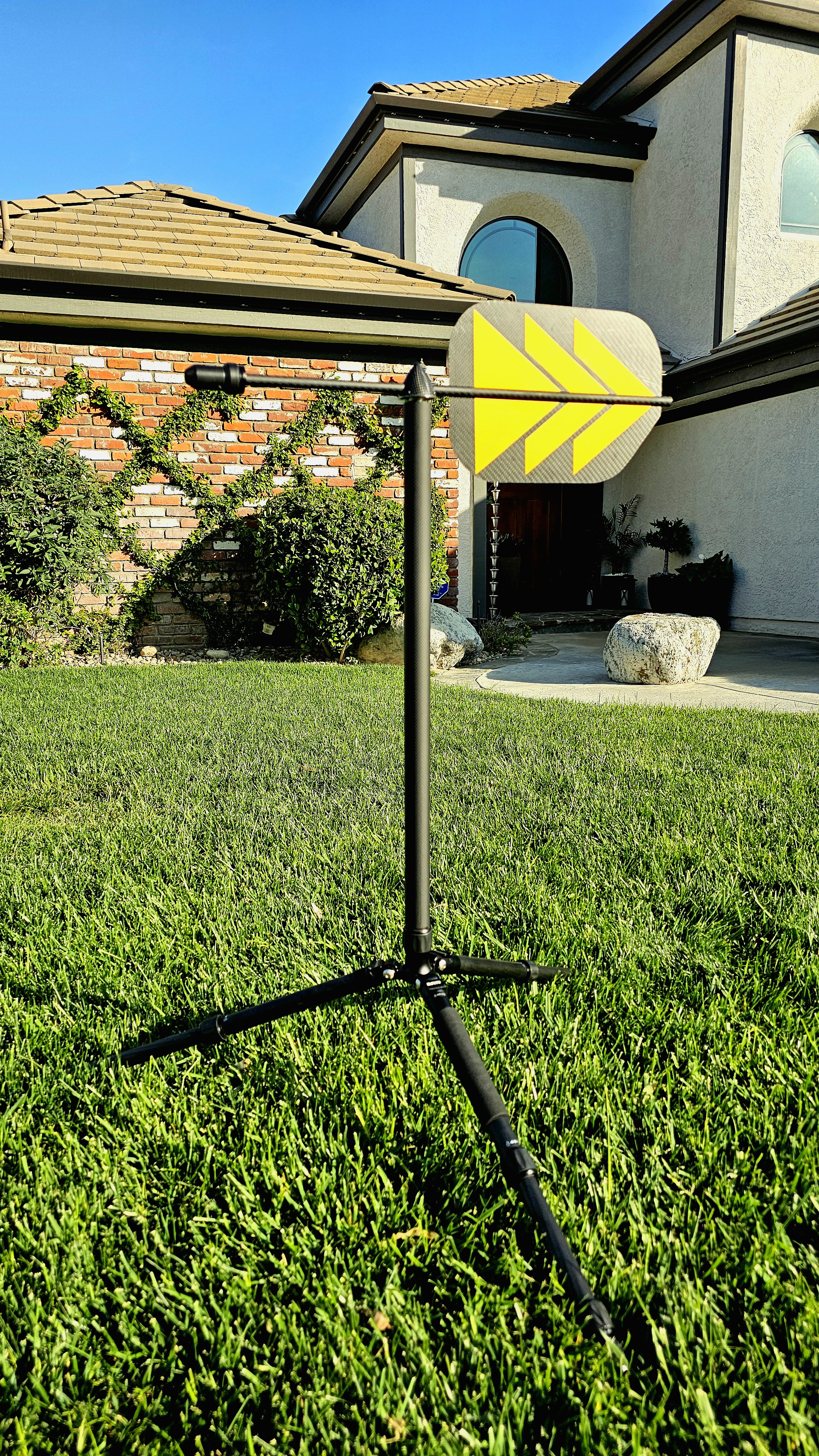

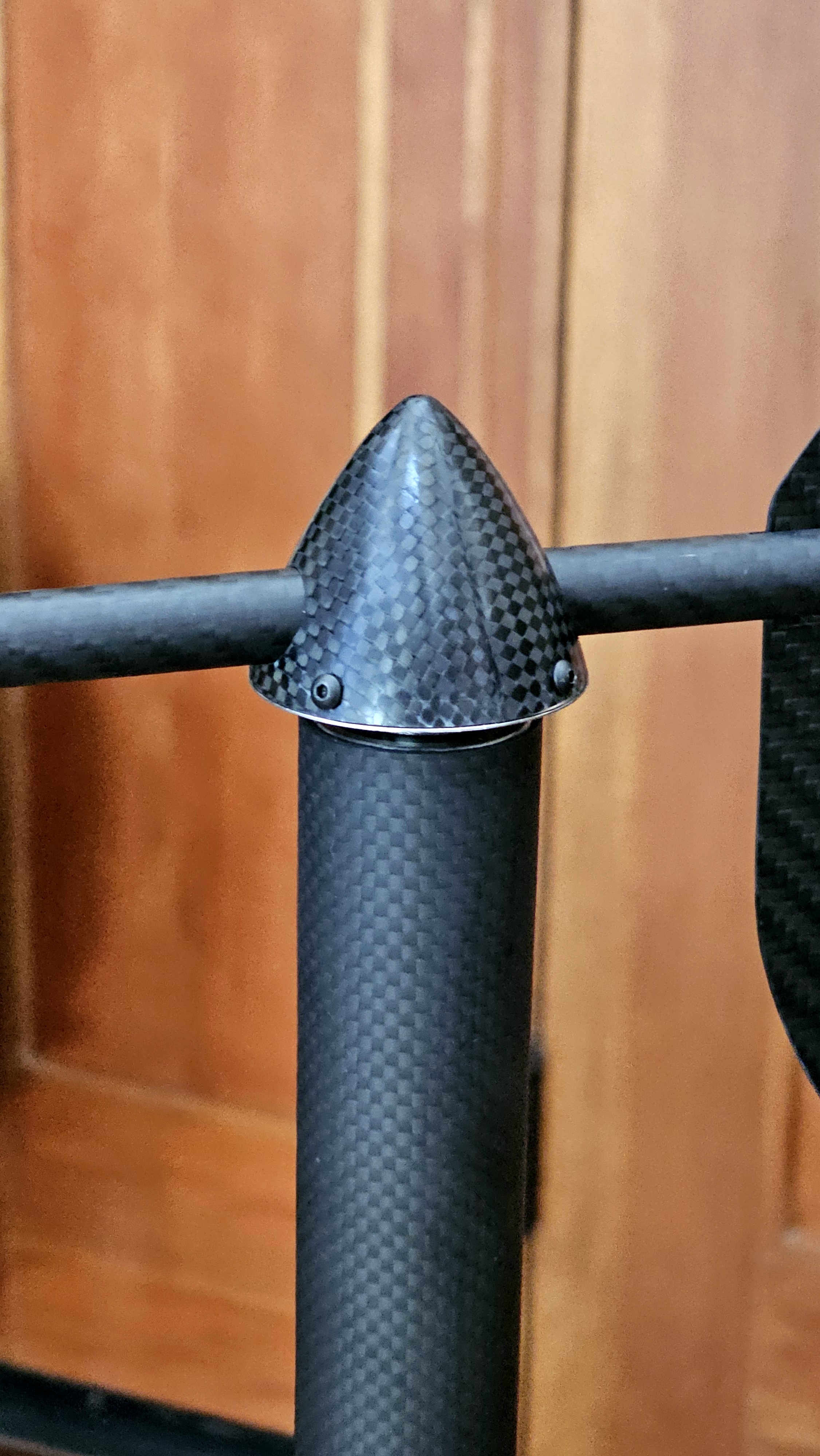

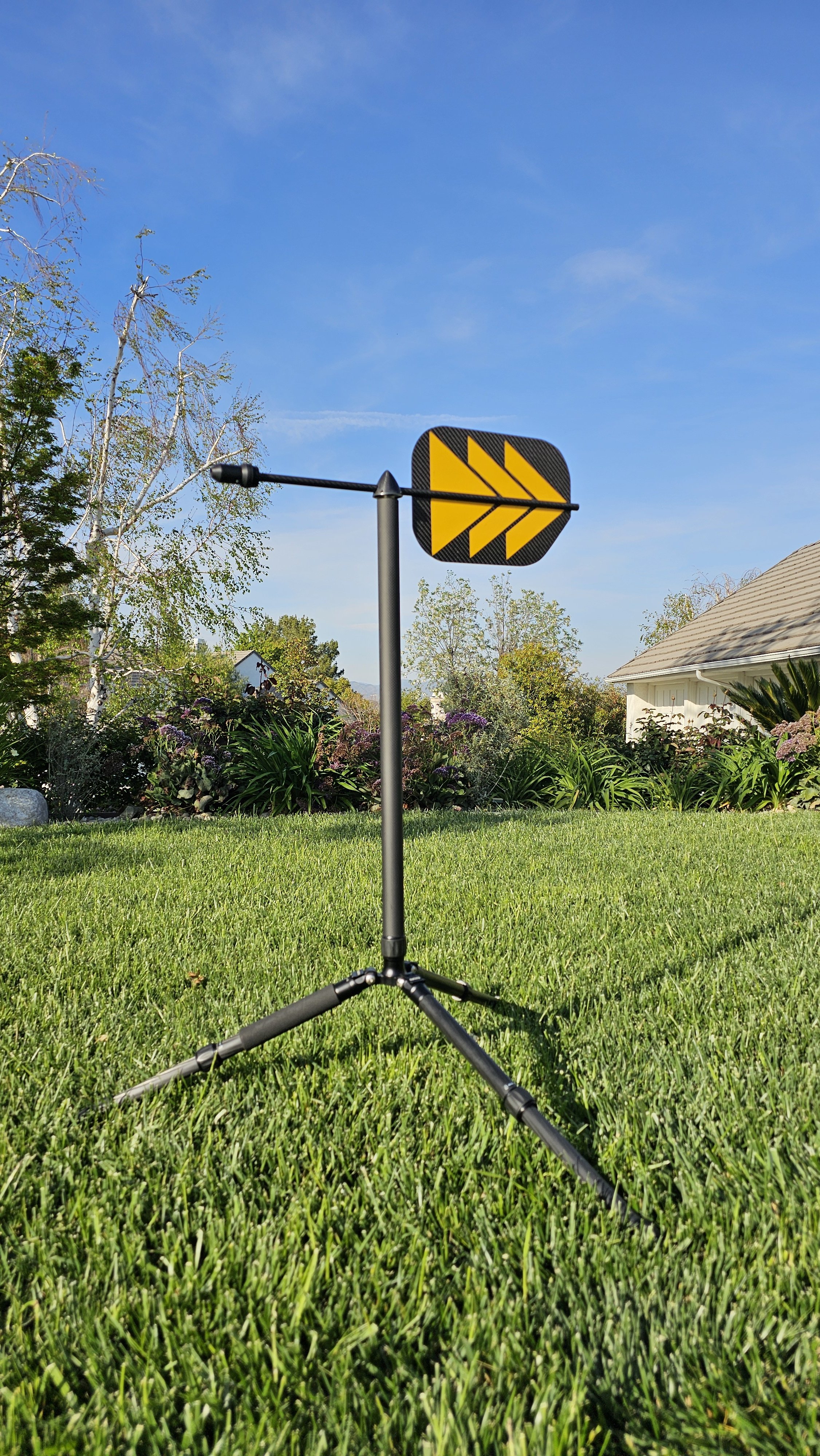

Perfect!
Is that a Styrofoam ball?

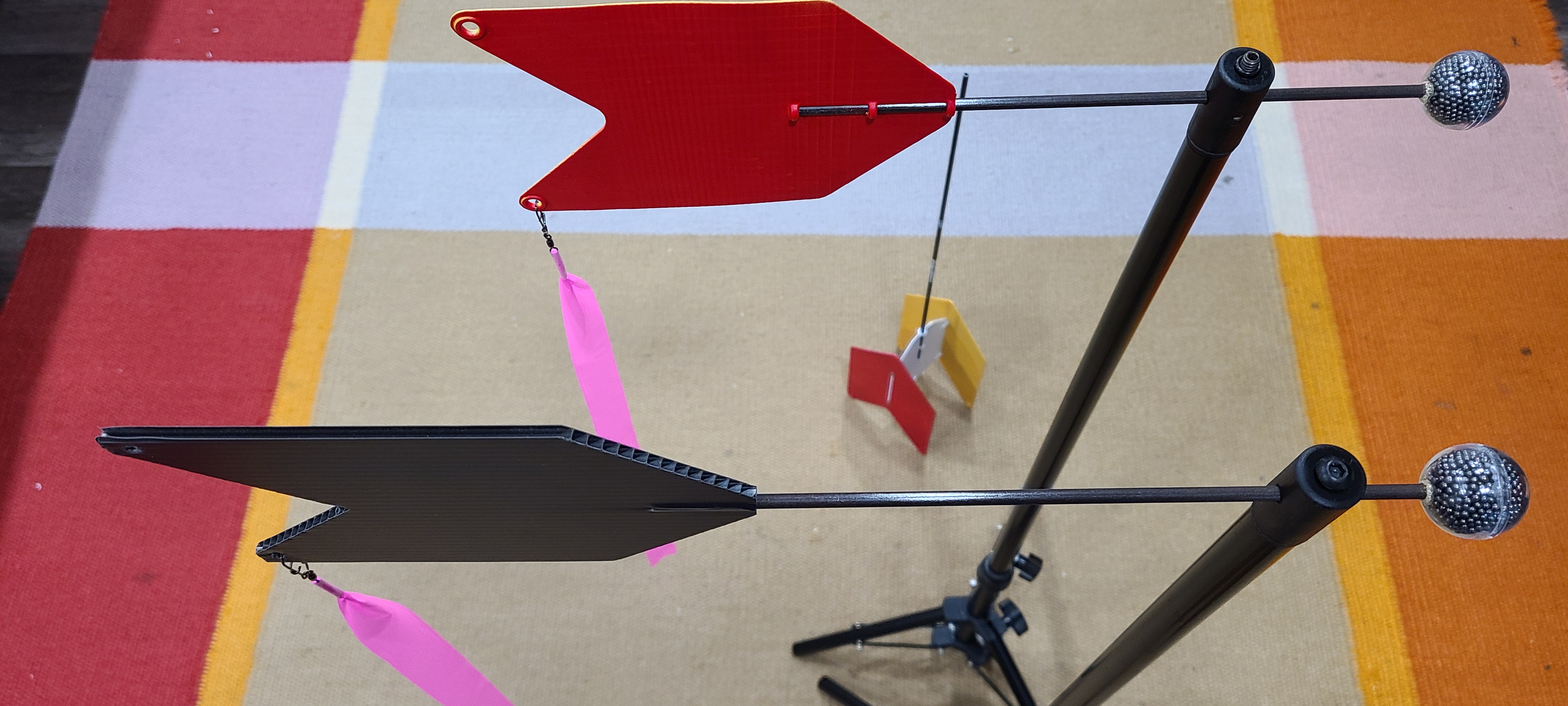

Nice, but I prefer a simpler approach. 🙂
I make mine from some flagging tape, a couple of inches of bead-chain and a piece of coat hanger...
Mine are a lot like BBGunn's. I use old political yard signs for the flat piece for the back and a round ball painted half red for the other end (I got the styrofoam balls from Hobby Lobby). I have a small wood block for the pivot and short pieces of steel to connect these pieces. I do not use a fancy support, however. I started using a long steel rod piece from a yard sign but they were a bit flimsy. Then I got some 3/16ths thick steel rod and it is sturdy enough to work better. I just push it into the ground. Another difference from BBGunn's is I have a piece of "Caution" tape fastened to the back. For light wind, the movment of this tape may be all I get initially. There are commercially sold wind flags that have heads like mine but I doubt there are commercial ones you just push into the ground. I just use them in my yard so I can do what I want. At the informal range I sometimes go to they would be OK too, however.
Perfect!
Yes, 2" styrofoam ball.
The flag/vane is corrugated plastic (think cardboard).
When I get it mounted to the stand it will also have a tail of flagger-tape to indicate wind speed.
Glad ya like it as it's simple enough to build for about anyone with 'garage shop' skills.
