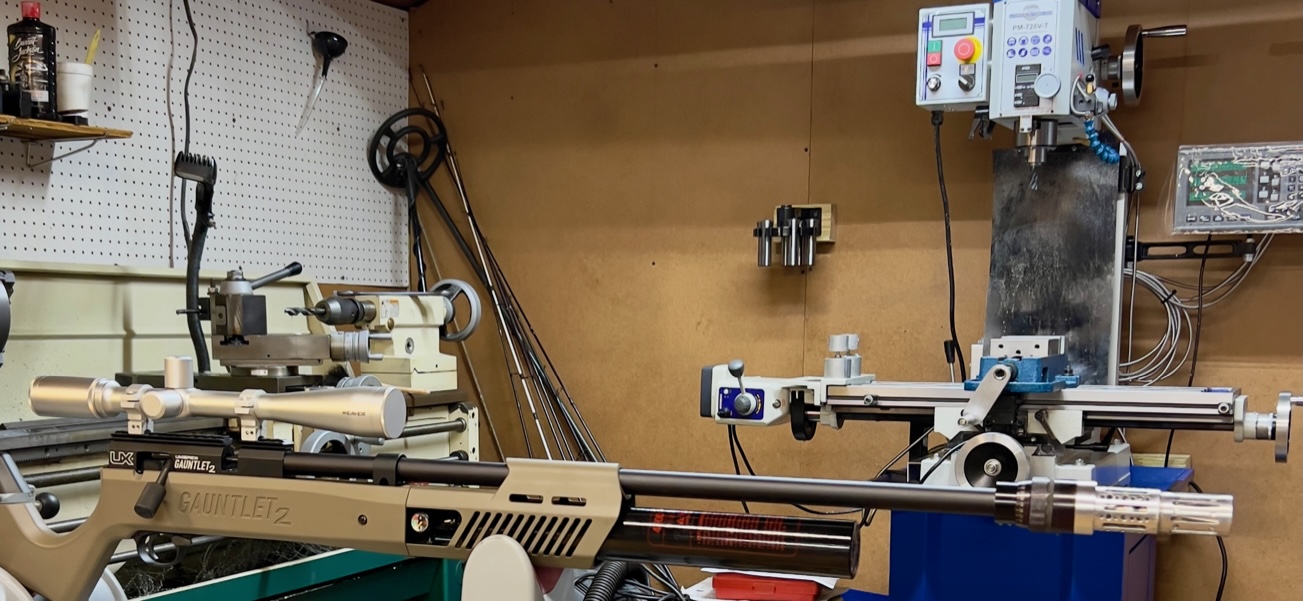

Making a Muzzle break for the FX M3
Looks cool but what does it do? Airguns don’t expel that much air to really use a muzzle break. Even at 30 cal it ain’t no 338 or 50.
