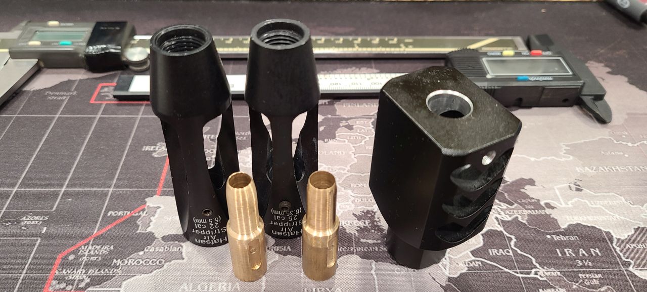

No problems here.....as you and I and anyone else that has experimented with tuning rifles and trying various barrel devices, know, that there is no exact science involved and no one device that's going to be a cure all for perfect accuracy, just too many variables at play. I've got several trash cans full of failed devices that I have made over the years...I can definitely tell you lots of things that don't work....LOL
I am a fan of airstrippers and I have several, modified some of them.
My take is that helps shaving off the air in front of pellet/slug. Imagine a 700 liner or barrel full of air need to empty ... I can confirm that the pellets speed is 20-30 fps higher with an air stripper.

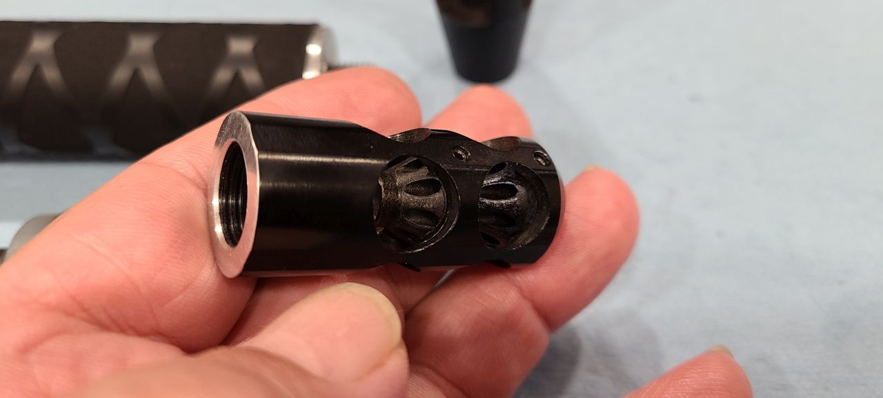

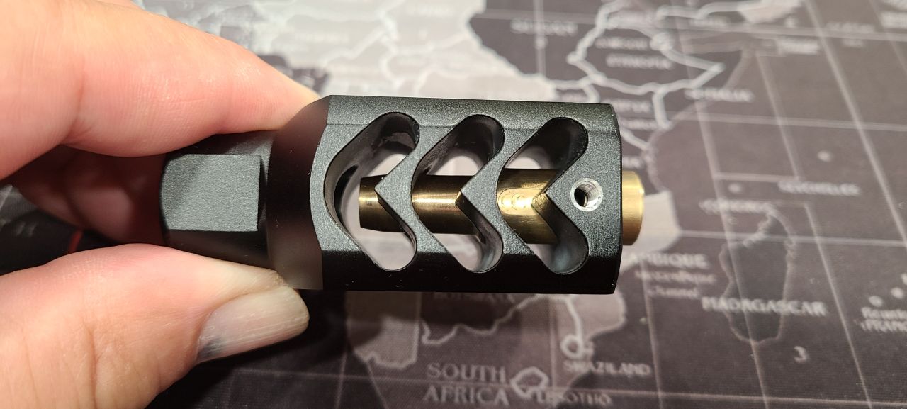

I have these, and I just got a new one that I started testing this week.
The important is a hole gap to bullet, also the distance from muzzle to cone edge.
Reactions: qball and DBlue
No amount of tuning removes that puff of air which PRECEEDS the exit of the projectile from the bore. Agreed tuning makes an enormous difference. It might be that there is more going on here than you have considered? I have exceptionally experienced shooters testing my strippers. They are reporting the accuracy of their otherwise exceptionally well tuned and maintained rifles does improve when one of the strippers we are working on is installed. I don't have any knowledge about your experience shooting competition so I won't argue with your opinion but that is what I am being told by the guys doing the tests. I have not personally tried to prove what they have told me because I don't have time to spend a bunch of time on an indoor range.
The puff of air precedes the projectile is called blow by and usually is very little and projectile and barrel combo specific. Generally a standard land and groove barrel tends to have that while smooth polygon barrels have less. Sometimes even pellet skirts do not fill all the way to full depth of grooves and obviously slugs are much worse, I've recovered pellets with only marking from lands but not grooves.
I'm not saying air strippers don't work, I'm saying it's for that possible last 1%. However to have air stripper work properly then you can't use a moderator which is a huge no no for me, noise is why I don't like shooting PB. An air stripper inside of a moderator would be ideal compromise/solution but unless someone has the ability to do custom work it's really not feasible/practical as the stripper needs to be fairly close to the muzzle plus bore size tolerance has to be very tight to be effective.

I am NOT talking about "blow by". There is practically no blow by in an airgun because the pellet obturates and seals the barrel. The puff of air is the air pushed out of the barrel by the pellet as it accellerates down the barrel. That volume is easily calculated. It is the radius of the caliber squared times the length of the bore and in a longer barrel can be quite substantial. For example in an 500mm barrel of 5.5 caliber. That volume is almost exactly 3.75 CC. It of necessity is traveling at the same speed as the pellet (something like 600 mph) as it exits the muzzle and is quite turbulent. That air is in front of the pellet, and is slowing down rapidly. The pellet has no other path than through that cloud unless that air is stripped. How much benefit there is, could be measured by laborious testing and a bunch of math. Feel free to do that and prove it for yourself. Then you will be speaking with some authority about how much difference it makes. I can't so... worse than that I am just going to trust the guys who are shooting the test moderators. They like them a lot. How much, "And the little air strippers... they are incredible! Stupid, crazy, STUPID accurate!!!!" So I dunno bud, you and I are going to have to disagree about how well they work. That's not a problem for me and most likely no problem for you as I know you to be as humble a man as I am... ;)
As for having a stripper "work properly then you can't use a moderator"... again there is a trade off there between accuracy and moderation. The stripper DOES work inside a moderator. That is what we have experienced. It is a tougher problem to crack. Timing becomes a real issue and (I will repeat) that means even a gun's tuning can make the whole system fail. I don't believe bore size is as critical as you believe it to be. You can build a $200.00 stripper and it should work better than a $20.00 stripper. That does not mean the one does not work. It means it cost 90% less and you have traded one design criteria for another. The CUSTOMER then decides if it works well enough for his purposes.
I do think the shooter should be aware that the moderator can totally screw up his tune, especially if the pellet and that pressure front formed inside the tube meet at the exit end of the moderator. If that happens ES goes up and accuracy goes to crap. So the shooter should make sure his rifle is shooting well and then attach the moderator. He should at that point double check his accuracy BEFORE he does anything else. If the accuracy is still there he is golden and can tweak his tune. If it isn't he will know the moderator is degrading his accuracy and can either adjust his tune or try a different moderator.
Now if you come back and tell me you have a degree in mechanical engineering, some serious math credentials and you've been winning matches for 20 years I promise I will take everything I have said back. OK? (Naw, I won't but it sounds good) Meanwhile, let's you and I respect each other's opinion and experience.
