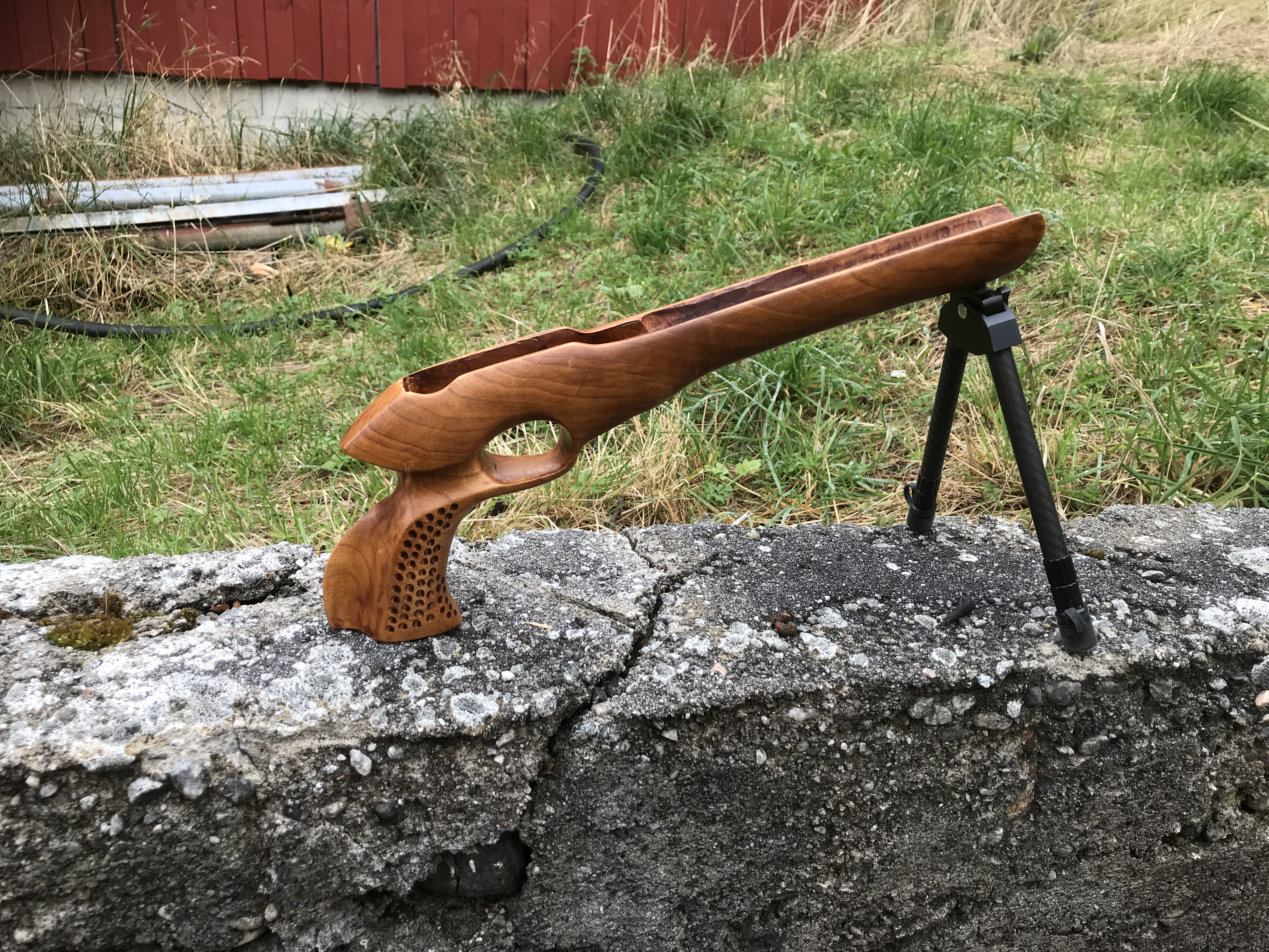

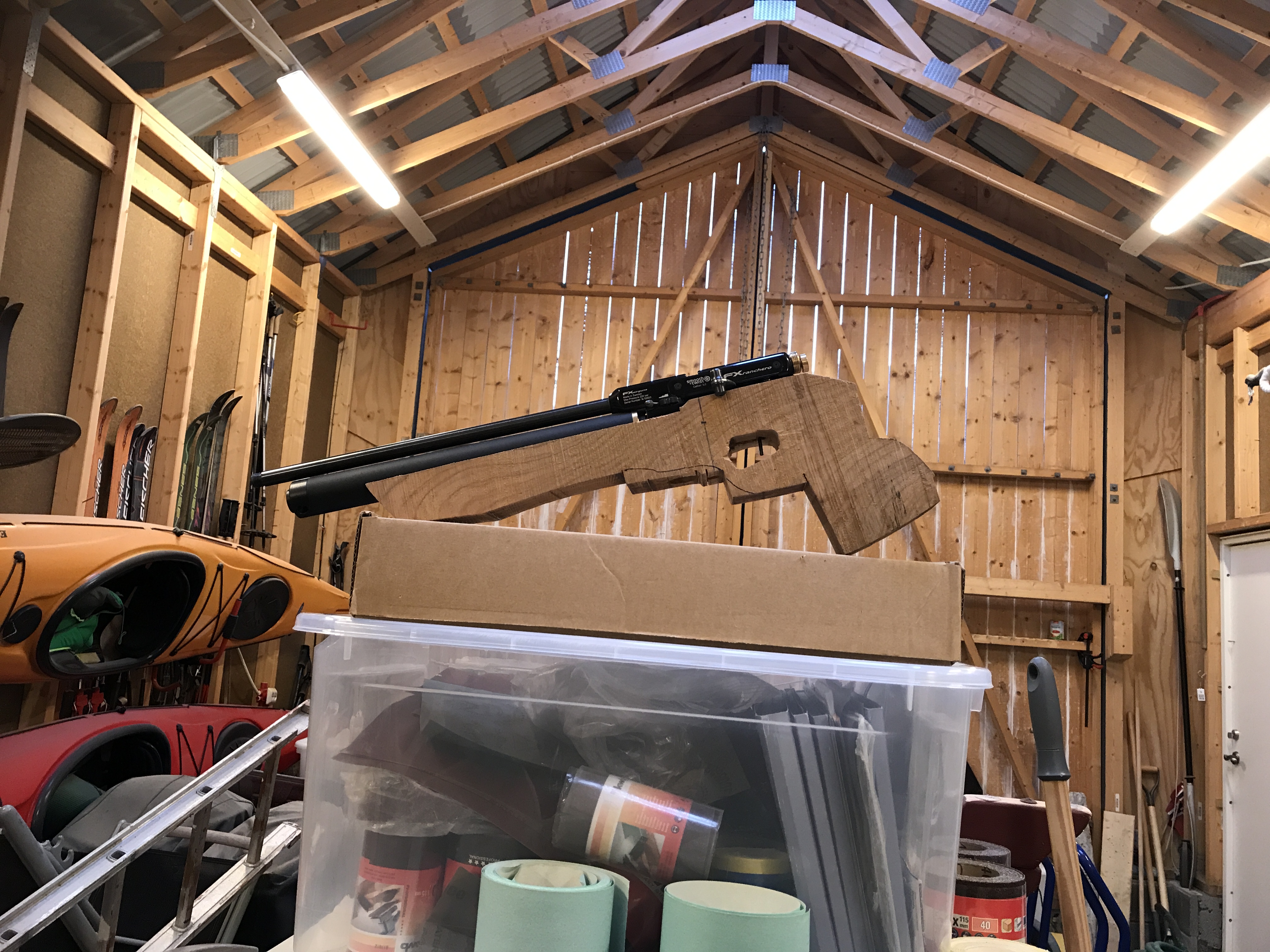

Making a new pistol stock

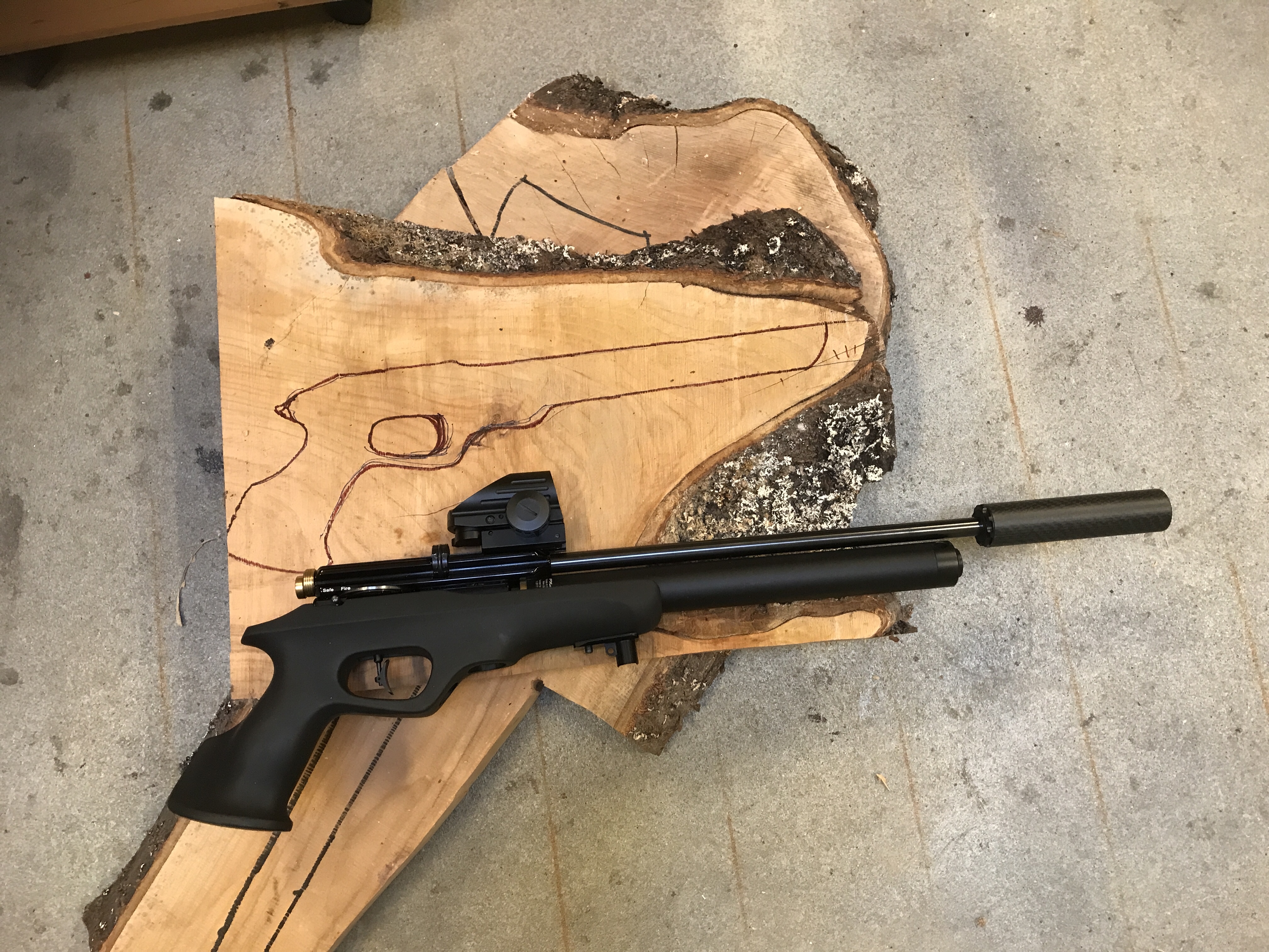

For my custom built FX Ranchero
Pretty, good work. I think I would put a hidden dowel down from inside the receiver area just behind the trigger opening through or well into the grip. Looking at the grain structure that area of the grip might be prone to breaking easy.
Well, it’s a solid log, no recoil to talk about, and I am not bringing it to battle…. And actually, it’s a test so to say. 😎

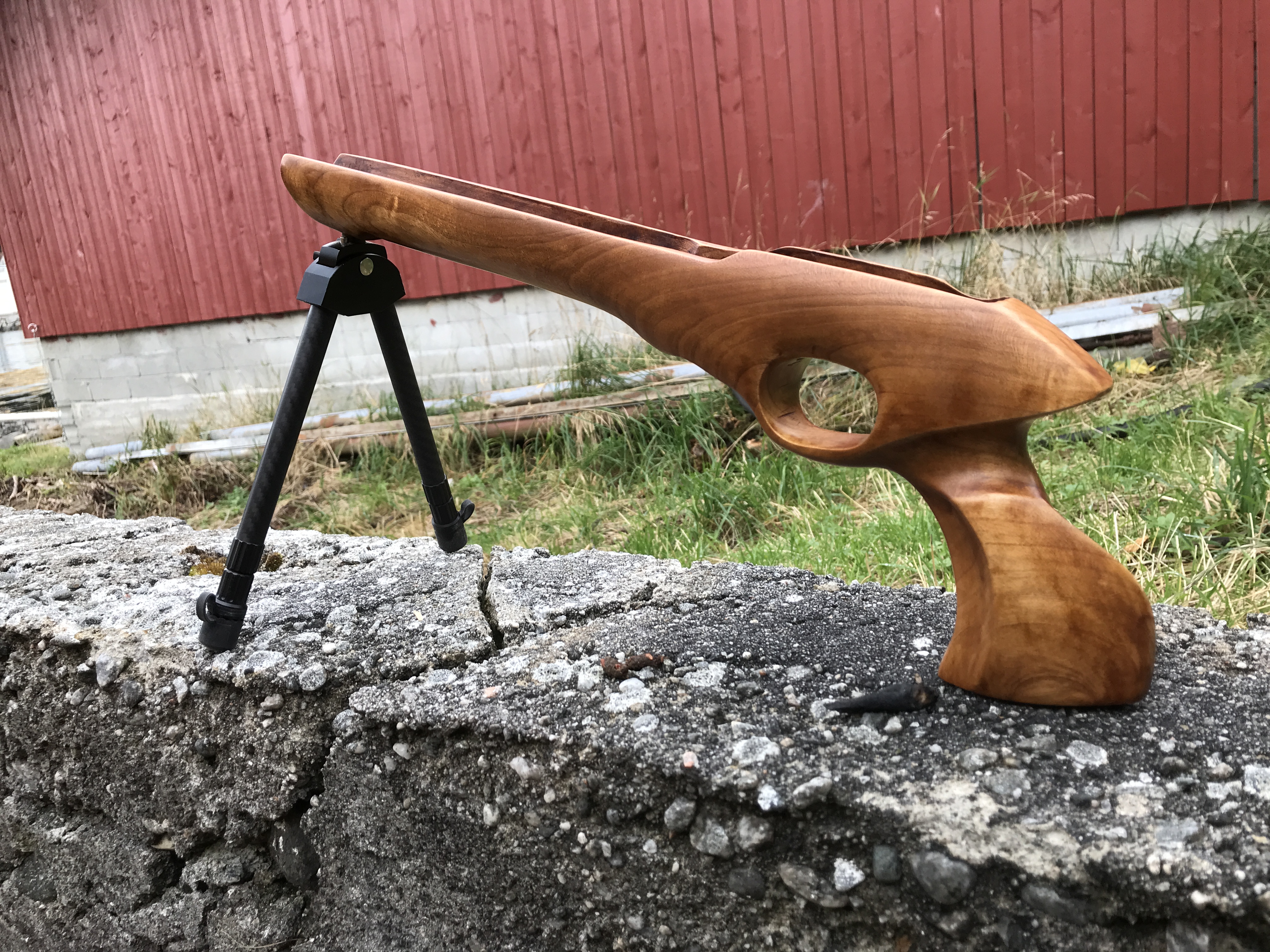

very nice work , what kind of wood ? like the positioning in the grain .
It is Morell tre (but not sure if that is correct translation), so I simply call it Cherry wood, and then everyone know what we are talking about. For the coloring/bust rising I have used a very, very strong coffee mix. After some layers of oil it will darken a bit, and then it is ready for polishing.
It's a Morel, kind of like Morel mushroom. The tree is in the same family as Hawthorn, Plum, and Cherry trees. I'm not sure, but I don't think they grow in the US of A. I think they are only found in Europe. Wherever they are from, it's sure a good looking wood. Beautiful grain. You sure picked a nice piece to make the stock from.

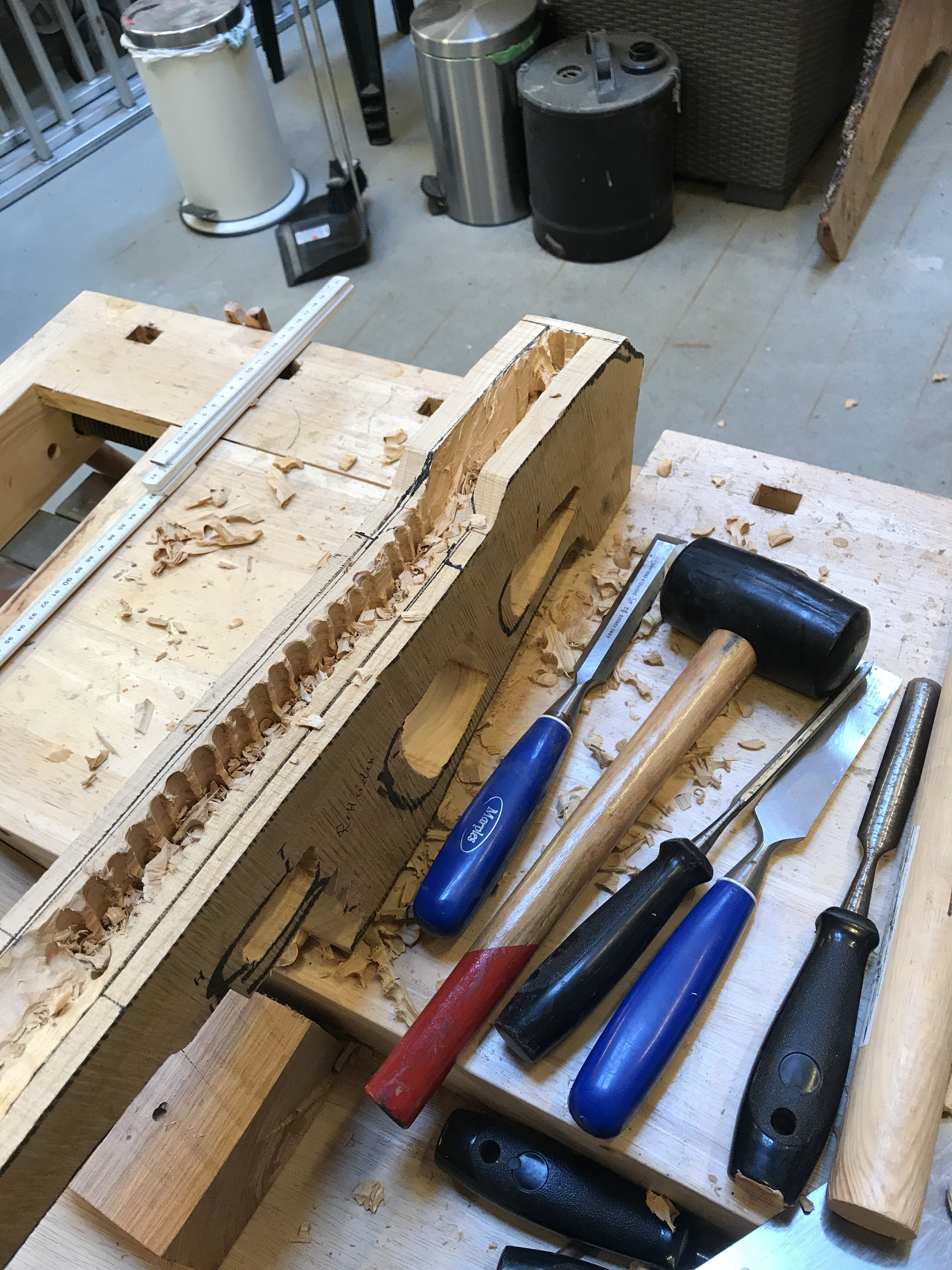

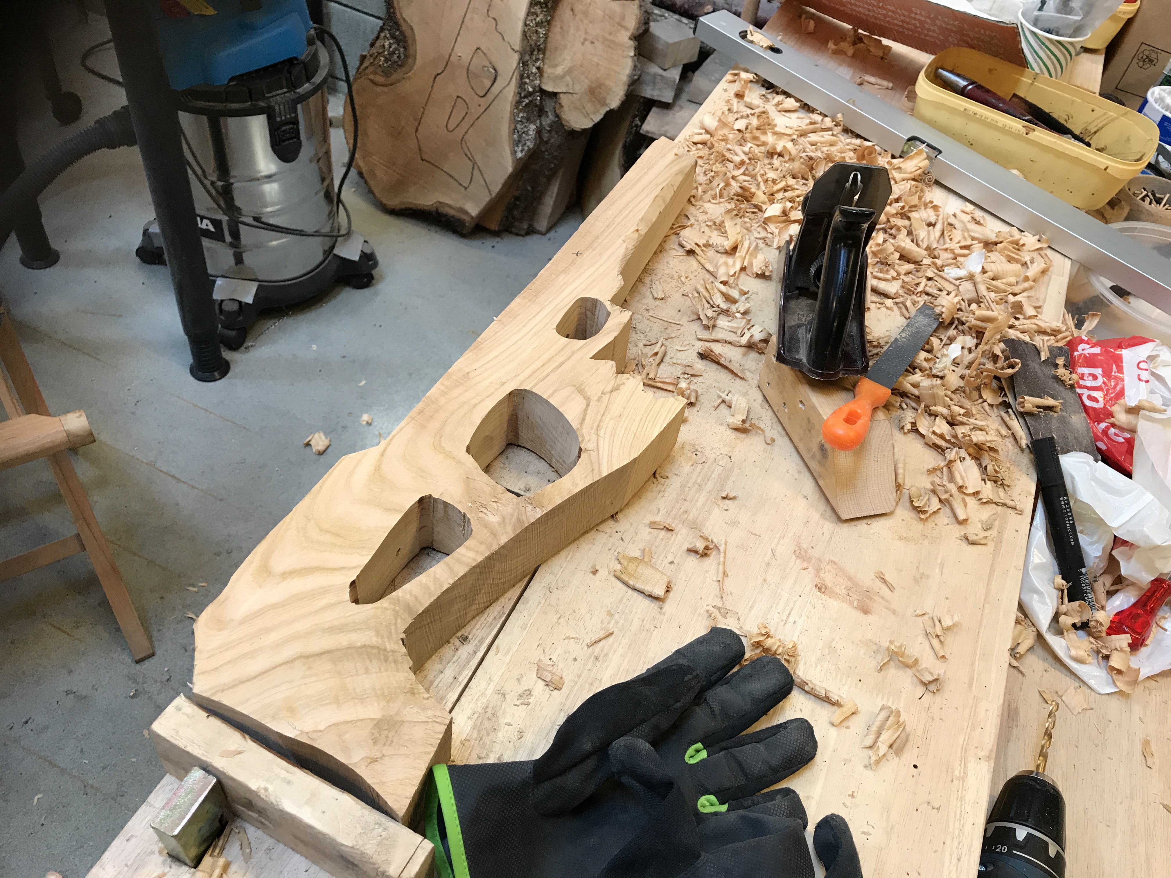

What did you use to shape and inlet it?

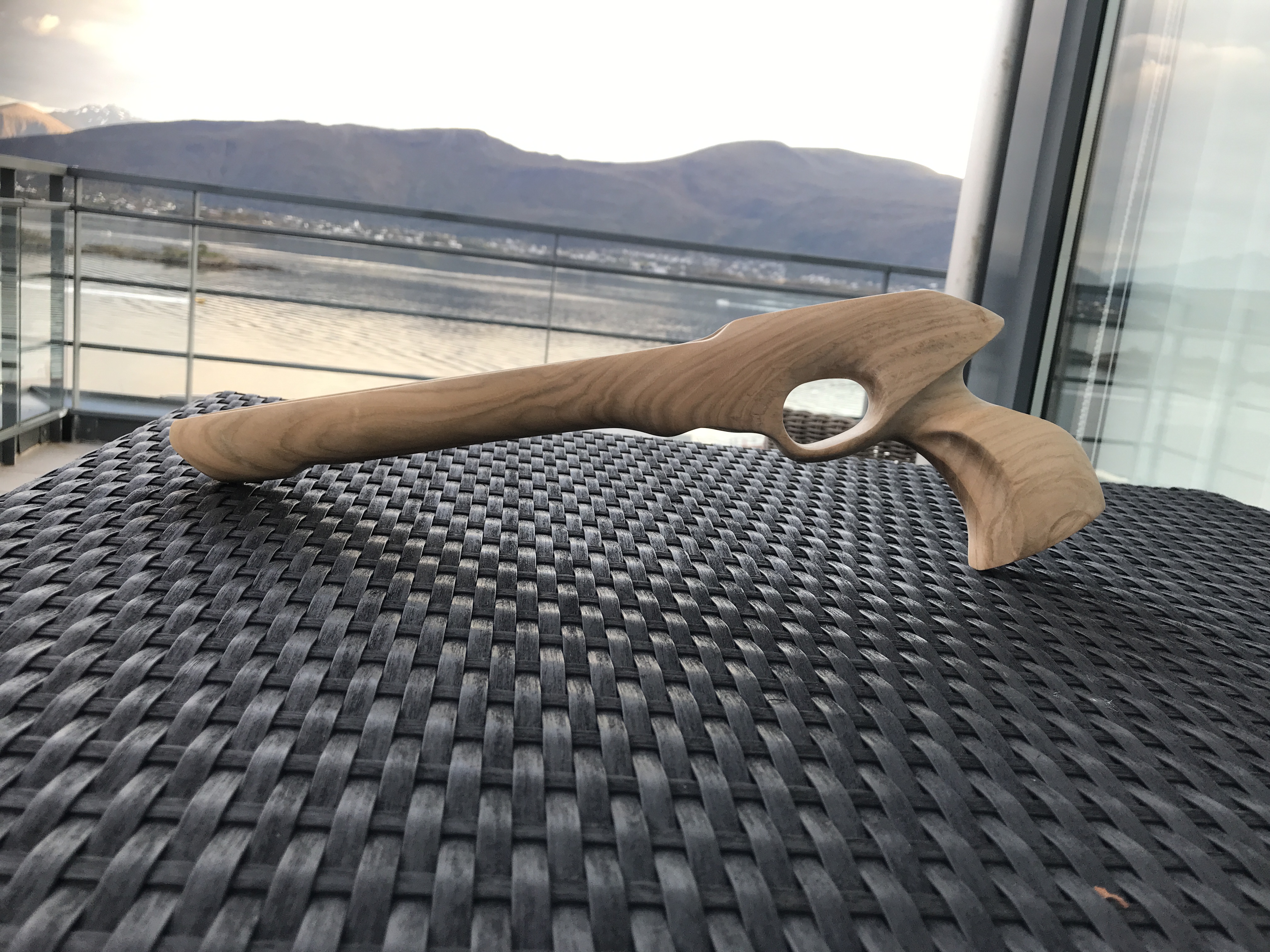

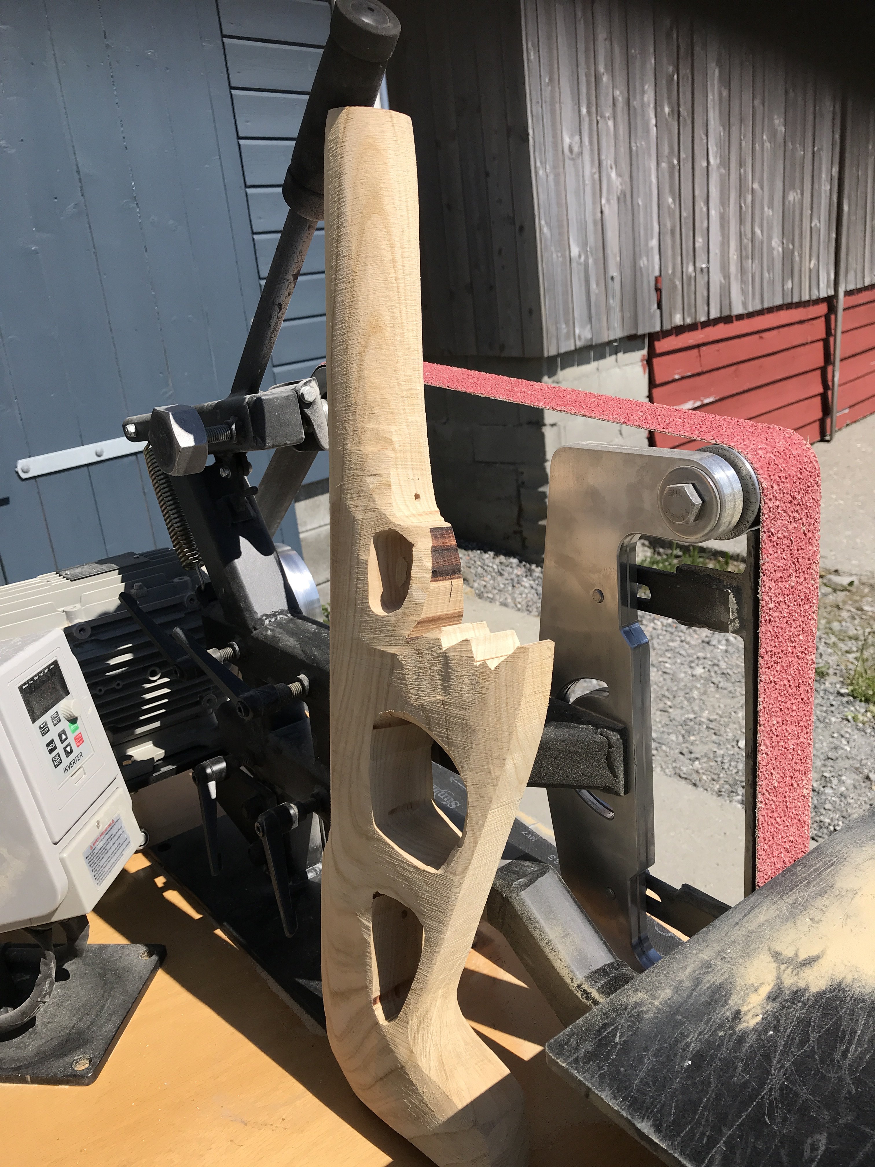

oh various hand tools. Always starting with the inletting. Drilling the exact needed depths, and then chop out the wood and start outside when the metal parts are fitted to the inlet. The inletting is really the most challenging and time consuming part. The outside? Well, besides a grinder I use a hand rasp to form the stock before sanding with finer and finer paper. The rest is oiling and light, light fine sanding between layers before polishing. Bad English, so better put in some pics from a wildcat productions to clarify the process a bit.
