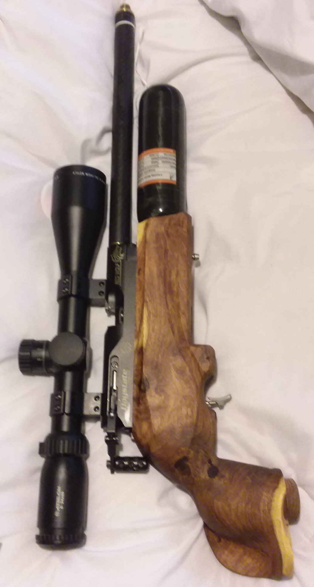

Over the years, I've been asked to get more power, change caliber, change the form, etc., for things in production. It has sometimes been fun and sometimes fairly tedious and frustrating. MOST of this is probably on me when I've "brainstormed around the campfire " with friends. I've been preoccupied with airguns since the late 70s and done a fair share of "upgrading" along the way to the level of accumulating the machine tools and experience to be ABLE to do these things. Some of the "upgrades" were instigated by nothing being available with that attribute and some were just "I've got this airgun... what can I do with it".
Case in point... a friend contacted me about converting a rifle to pistol for FT competition ... which I did and feel it went decently ... THAT project created the interest for me to look at my own collection and see what might be a candidate 😉 So my first attempt was convertingan EVOL 22 to legal comp pistol for FT... Now it's been campaigned a couple of times but is a bit light... While working on that, I noticed that I have a pile of old Red Wolf parts so when a fried offered up a small bottle, decided to make it a reality and set to work to see if it was possible ... the result is this:
which I campaigned this weekend at ROT somewhat unspectacularly, BUT which was absolutely a joy and was stellar on it's part...

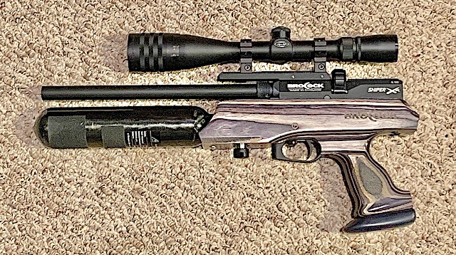

Picture 1) a pistol to FT pistol staying pistol looking and compact !!

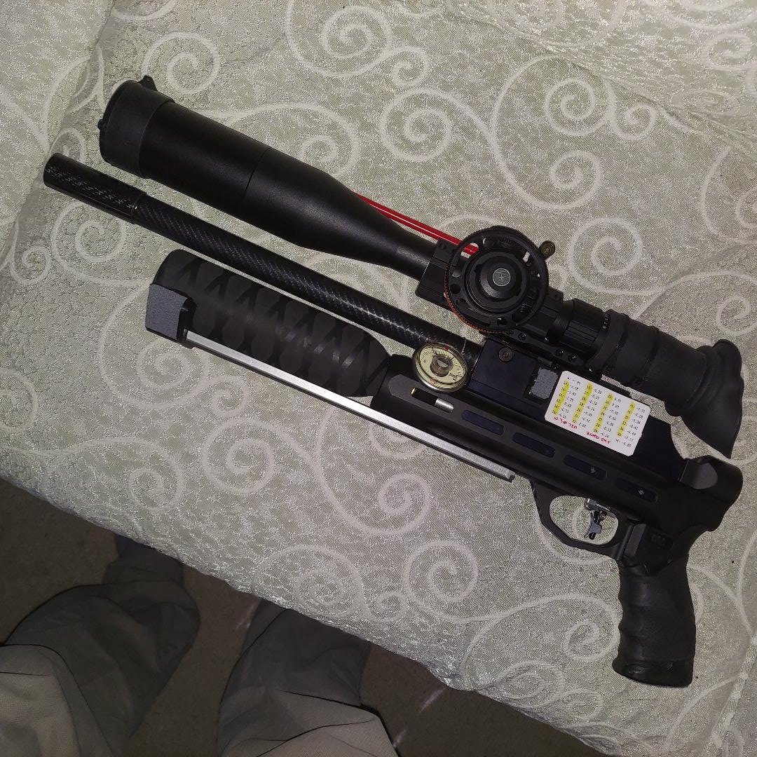

Picture 2) a Rifle to Pistol conversion that is still fairly compact.

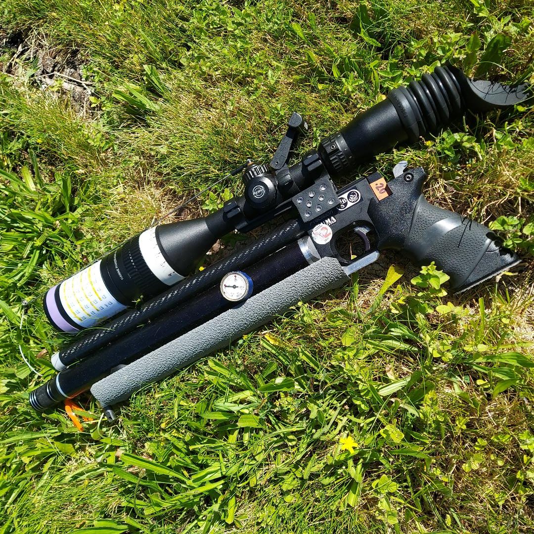

Picture 3) a Rifle to Extreme Pistol conversion & yes a Large and Heavy rig.

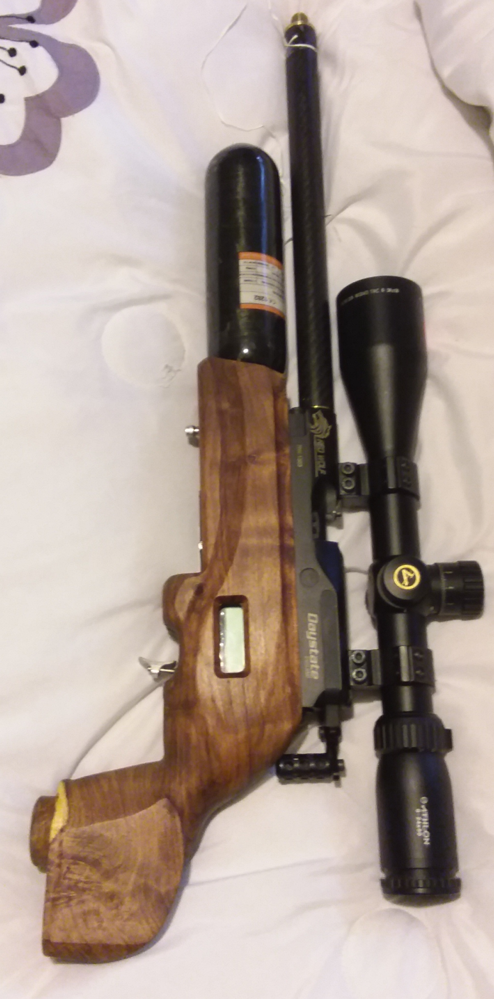

Picture #4) a Rifle to Pistol conversion and it to a fairly large and heavy rig.
All are AAFTA legal in the 25"/15"/3" rule ( Tho #3 ) is a >20 fpe rig and others are >12 fpe rigs.
