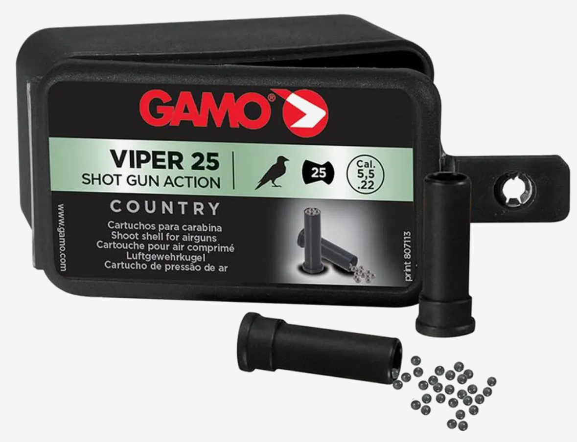

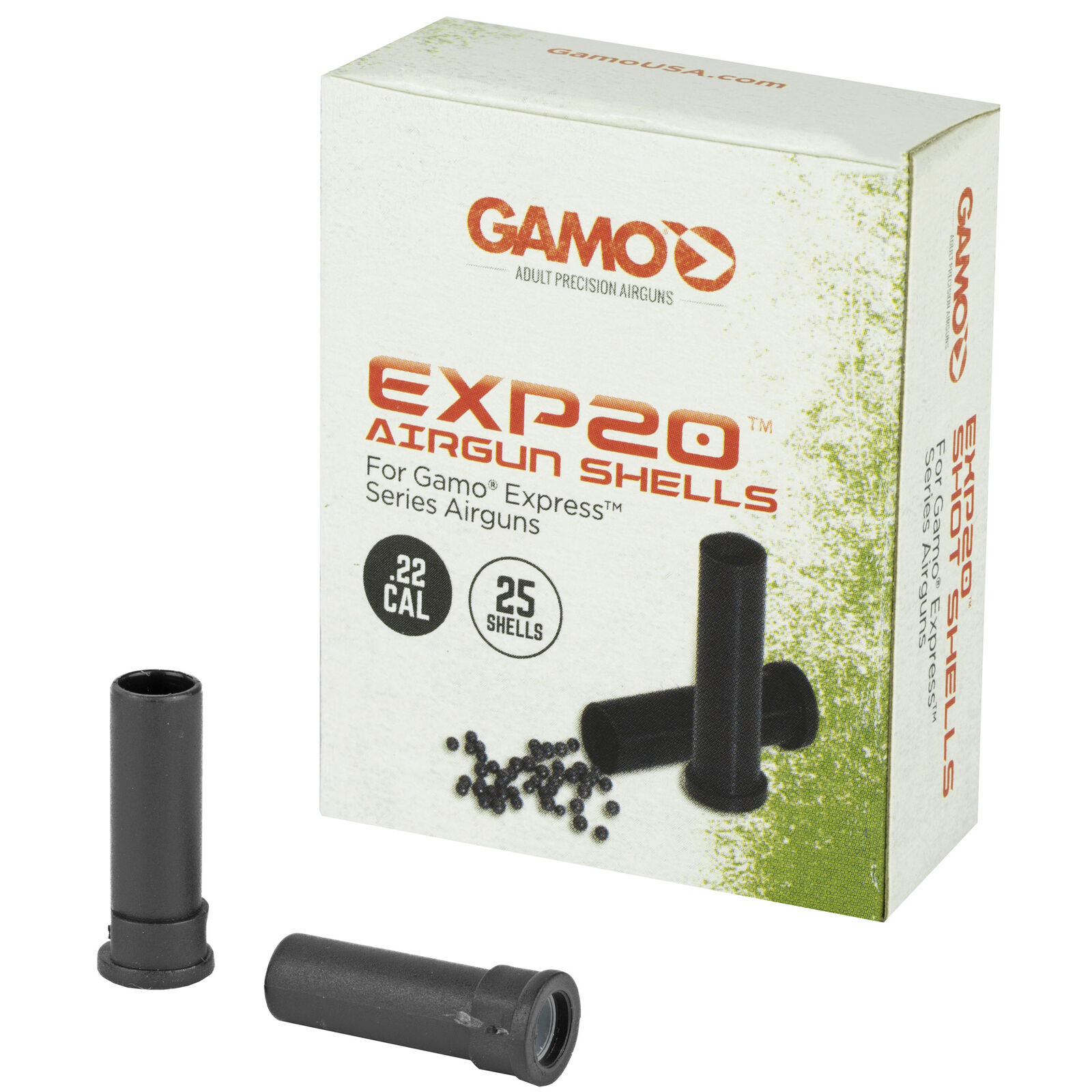

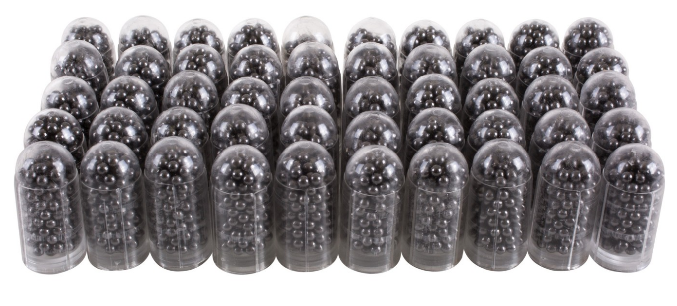

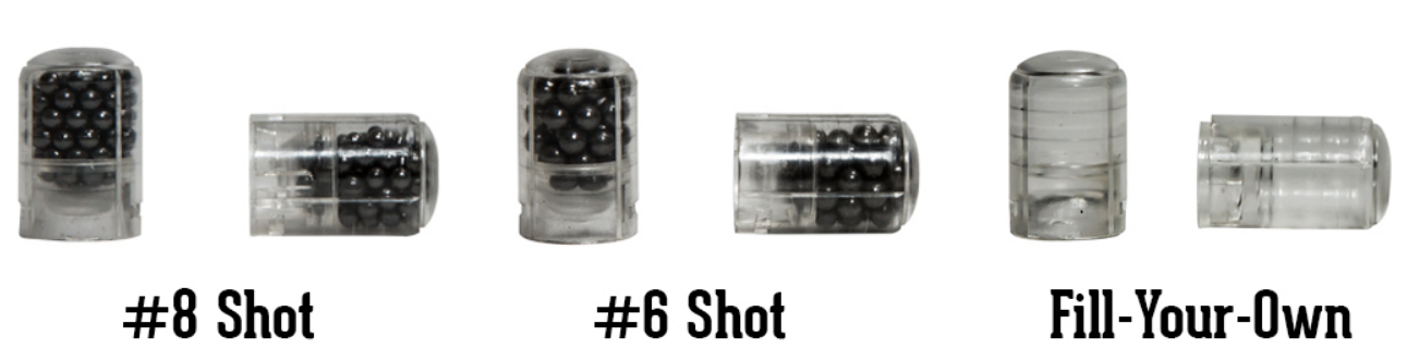

There are some products on the market you might take inspiration from.
View attachment 462068View attachment 462069
Shot shells for airguns have been around for years, mostly for .50 caliber airguns afaik. I have seen several different versions, from shells to wads you fill with your shot of choice.
View attachment 462065View attachment 462066
so yes when I said normal I meant guns designed for pellets only, I do like the drinking straw idea, that's something I didn't even think about. im currently looking into using pill capsules, there's a size that Is pretty close to 25 cal and one that is almost exactly 22 cal. I don't think there will be much of a point in this project but it would be pretty cool I think.
pill capsule idea is interesting but wont they be too tough to break open when you fire?
