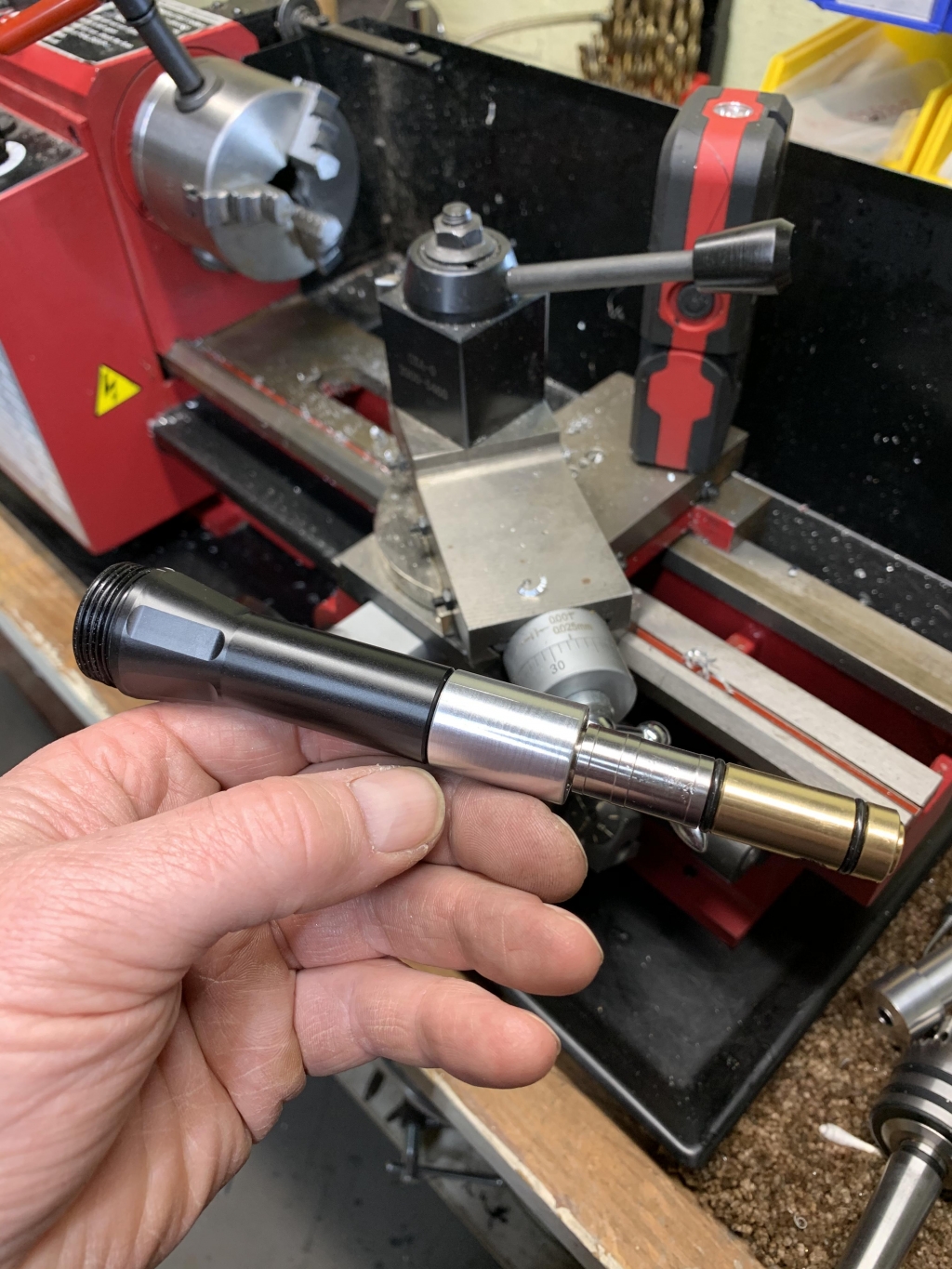

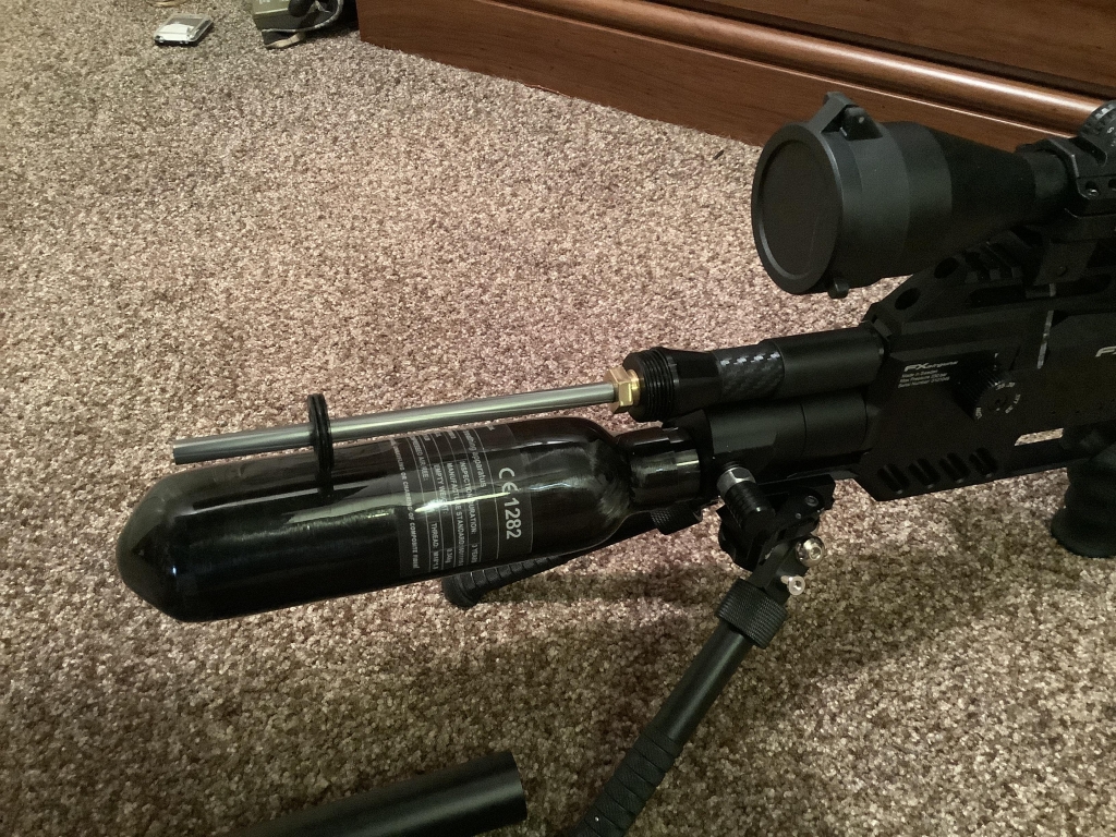

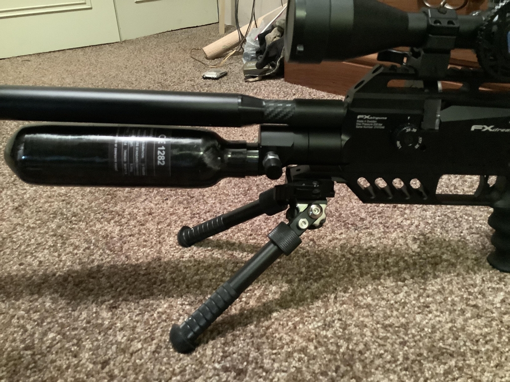

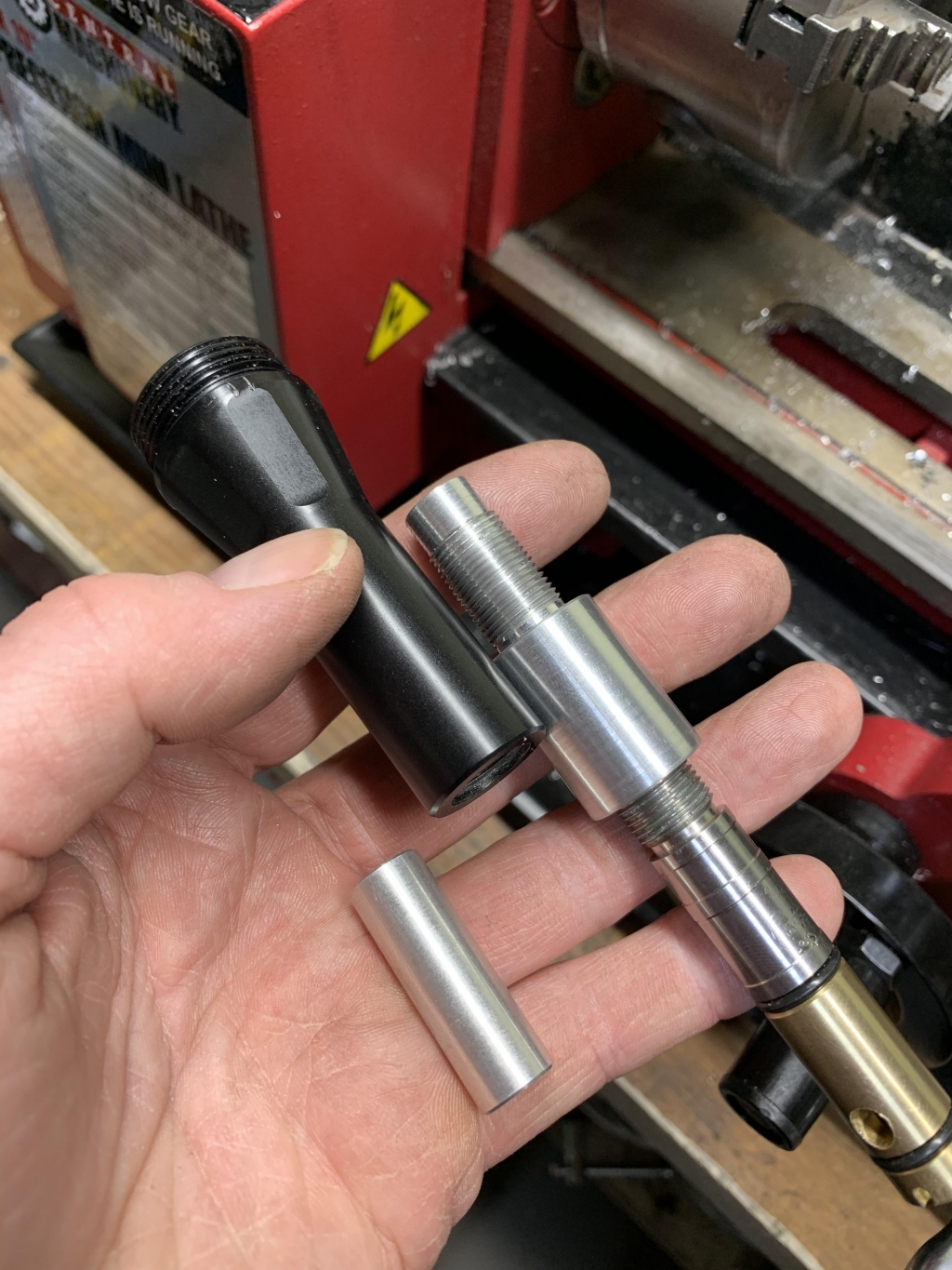

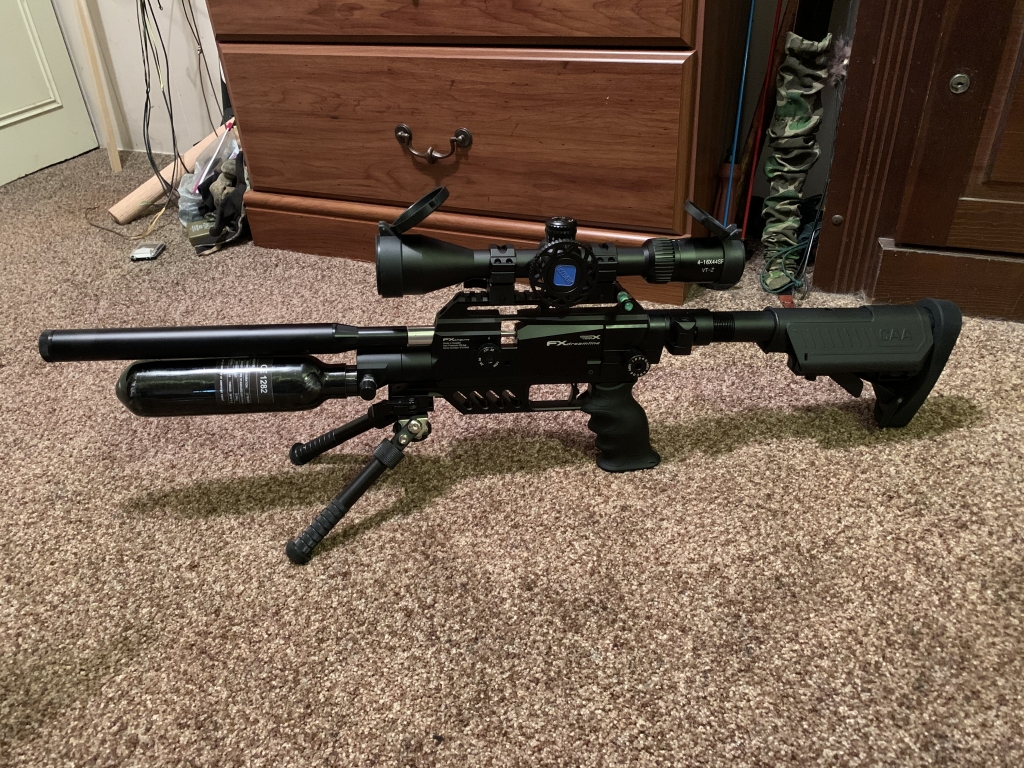

Making the Dreamtac Compact work with plenum extension

Sorry. I posted this so guys can copy what I did. I would have to charge too much to make it worth my time.
I figured with the 220 cc it would give me a few more shots and with the 22 hades crows at 50 yards are toast
It will definitely give you more shots. I actually prefer my gun with the 220 on it. With the extra plenum and a 300, the whole balance of the gun starts getting off. That’s why the last thing I wanted was a 5” can on the gun. It made it worse. But when I pay over a grand for my guns, I get picky. FX nailed it with how the gun handles, it’s not a bench gun. Don’t want to screw that up too bad.

Wow, it’s been over a year since I built that thing. I would have to heat and disassemble my barrel to give you all the dimensions. I really don’t feel like doing that at this time. Sorry.
