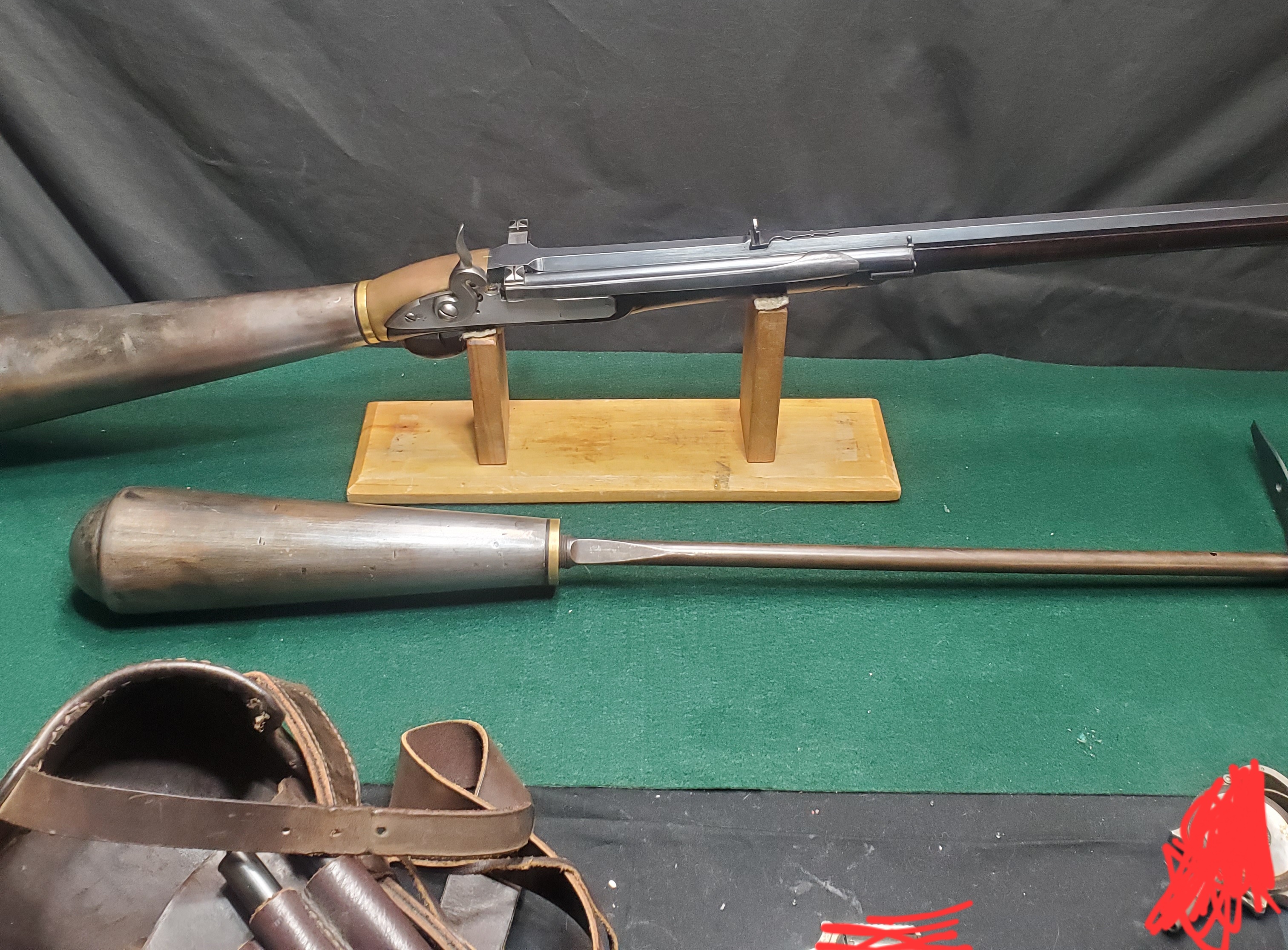

Recently hand pumped this gun in the photo... no idea what the start pressure was but counted 1550 (who knows how accurate my counting even was at that point😆) and then quit. It was getting pretty hard to do by then.
