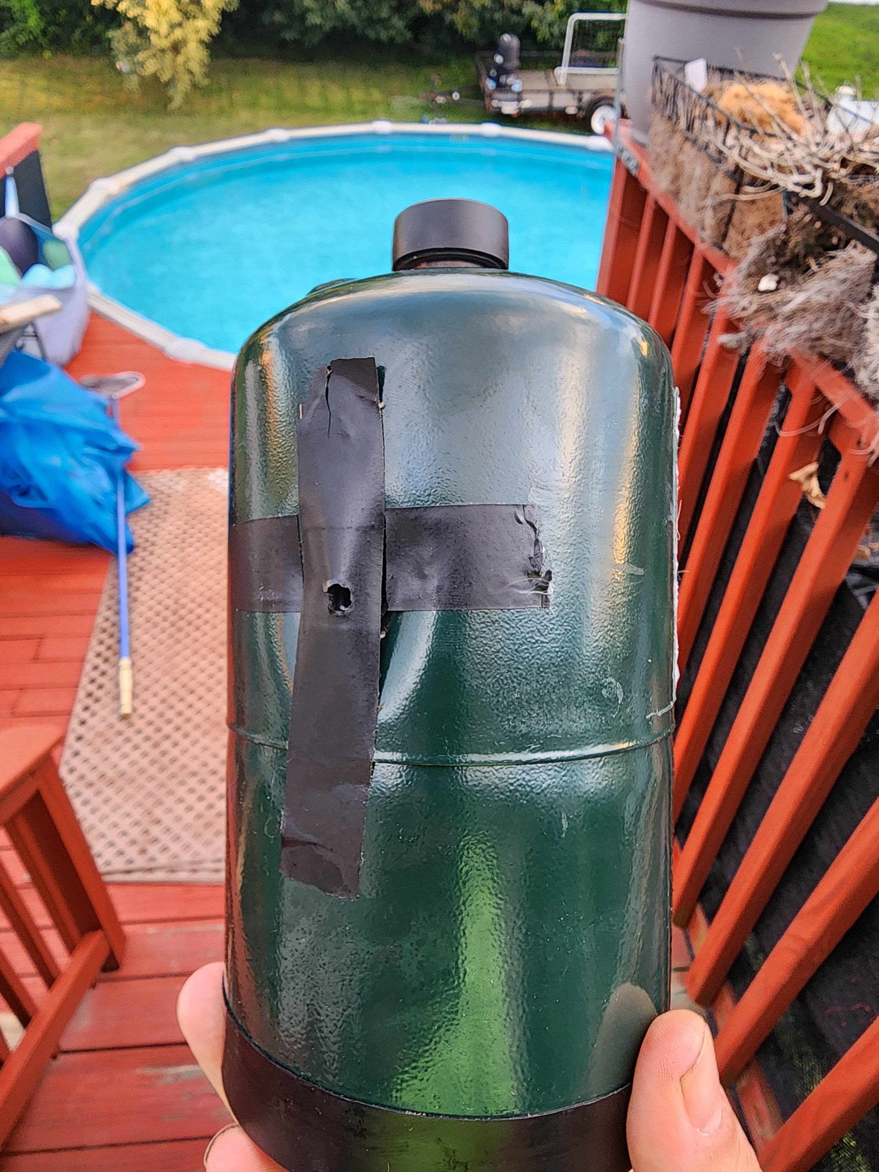

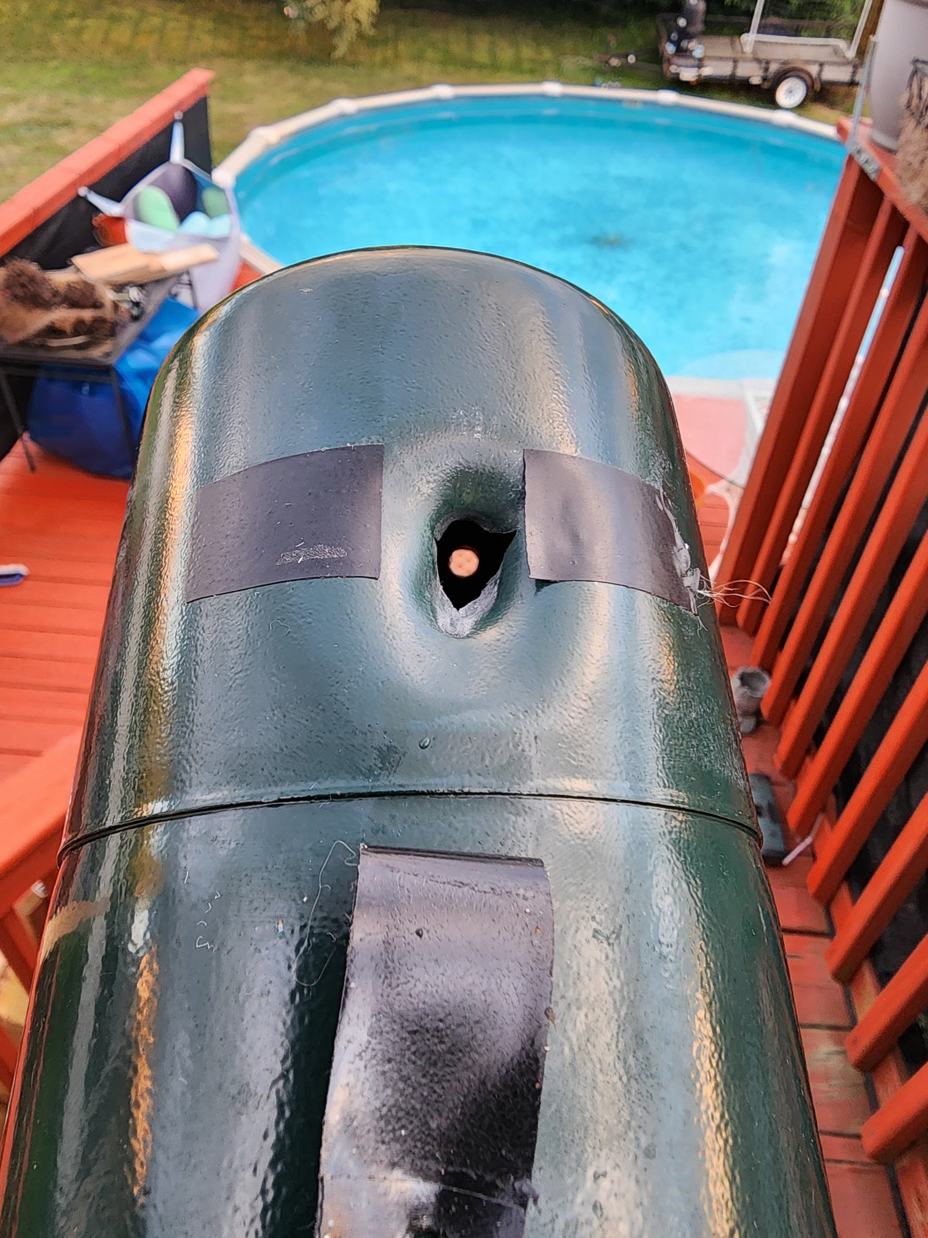

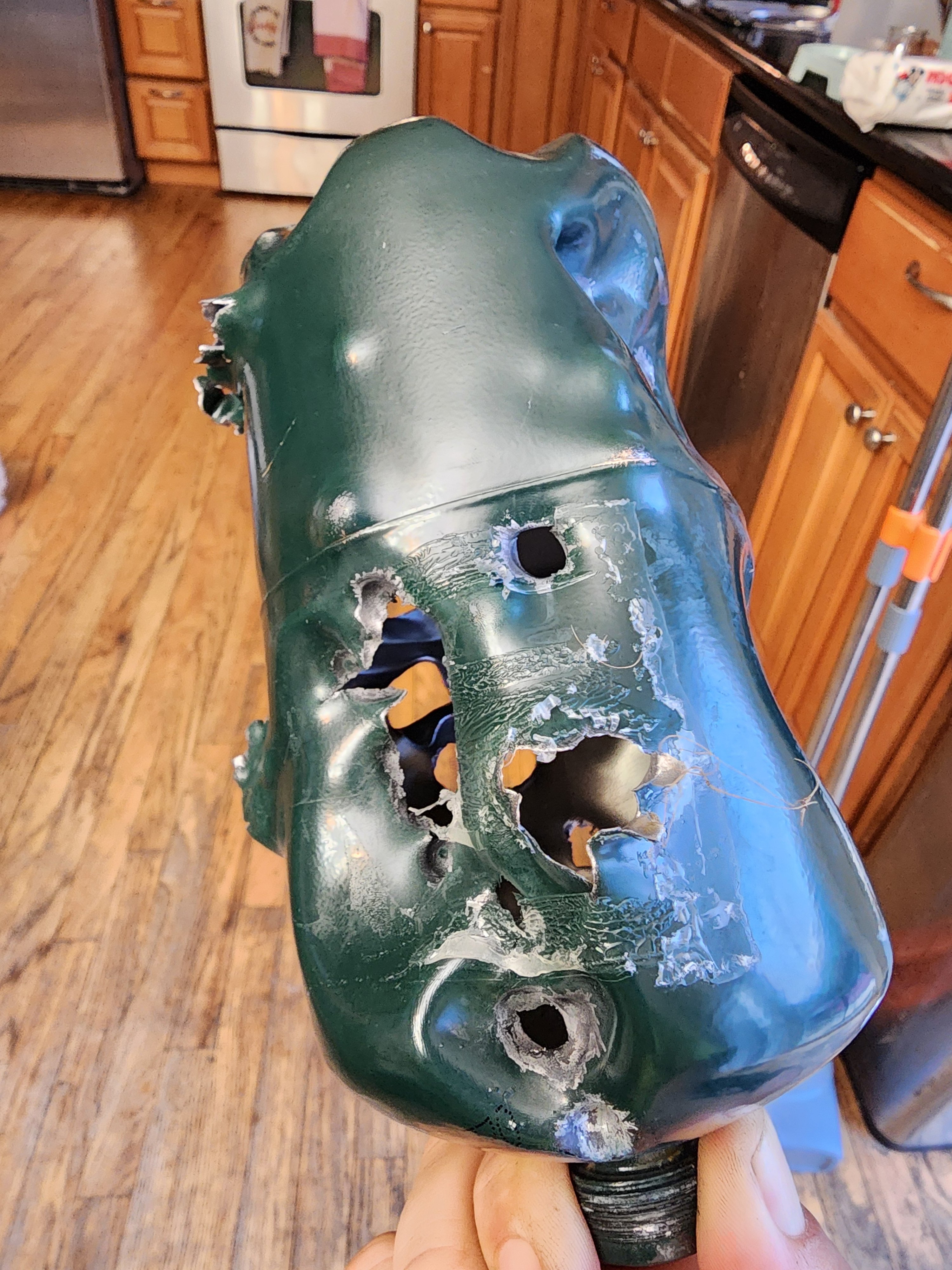

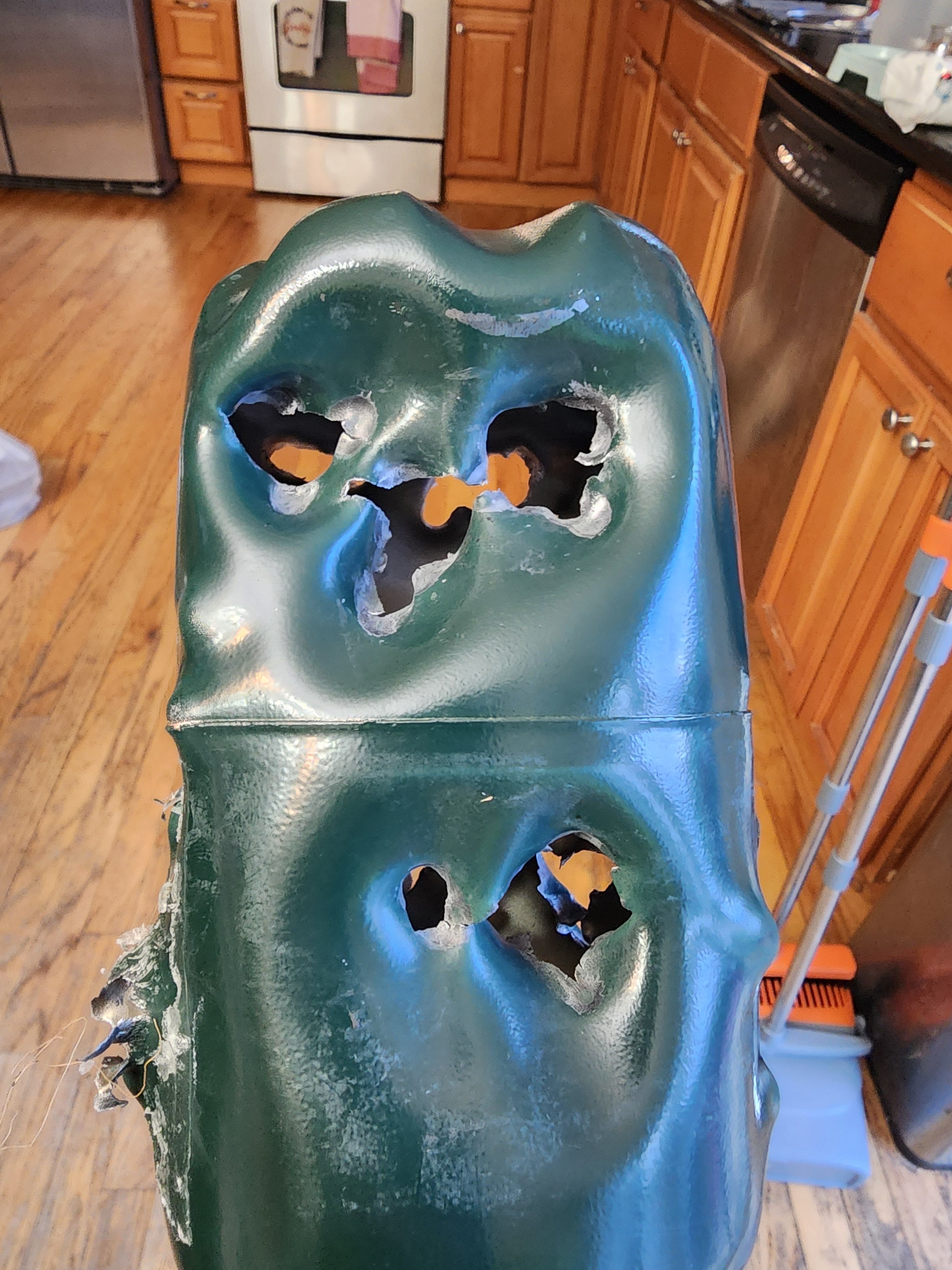

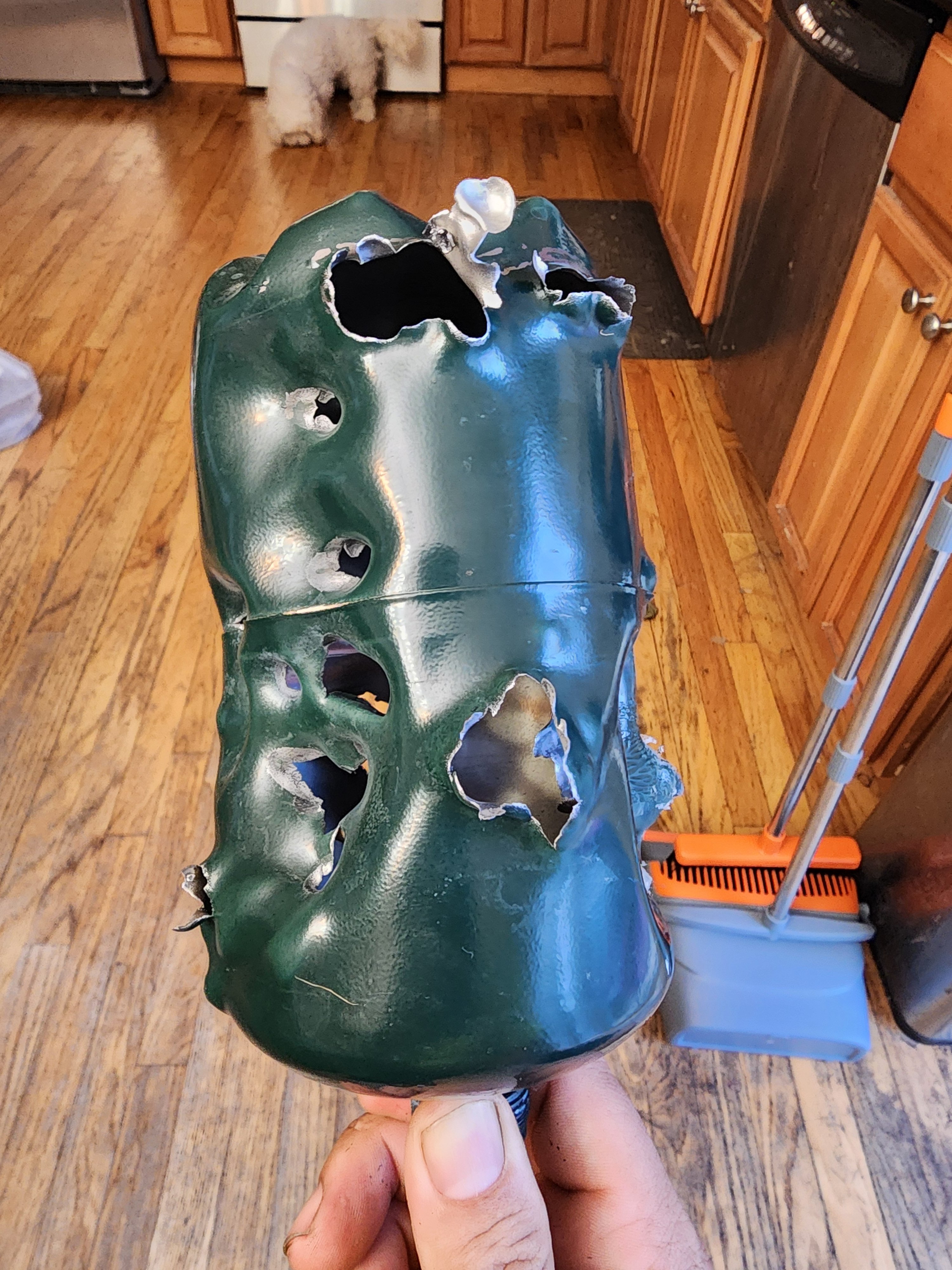

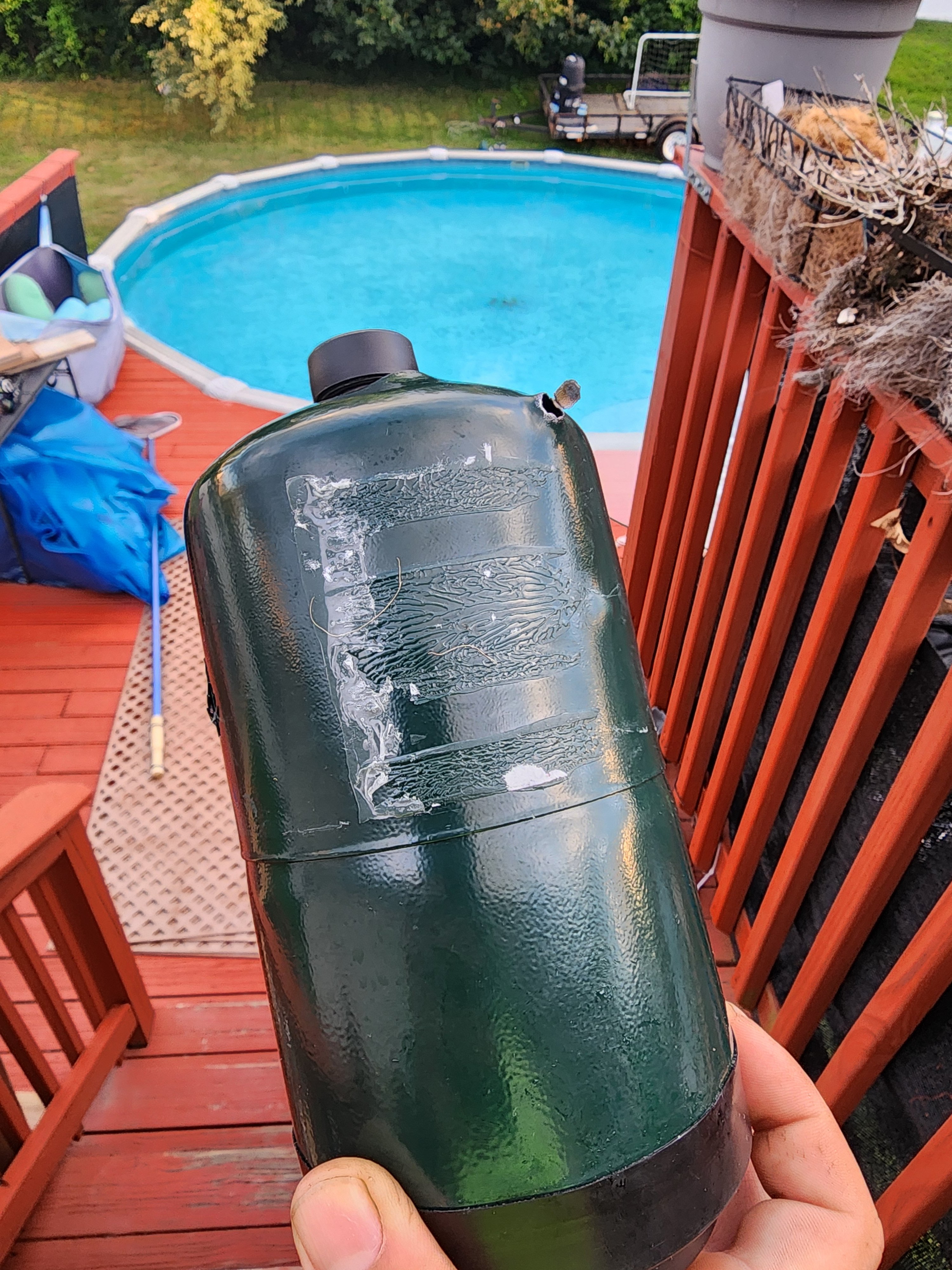

Benjamin Marauder. 22 maxed power
With h&n 21.14 gr domed at 30 yards my home range.
Threw both sides you can see on bottle.
I need to get a chrony
Actually I'm not seeing that .... if going threw an existing hole it appears to exit threw the contacted side. If hitting the facing side of shot, it has made a dent on backside as clearly shown in the photo's
A soft lead pellet doing a single hole / punch threw hardly resembles a pellet on contacting the second, or has the retained energy to do so again.
IMO of what shown :unsure:

Right now we have a propane cylinder with some holes in it, no velocity or fpe or shot string.
Diablo pellets are strange things. They like speeds typically under 940 fps and often quite a bit less for any useful accuracy. A 21.14 grain pellet as used by the OP at 940 fps will have 41.4 fpe at the muzzle.
