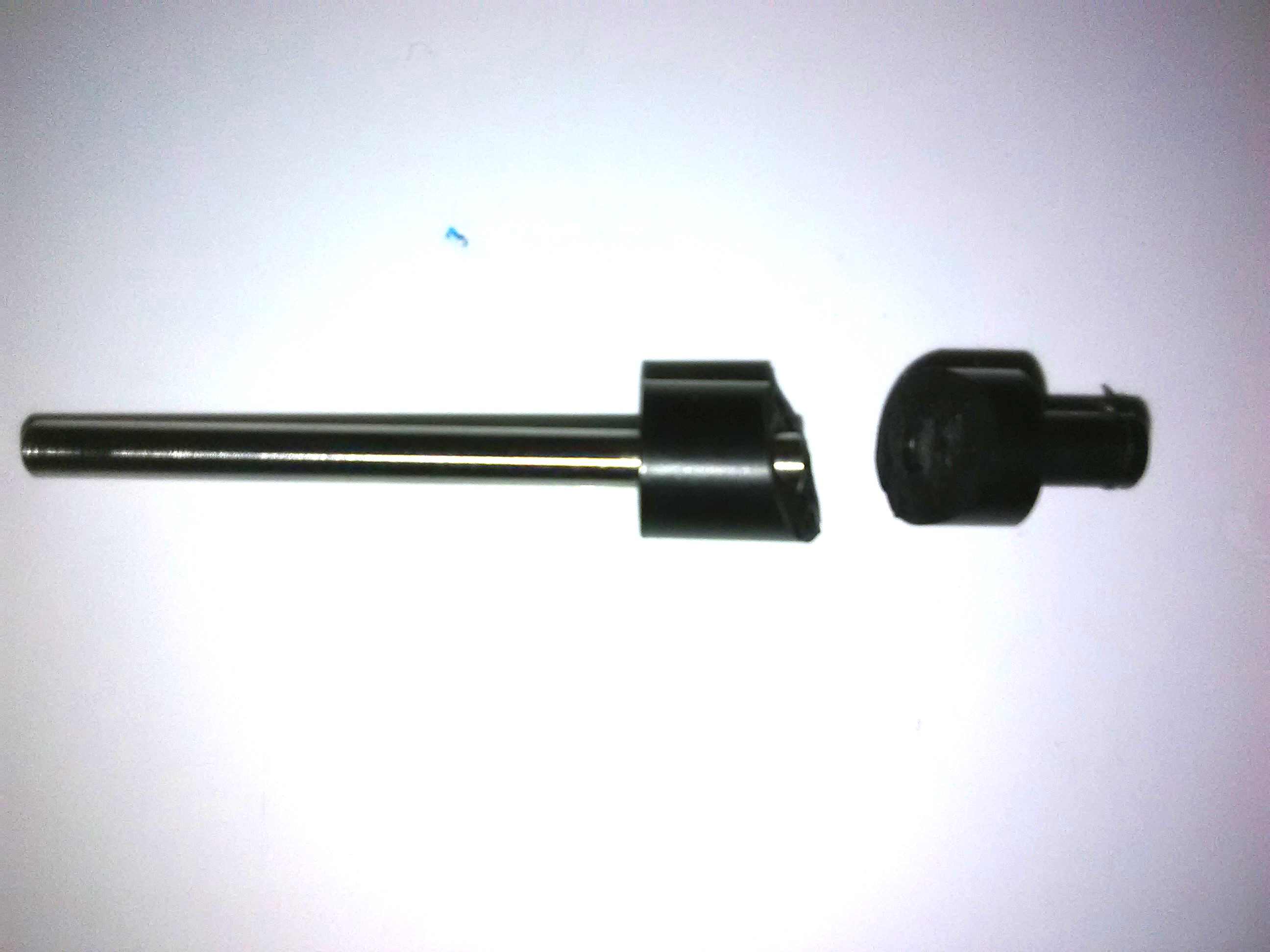

was dialing in a used .22 ben marauder and after about the 3rd shot air started leaking from inside the breach. guessing its that little o-ring just inside the breach? when bolt is closed it leaks out the barrel. put finger over barrel and its coming from the breach...gotta be that little seal right?
Same happened to Airacuda Max. Broken poppet. WM
You will have to degas and pull the gun down to change the poppet. Might as well put in all new seals. The entire valve assembly is pretty cheap though changing a poppet is nothing at all.

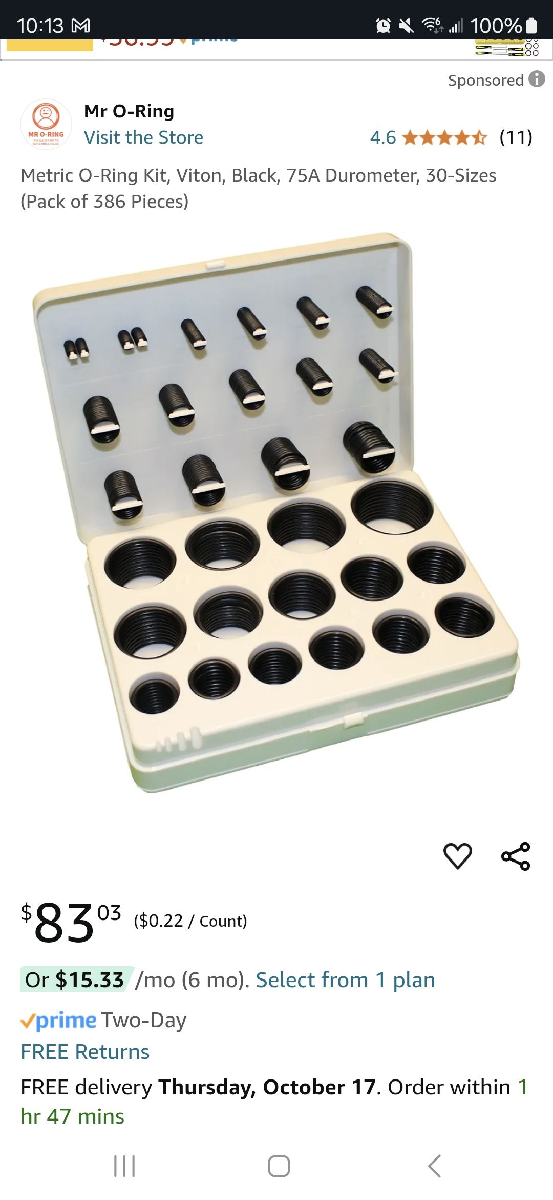

That'll cover most all of em from ben, fx, hatsan etc then? About to order some for sure.
Those are Benjamin M-Rod part numbers from your owner manual cross referenced to standard O-ring numbers. I have no idea about FX or Hatsan.

Oh I don't have a manual but I got ya. I'm looking something with a wide range kit like this so maybe it would have a lot of the ones if I need on other guns 🤷‍♂🤔 I have sets similar to this but they were for sure not the right sizing/thickness 😅
VITON is the WRONG material .... you want BUNA and @ 70 duro hardness
