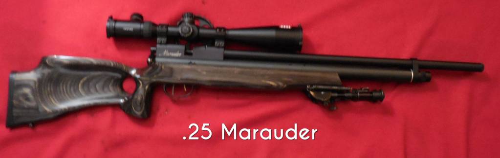

I really like my Marauder(s) though I have since went the FX route for more power and modern features. I guess I can still call my .25 cal a Marauder. I have a lightweight air tube that makes it 5.5 lbs. without a scope and have a Cobra valve in it along with a regulator and a MDS hammer and a twin spring system. I have it ported to .220" and tuned to 55 FPE. I also removed the choke and added in more baffles to fill in the gap. It's a pretty sweet shooter and light to carry with the LW air tube and synthetic stock. Most of these mods are not available now so I am glad I got into modding it when the getting was good. It's a great gun for quick work and to take a break from the mighty power of the FX with. I also have a .22 cal Marauder that is also modded with a LW air tube, MDS hammer and such plus a MM Hammer forged barrel. I think the Marauders are great guns that have good steel and are super easy to repair and should last a very long time with their basic design. It's hard to go wrong with a Marauder, but there are other guns now that better compete with it as far as side levers and such. When I bought my .22 cal it was the cheapest repeater gun available at that time and was my intro into PCP air guns.
I purchased a 25 Marauder last July. This was my first real airgun beyond a Crosman 760 decades ago. Luckily mine came with a very nice wood stock that looks like a type of walnut.
It is scoped with a Hawke Vantage 4-16 x 44 with Mil Dot reticle - which I like very much.
Other accessories added:
Hill Airguns barrel band
Hill Airguns matched parts kit
Huma regulator
Hatch 2" Picatinny Rail
UTG Recon 360 Bipod
Overall weight with all of the above is > 10 lbs, which is fine since I do not need to carry it far.
I removed the "lawyer spring" from the trigger and followed a youtube video to adjust it - which was a major improvement.
The gun is tuned to 44 FPE with JSB 25.39 Exact Kings (885 fps). This meets my objective of 25 FPE at 75 yards, and achieves a reasonable balance of accuracy, trajectory, shot count, and cocking effort.
When I do my part, groups at 50 yards are < MOA - often one ragged hole - and are just over MOA at 75 yards off of the bipod and a rear rest. My feeling is that the groups could be tighter if I was more consistent! FWIW I sort pellets with a Pelletgage and by weight.
With a 50 yard zero, two Mil Dots elevation is needed at 75 yards. At 25 yards groups are 1" high, so one Mil Dot low. When magnification is set at 11X (i.e., fudge factor) trajectory matches what is predicted by Chairgun, so I can use the Mil Dots and not change scope settings.
Tim Hill was extremely helpful in helping me get the Marauder set up and also for resolving a few issues along the way.
For me the Marauder has been a great PCP to start with.
