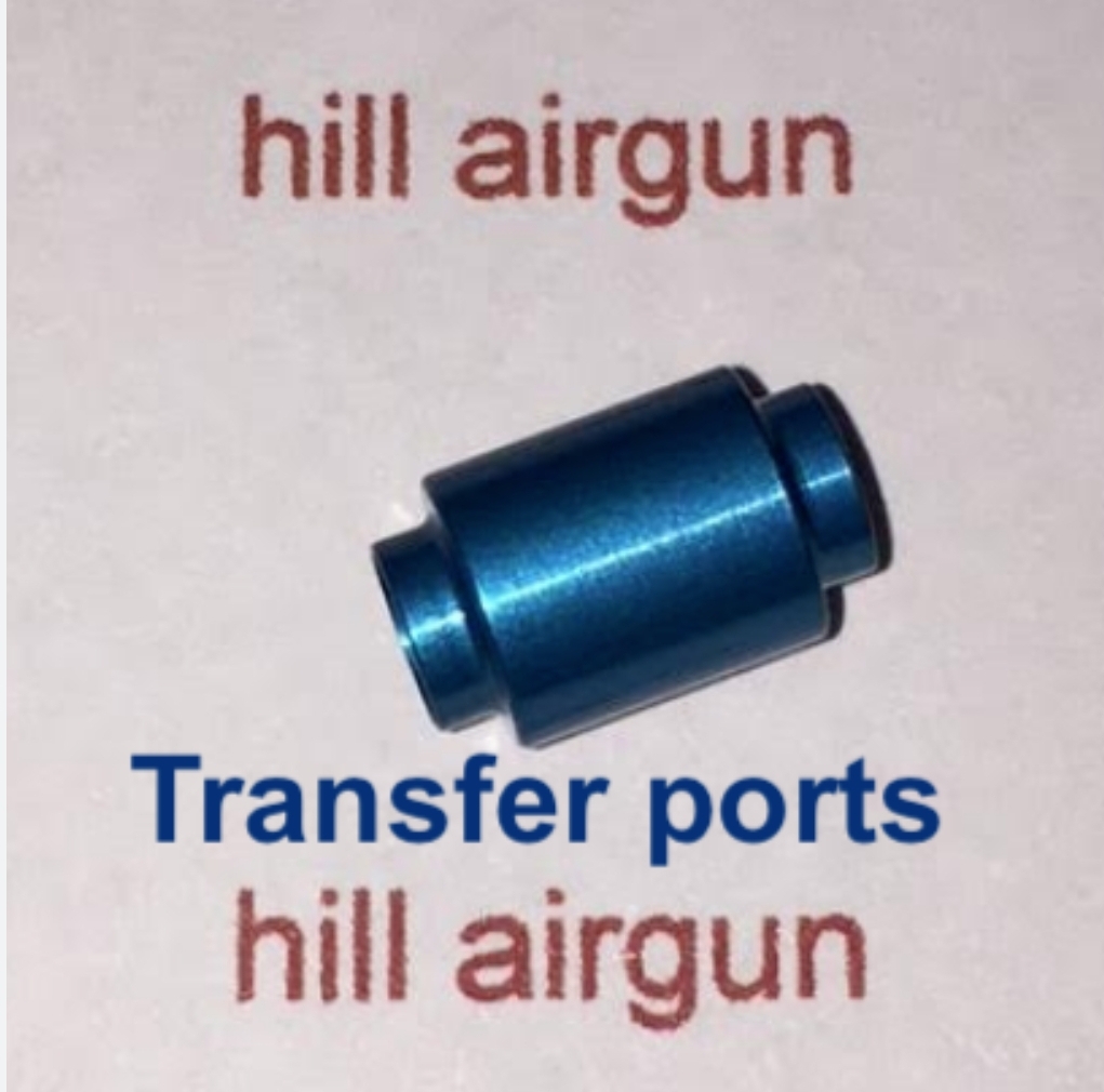

Hill makes 7075 aluminum port i installed the entire kit tons of power new valve port hammer everything

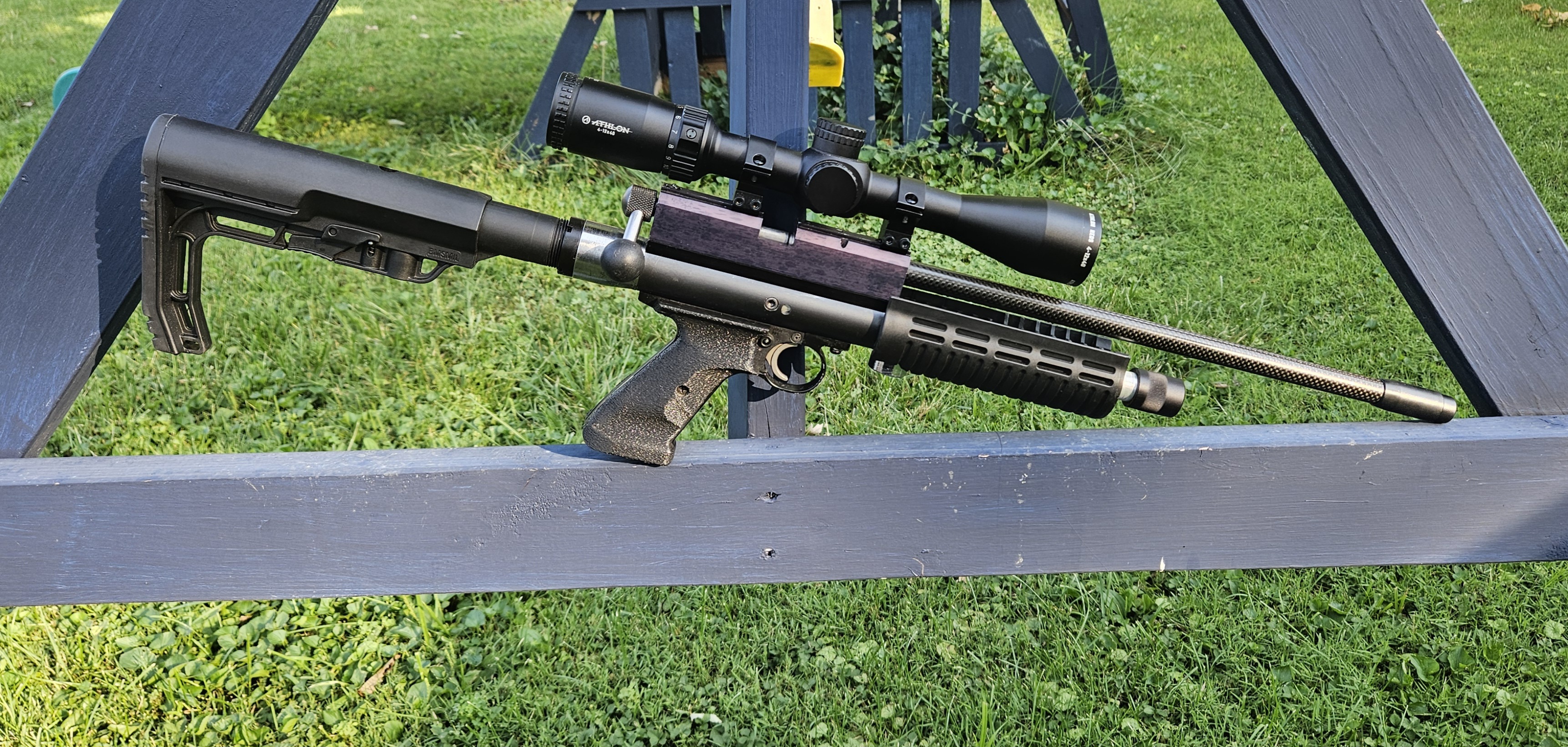

Yeah so I was actually wondering about his big .161 trasnfer port for the mrod rifle vs the 1/4 tubing the 1/4 tubing is .170 is the 0.9 difference gonna make that much difference in power? I can modify my stock valve to make a ton of power I have a marauder .22 that's doing over 40 fpe with 15 grain pellets valve port drilled and polished to 0.205 and barrel port drilled out to .166 and breech port drilled out and polished my .22 mrod actually uses a piece of tubing with the trasnfer port inside of that. I know the tubing seals good but not as good as the metal trasnfer port with the 2 o rings. My plan was to build a 100 fpe .25 marauder drill the stock valve out to 0.250 and barrel port to 0.220 and use the .161 hill trasnfer port I believe a stock .25 mrod trasnfer port is .140. Also I'm going to machine down the bolt probe in the .22 and .25 the bolt probe covers up about 60% of the air flow when you machine it down you'll gain about 50-60 fps extra also I run my valves with no return spring and no end cap. Also will be getting a 18 pound heavy hammer spring for my .22 and .25 and the air stripper will be drilled out bigger in both of them too it makes it way quieter.

I tried them all and they worked great i just liked the aluminum one because it was aluminum and i had so much power anyway 100 fpe shooting slugs it was good enough for me i even dialed back a little

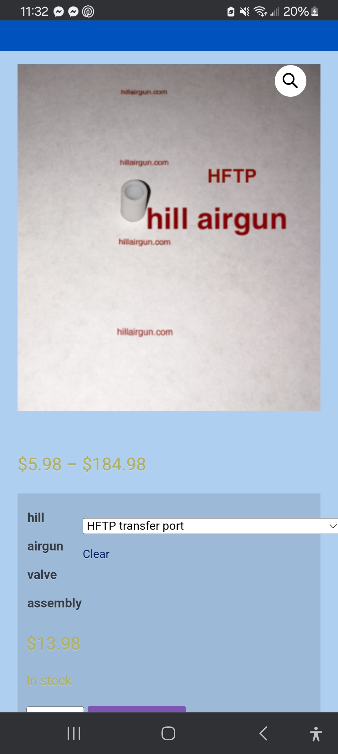

The Hill Teflon TP does work. It has about as large an ID as possible (well, not entirely). It is a single use item as it may not seal up a second time. It may take a number of shots for the TH TP to form and seal. Maybe 20 or 30 shots with heavy pellets.
