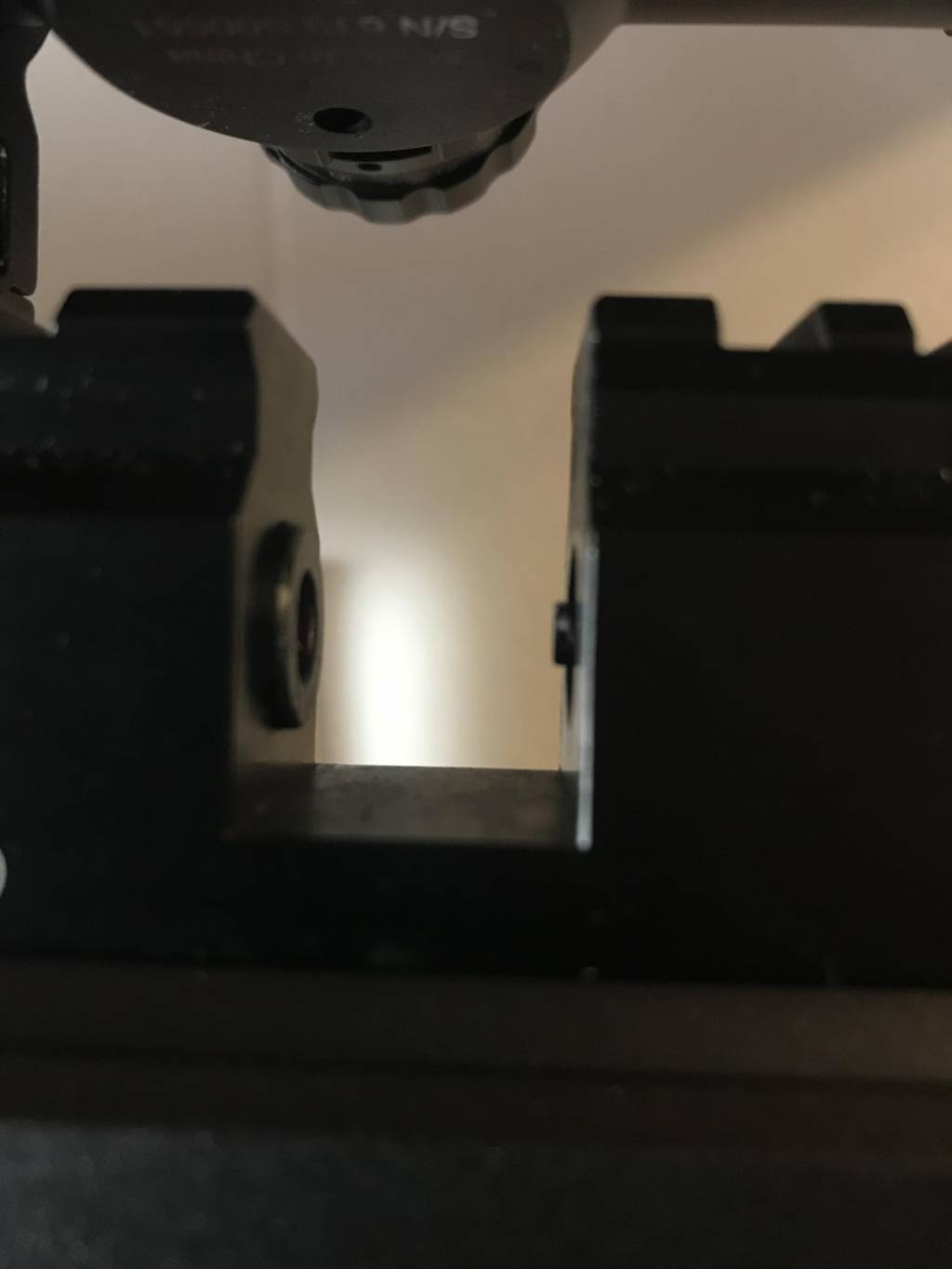

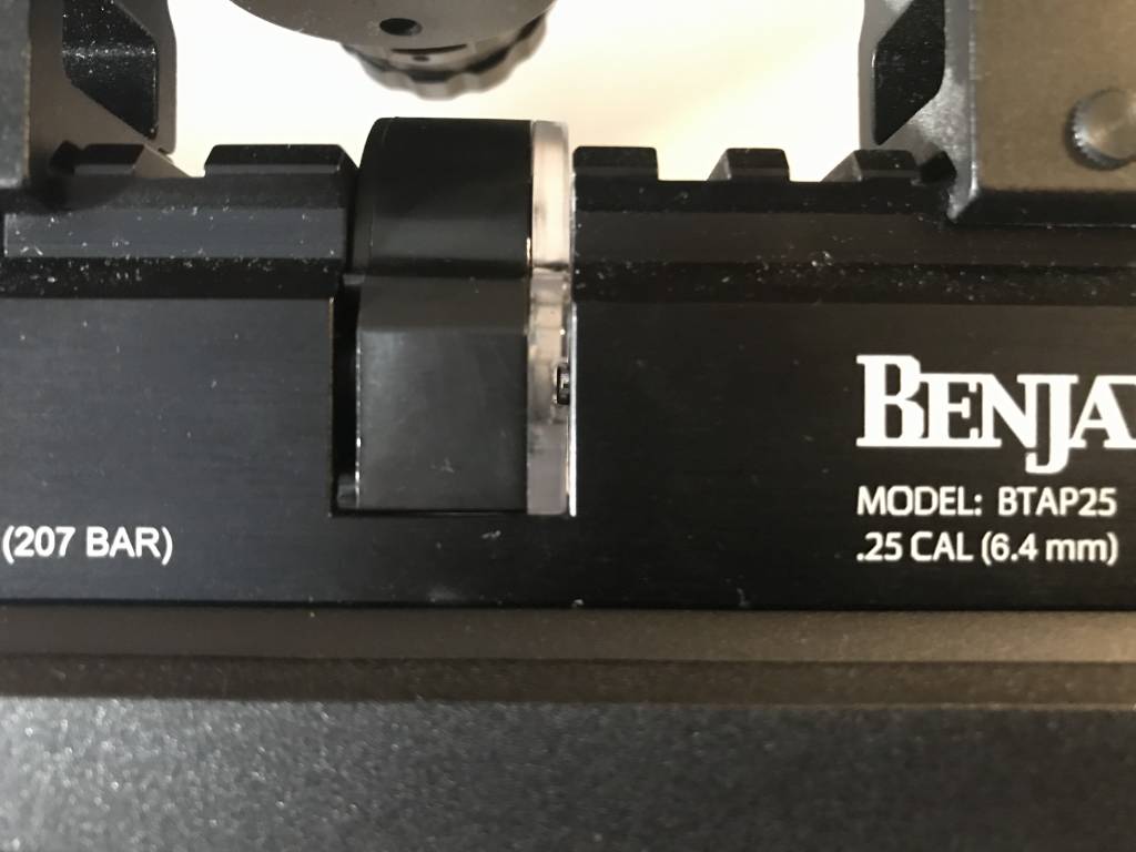

How far is the probe sticking out when the gun is cocked? You can try to minimize it by removing action from the stock, loosening the three trigger assy mounting screws, push the trigger assy toward the rear, and re-tighten the three screws.

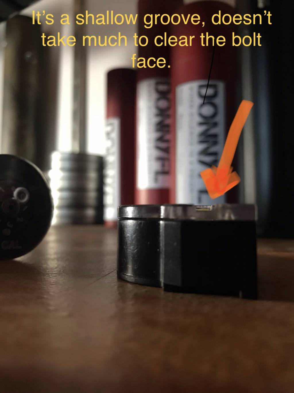

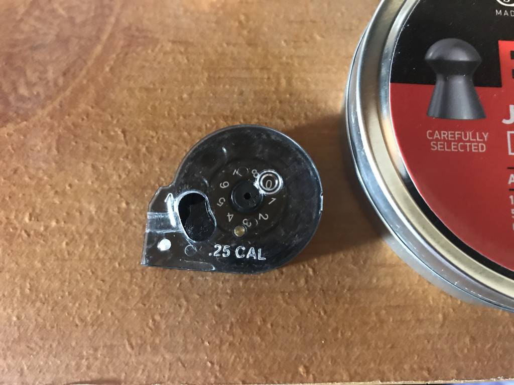

Super easy to work around that issue with a very minor bit of work on the magazine. Using a small flat file or a dremel create a shallow channel to clear the bolt face when inserting or removing the magazine. Super easy super simple. It affects nothing else. Just go slowly and don’t remove more material than needed.
