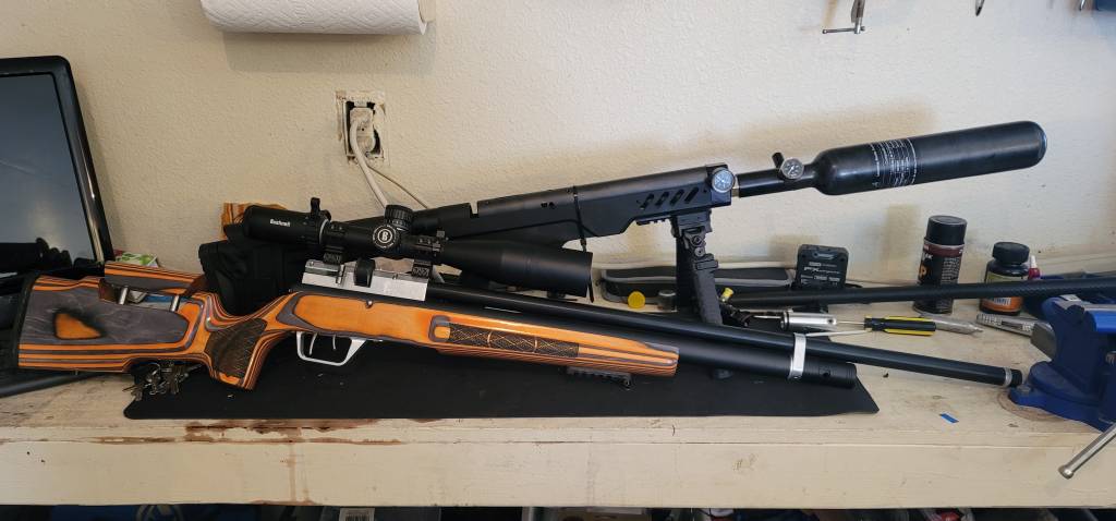

I would liike to hear from other marauder owners on their experiences. I have been building a custom.25 marauder. It's a bottle conversion, regulated and I'm trying to achieve about 100 ft lbs (shooting 55 grn nielsens). To get the velocity I'm looking for, i have the reg set at about 165bar. I'm running a drop in valve from jsAir, but I've also run a cothran valve. The idea with the balanced valves i thought, was to be able to open them easily using a light hammer and very little spring pre-tension. In my experience though I've needed a lot of spring to open the valve enough. I'm 6'1 230 lbs and pretty fit and it's really hard for me to cock the gun. Has anyone here had experience with either of these valves, or maybe has som advice on how to run this valve / hammer combination?
