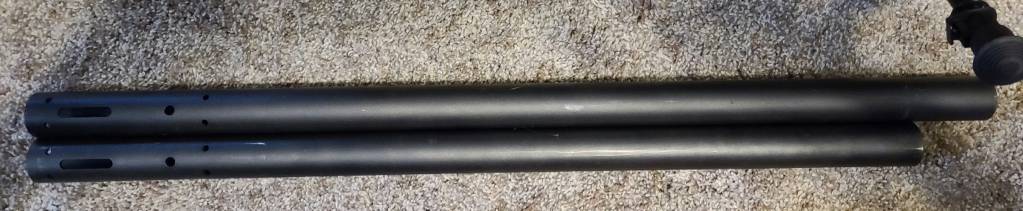

I'm sure most everyone knows that the F&T has a longer tube:

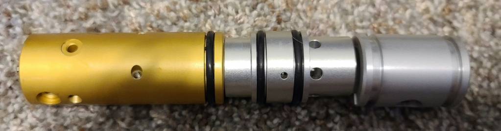

Here are the OEM components in order starting from trigger side on left:

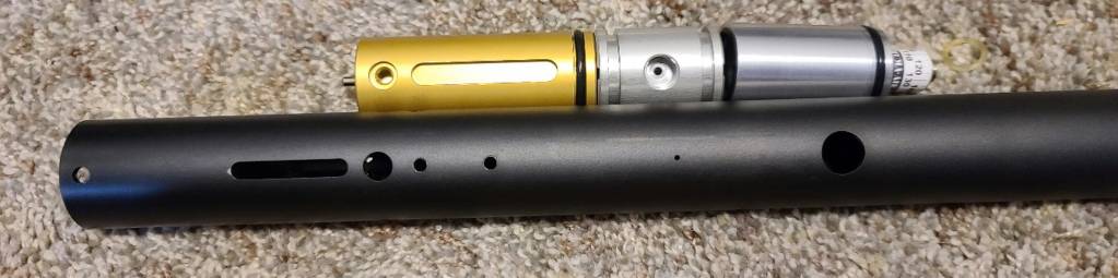

My plan is to remove the OEM regulator, and move the gauge port against the valve, then place Huma reg against gauge port. The vent hole for OEM reg is captured in the dead space between o-rings on gauge port and new "vent" will be original gauge port hole in tube:
*I want a separate gauge to monitor reg pressure. A Sekhmet digital is perfect as it can show me precise readings.
*Any possible air escape passages are still blockled off with o-rings except where the Huma butts against the gauge port. This particular gauge port has vent notches on both faces so I will machine one face so the Huma o-ring has a solid surface to seal against.
*The new gauge will be located on the right side of the gun for easy viewing.

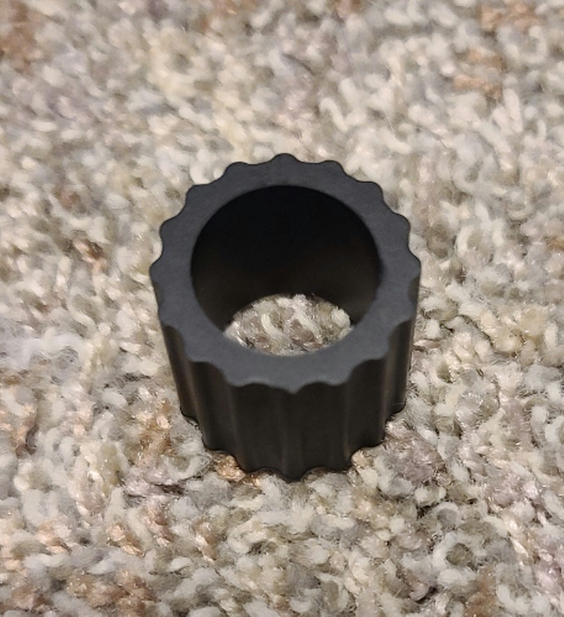

Does anyone know what this is? It was inside the air tube in front of the gauge port:
