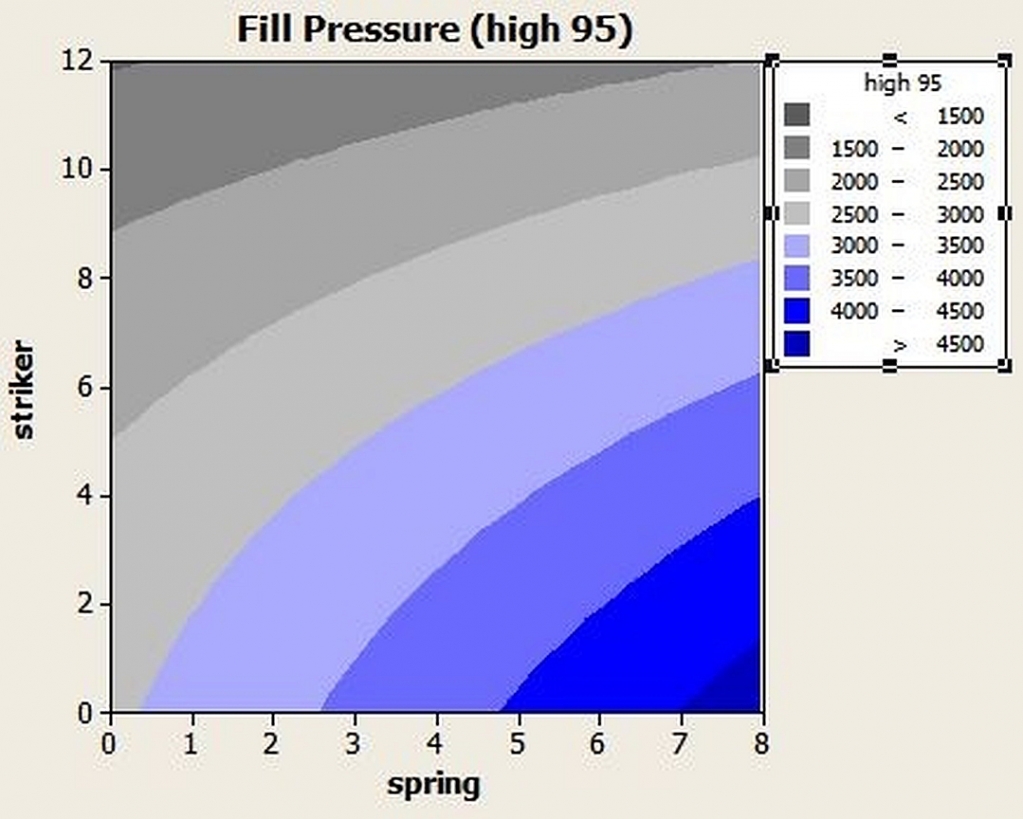

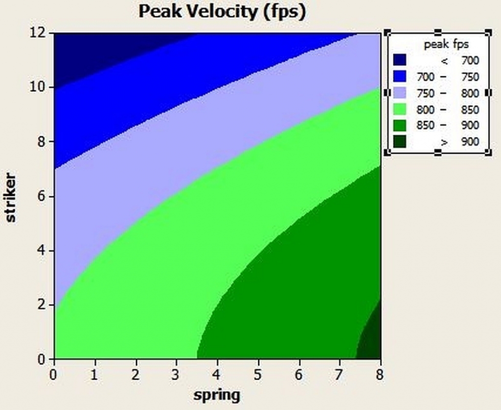

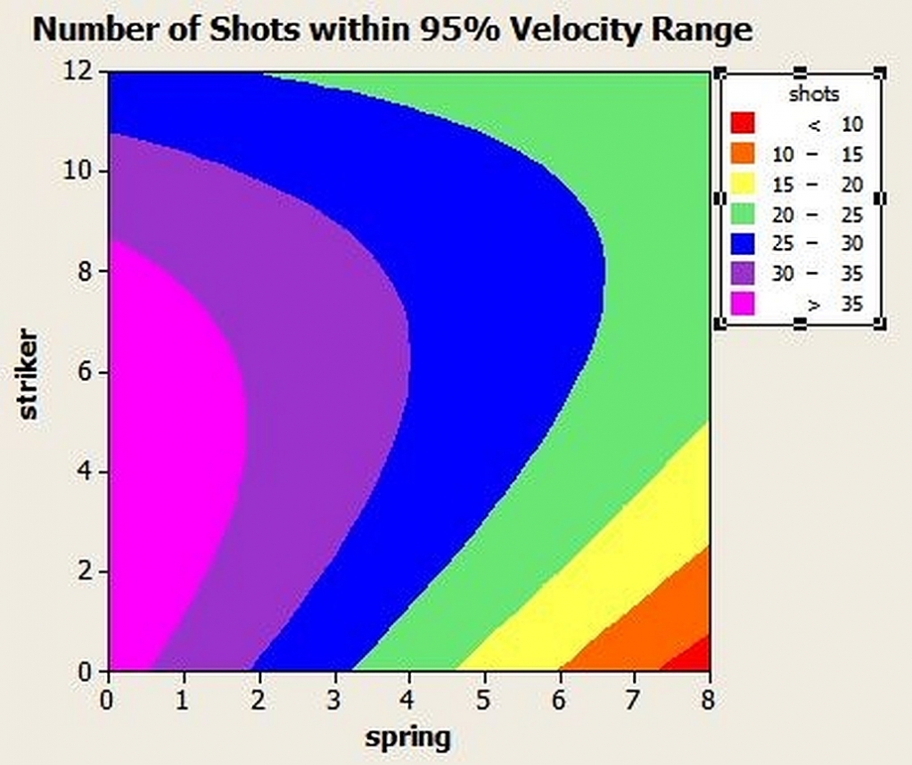

Check out this excellent work someone did to chart the result of every combination of possible spring vs stroke with their .25.
https://www.airgunnation.com/topic/interesting-graphs-of-marauder-strikerspring-adjustment-relationship/
1582422634_4902689085e51da6a7fab67.23093959_marauder spring vs striker vs fill pressure.jpg
1582422665_18631520995e51da89953c86.53295564_marauder spring vs striker vs shots.jpg
I believe that the hammer spring comes maxed out from Crosman and the hammer throw is all the way out giving it the shortest stroke. It just seems that adjusting the hammer spring doesn't do a whole lot . I got it down to 865, but the next day it was back up to 895 by itself. I guess the only way to reduce the velocity would be to choke the valve port like you mentioned. BTW, I have the Crosman barrel and unfortunately it doesn't like the original jsb monsters.
My FT Marauder .177 came with the striker way in. I didn't count the turns since the first thing I did was crank the rifle up to max to see what it had. Turning the spring all the way back took it from 930 with the heavies to 880. It then took 8.5 turns in with the striker to start having any further effect to get it down to 860. The transfer port will definitely reduce the power anywhere from there but it is a pain to hold still to get the locking cap back on without the adjustment moving. My .25 was going from 830 to 600 with the pintle all the way in.
