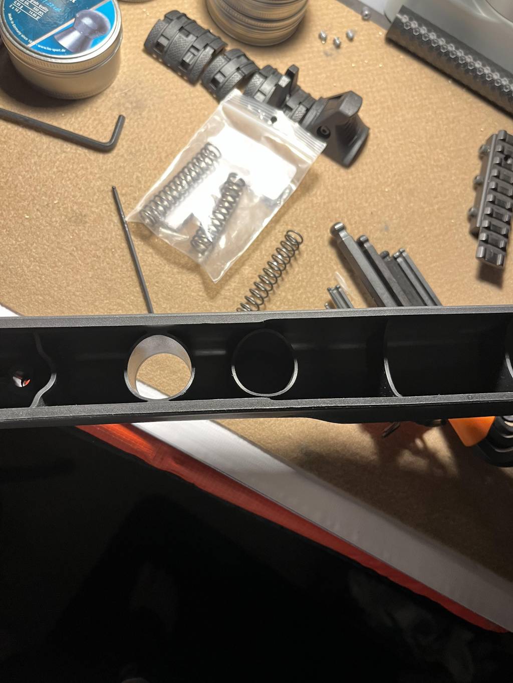

 The synthetic stock has a second supported gauge area that just needs drilling out. Can’t say I’ve seen or heard of anything for the FT model specifically.
Yes, the difference is the gauge location. You can plug and redrill new hole.
The new syn stocks have the dual locations as shown above. Older ones did not and made my own. The SAM stock is same as F&T.
