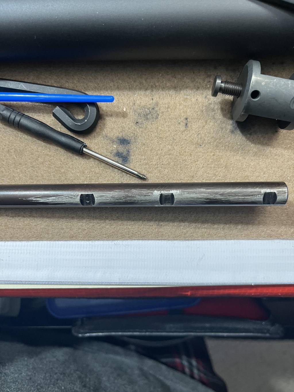

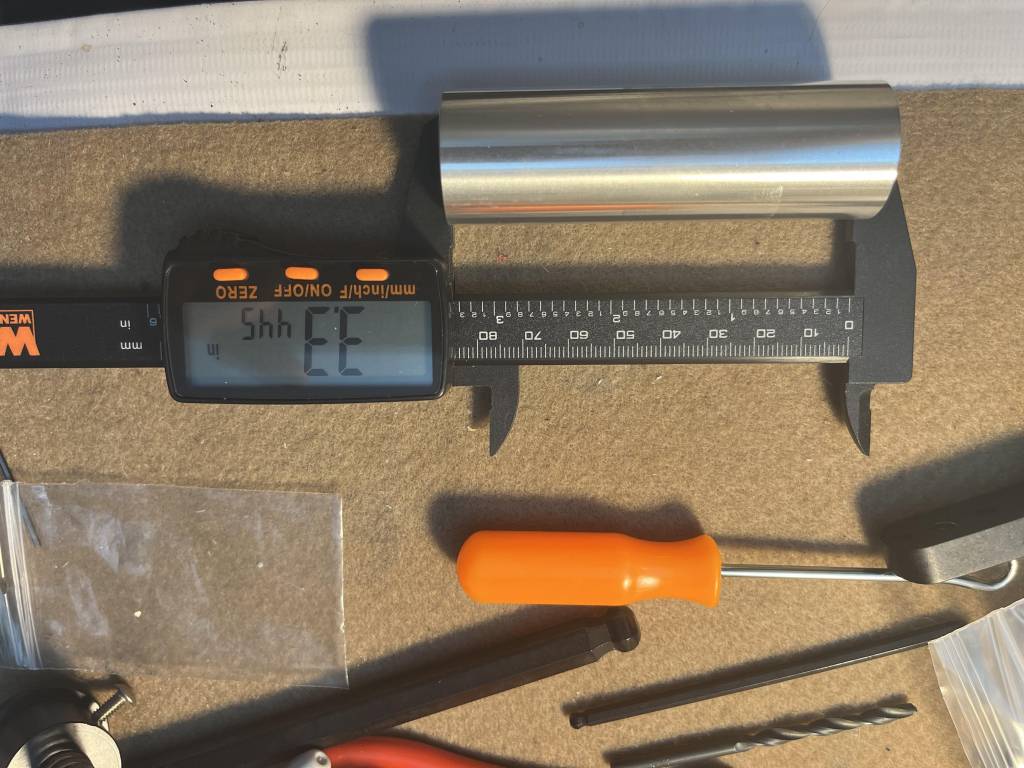

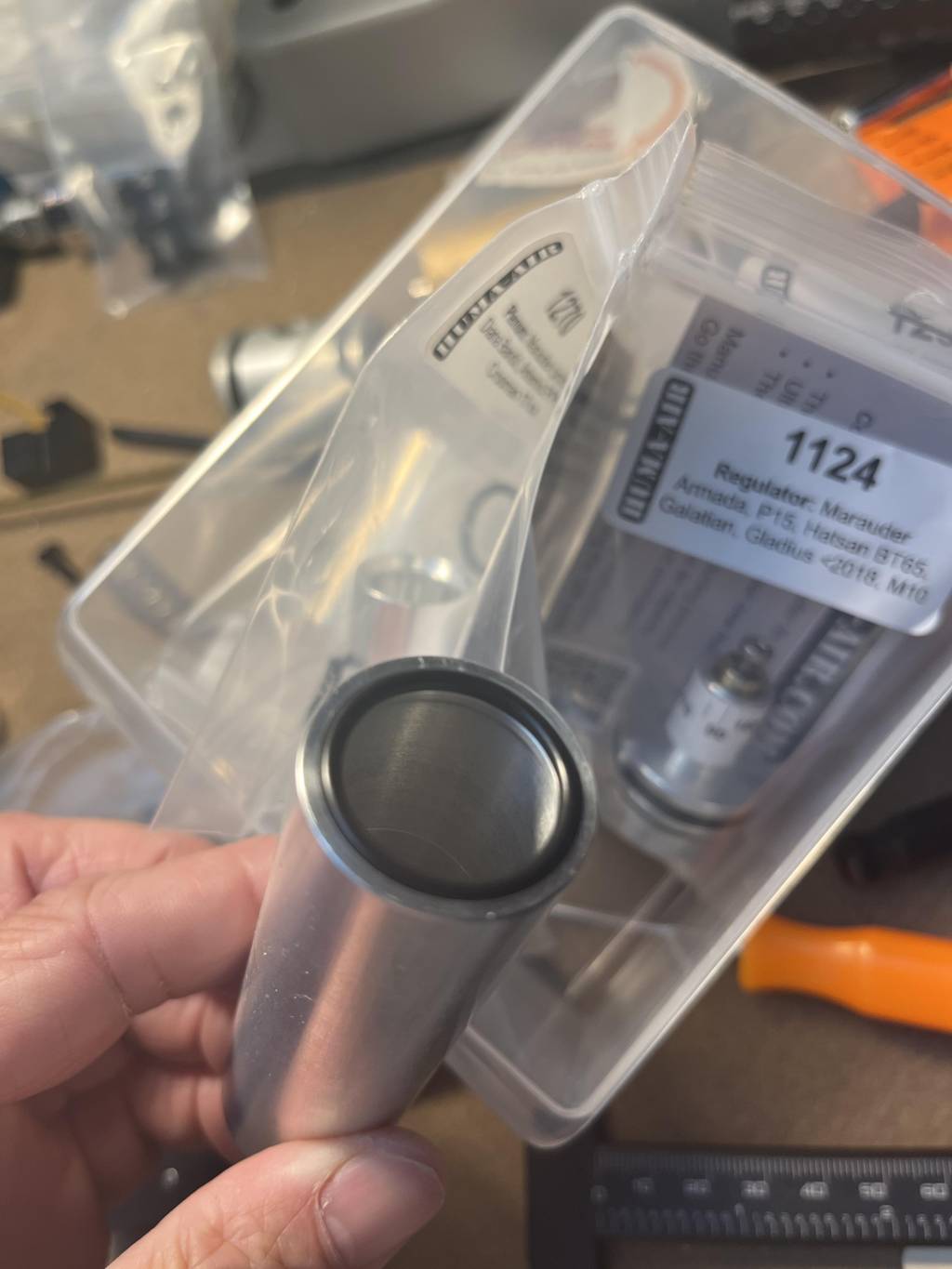

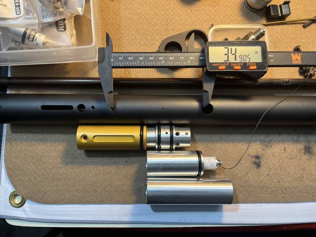

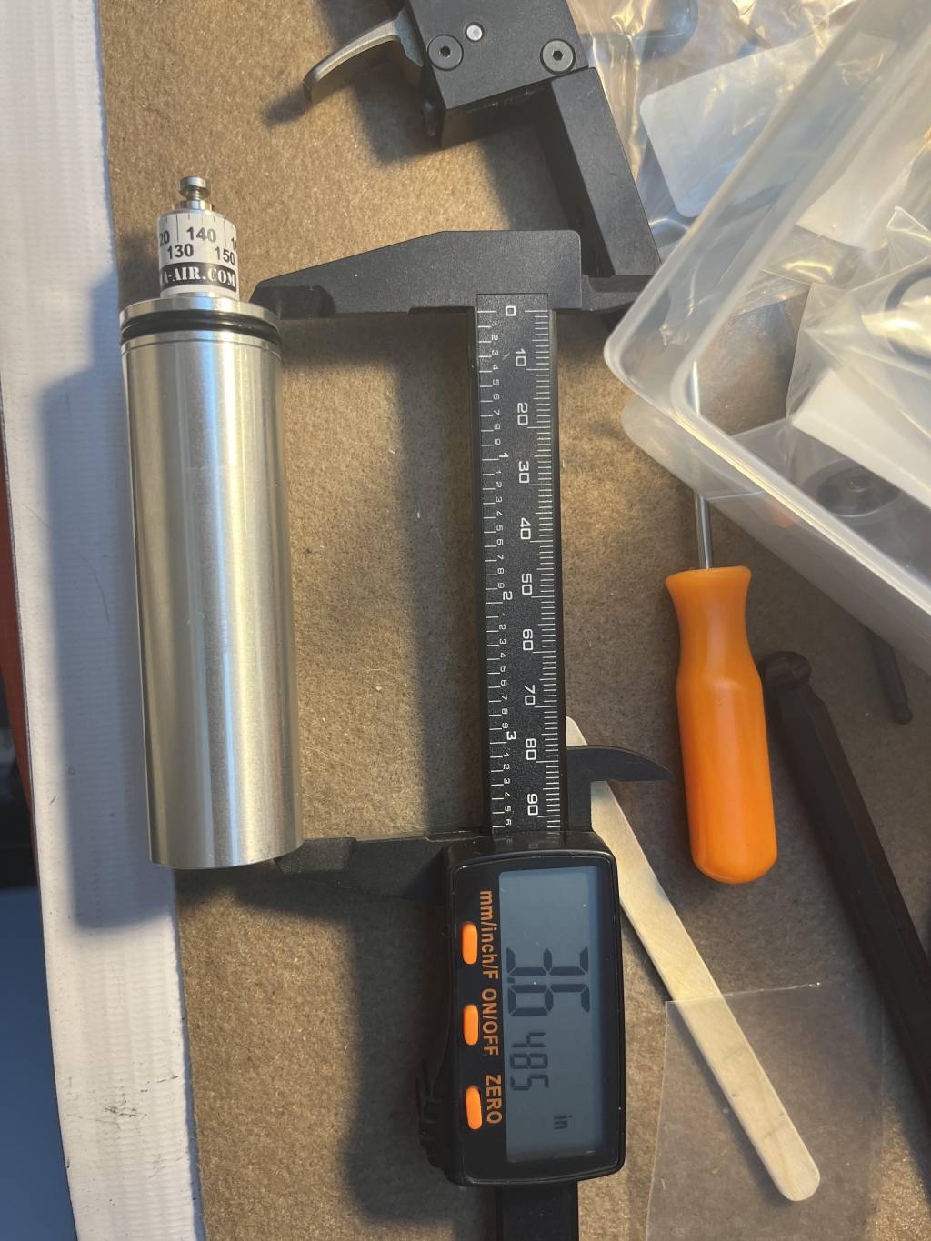

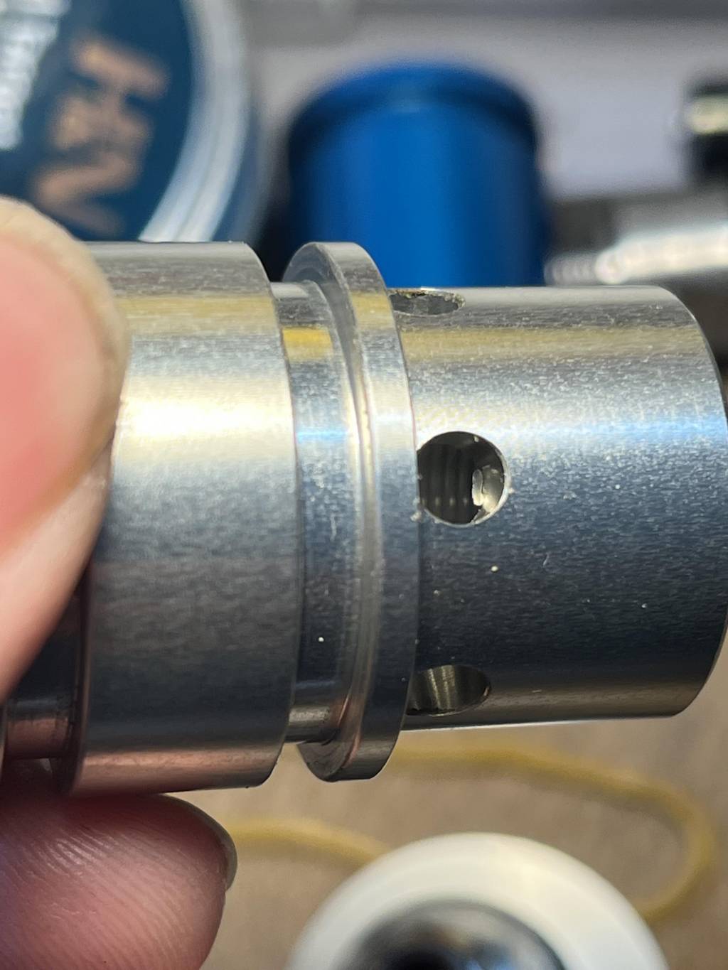

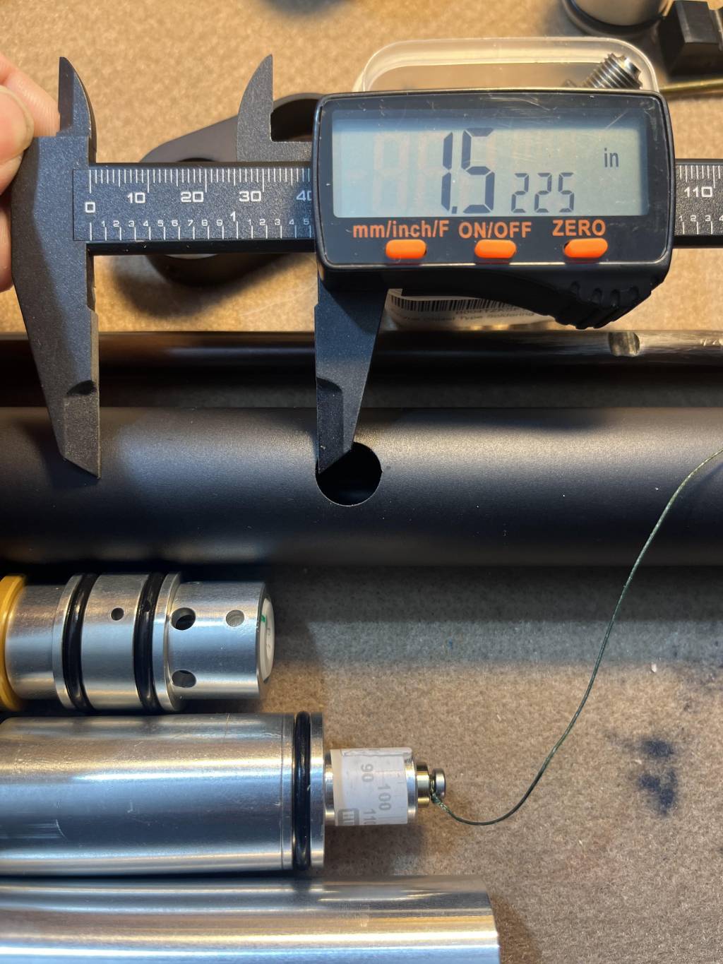

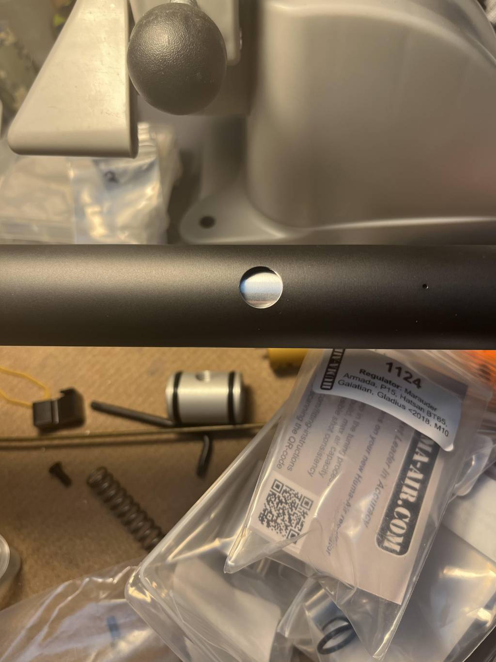

FT model in .177 shoots 10.3gr FX @ 885-890fps, factory tune. HS was 6, HT was almost all the way out, 11 turns. Crosman made a vent hole between the valve and the gauge port. Pic shows Huma m-rod reg, Crosman factory reg and a Huma XL plenum. Huma now makes a drop in to fit the FT, but the XL plemum will span the gauge port hole like any other m-rod. Measurements were made from the inside edges of the holes, vent is smack in the middle. Couple of sour notes though, metal flakes and crumbly aluminum dust were in the regulator, suprised it has not dislodged and clogged up a stem. Could be what caused another user’s post about a bad regulator (?) Barrel was scratched to hell at the breech, and the baffles must be glued in the shroud in the FT model, my .22 FT has lodged baffles too. Other posts already about the baffles. Crosman support has no clue, told me they should fall out. Barrel shoots really well without touching it, so im not gonna complain much about scratches. Wont matter by tomorrow, adding a Huma reg w XL plenum, Hill regulated parts kit w 255 HS, 7 VS and PEEK striker, Barrel polish and h-BN treatment, SS screw kit, and replacement shroud w/o baffles.

Thanks! One note I forgot to add is that some the grey aluminum dust was past the plastic nut in the regulator, the pic shows the nut removed to see the dust better but there was in fact some past the nut. The stock screw was roughly drilled out too, had some sawdust on the trigger housing.

Thanks for the details on this. I don't have a F&T, but have a SAM that uses a similar air tube and reg. I am looking at options to bridge the vent and make the plenum larger.
I don't have the XL plenum. Could you answer a couple questions on it?
- Does it have surface O-rings that seal against the face on both ends?
- What is its length and ID?
- Does the crosman reg fit in the end such that it will seal against the middle section?

Never seen those kind of scratches on a Mrod barrel. Some kind of burr in the breech? Set-screws not out far enough when installing?
Crosman put a fix on the regs to keep the adjustment from moving. A side hole with some form of locktite. This may be one that was fixed internally, before new built regs arrived. ie aluminum chips.
XL plenum is for the Huma regulator, removing the Crosman reg and gauge port altogether. There is one o-ring that seats against the valve and it does span the gap of both vent and gauge port. I checked the breech and no burrs to scratch the barrel. What I cant figure out, maybe someone can explain it, is how the factory regulator works. Seems more like a constrictor than a regulator. Factory tune of 6 hs 11 ht made me scratch my head some. Apologies for the upside down pic.

You will definitely have big enough plenum for a 177. :) Not sure of the power level you are going for, but you will probably end up with a good deal lower set-point. Good info for those that want significant more power out of their 22 F&T. It would also support a 25 cal top-end. :)

I don't have means to make my own, but used modified gauge block to bridge vent on Fortitude when I converted to 25 cal. I will probably do something similar on the SAM. I also prefer having the gauge on the plenum.
