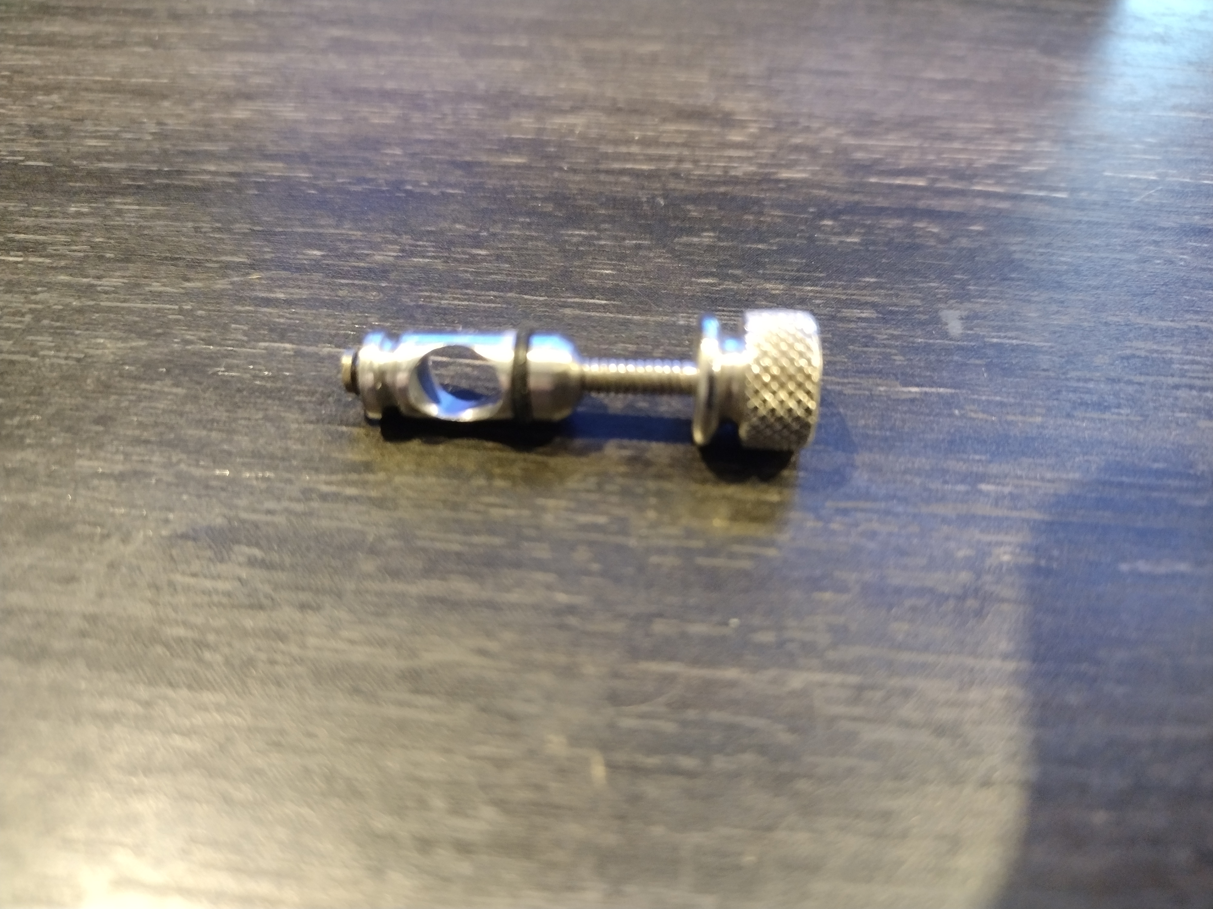

I found the stock velocity metering screw on marauders lack luster, requiring an Allen key to adjust, while being limited on how much it can restrict with large ports, I decided to add a quarter turn transfer path adjuster as many modern pcp's have. (Plus I shamelessly epoxied my VMS bore ages ago as it was the in thing to do at the time). I have another unregulated marauder that I may keep the stock OEM setup, but probably not.

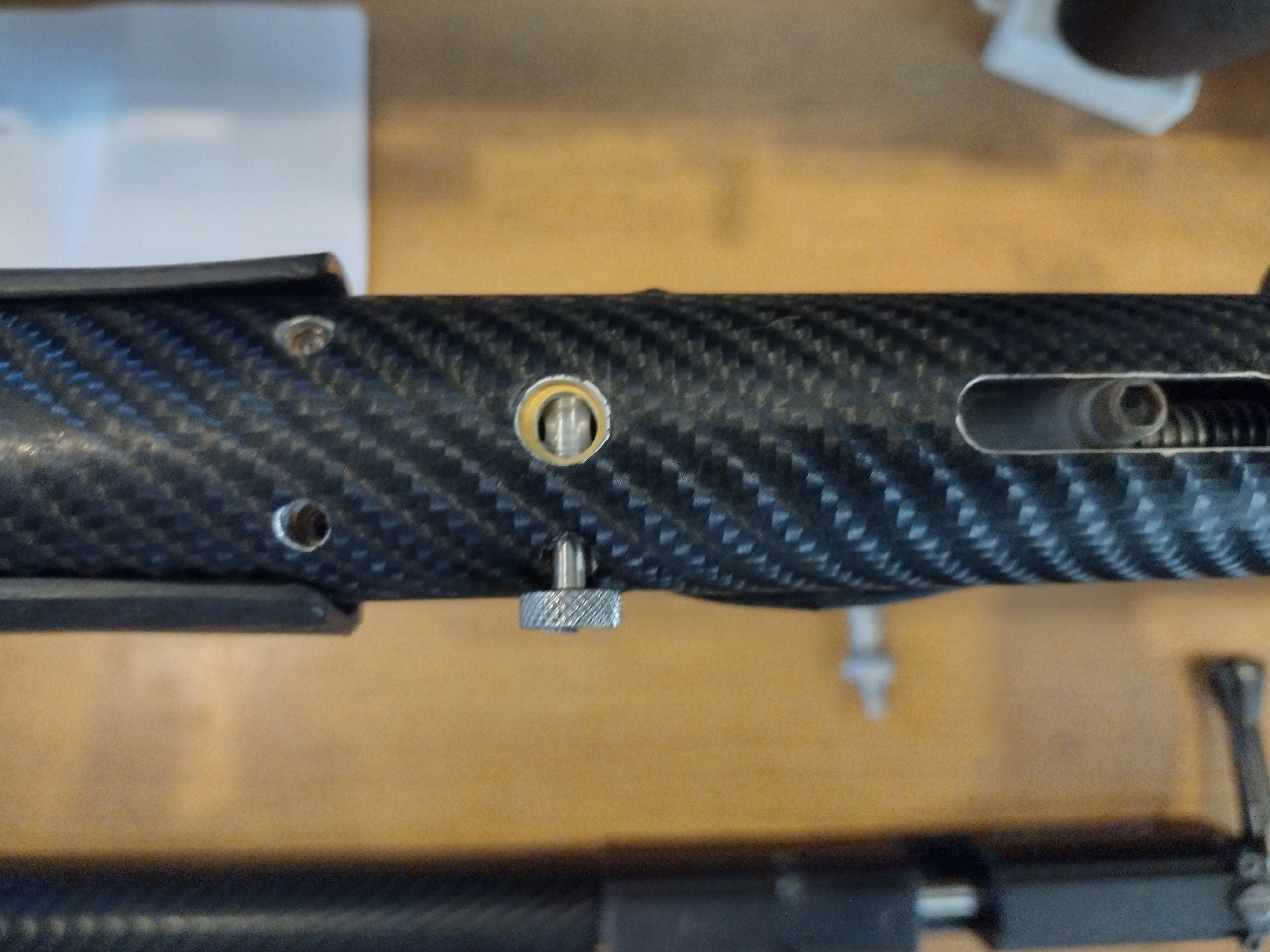

The adjuster I fabricated is made from 7mm stainless steel tube with 4mm ID, opened up where it matters to .235"x.215" for a perfectly blended .225" exit port going through my valve. It's retained by a 4-40 screw and the knob is also 4-40, both of which were pressed inserts jb welded on either end of the 7mm tube. The adjuster is designed that in event of failure, the adjuster will remain within the air tube opposed to being ejected. Its wicked how well the adjusters port blends into the existing valve porting (seen below), one can barely tell its present when fully open. I drilled the 7mm bore through the valve on the opposing end of the OEM adjuster as the magazine sticks out from the right of the gun, I thought it be best to avoid adding a knob right next to where the magazine protrudes from.
The 7mm bored hole leaves less than 1mm between it and the .238" throat I run, as well as roughly 1mm between the valve exit port and the valve seats lowest point AND roughly 1mm and change at the top of the exit port, meaning there is very, very little room for error in placing a 7mm hole into a marauder valve ported to .23" for a tp adjuster. Going just .03" off in one direction means you're breaking through and ruining a valve, or impeding air flow through the throat. I did only use a hand drill, but I ended with a piece of 80 grit sandpaper rolled around a drill bit to really dial in the last hundredth of an inch for placement.

The knob matches my rear hammer spring / ssg access knob that I use to change my ssg carriers on the fly, also matches my stainless probe. I like how the dial indicator hash marks and numbers come close to matching the stock marauder engravings, I do wish the black was a little less glossy but I don't mind it having a little pop.
