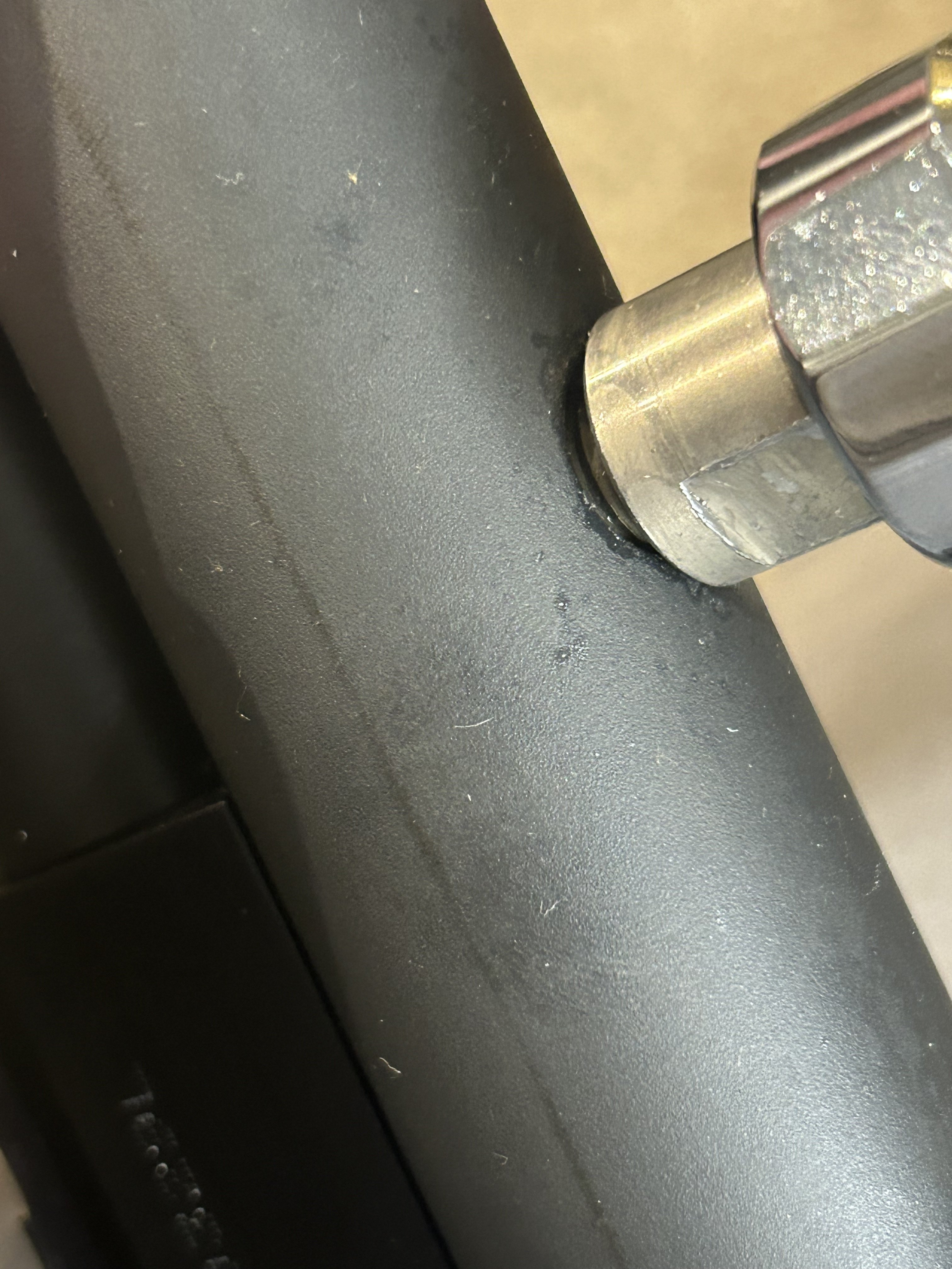

Gen2 marauder. Putting in a huma reg with gauge port. Air leaks at the fitting of the extension going into the huma reg itself. Will this not seal? Ive used the stock oring and a white bspp seal and nothing seals. Ive tried all different combinations of gauges and seals.
Not sure its the gauge. I’ve replaced the orings on the reg twice and on the valve. Tried being super careful with lube and pushing the orings down n past the opening. Taking cautions not to damage them.
Could it be the reg itself? Seems like it has to be the huma reg body orings but im not positive.
It could also be o-rings on the regulator body itself, very likely cause as they nick easily when passing that hole.

Bramezy, that's a tough spot to diagnose. I think I would see if I could remove the guage extension and install a pipe plug( if you can find one with matching threads). This way you can carefully apply soapy water with a syringe on your targeted areas. I agree with Stubbers that you could have nicked or rolled the regulator body to air tube seal that is most rearward(if you installed the regulator from the fill end). Its easy to do, especially if you hadn't lightly de-durred the guage hole in the tube.
Reactions: Bramezy
It's also possible that the leak could be from the internal o-ring in the regulator that seals the regulator body to the plenum itself. Those rarely get damaged by us, as it is internal, but if it is not sealing right the air will leak past it and out the gauge port hole.
That's the tricky part about air coming out that hole - it could be from five different places, even though it all flows out there. It could be the gauge port seal, the front and rear seals to the tube, the internal seal to the plenum, and lastly from a failed regulator out the atmospheric vent hole. Good luck!

I tore the reg apart and found a hard and cracked oring.

Yes but there is no gauge block, there are two orings on the outside of the reg. I tore the reg down and found a hard cracked oring inside. Hoping thats it. Ordered a rebuild kit from Huma 3 days ago but no contact from them over multiple emails. Be nice of a US source for these.
