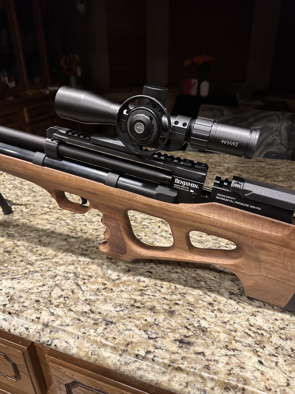

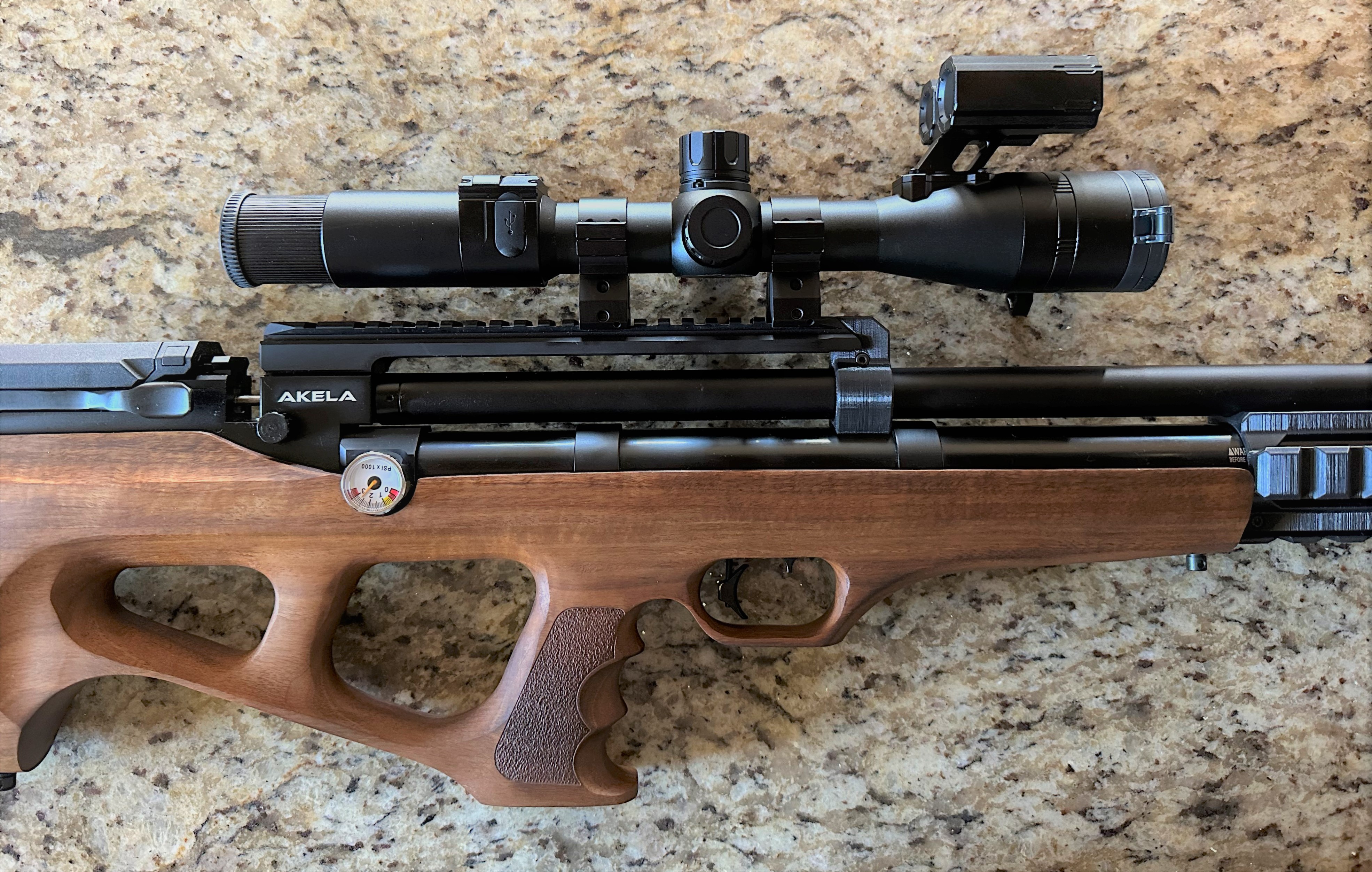

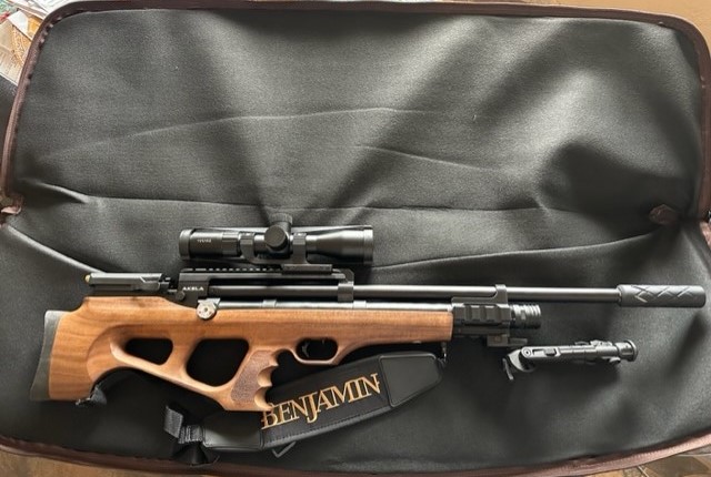

If you like the looks, feel and personal purpose of a bullpup, the Akela is a great choice. 1/3 the cost of an FX Wildcat 3. I have done nothing internally to my .177 Akela (though I did buy a Huma Air regulator for it, which I will install one of these days, following the youtube video of Sub12 Airgunners. Buck Rail has a couple of accessories I added. I also bought his moderator, but the threads do not work. He replaced the first one, but the second is still bad. My rifle is very accurate and trouble-free. I consider it a field hunter/pester and have fitted a PARD DS35 thermal imaging scope on it. Fits the Benjamin case like a glove.

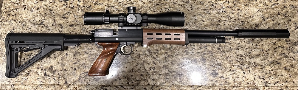

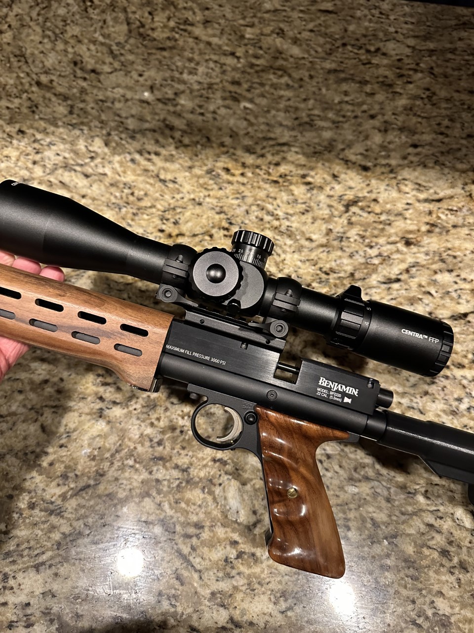

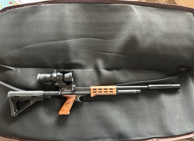

I should have mentioned my P-Rod is the perfect backyard friendly Starling/Grackel eliminator in .22 . . . I have a soft spot in my heart for Benjamin air rifles. Dating back 60 years to my childhood. It is the first gun I grab when my songbird feeders are overrun with Starlings/Grackels, or the odd fox squirrel. Turning it into a carbine is a popular mod. I also bought a Huma Air regulator for it, but have not yet installed it. It is very accurate, and the light weight MTC S.W.A.T. scope is a great match. It also fits the Benjamin case. Buck Rail has several mods for it.
