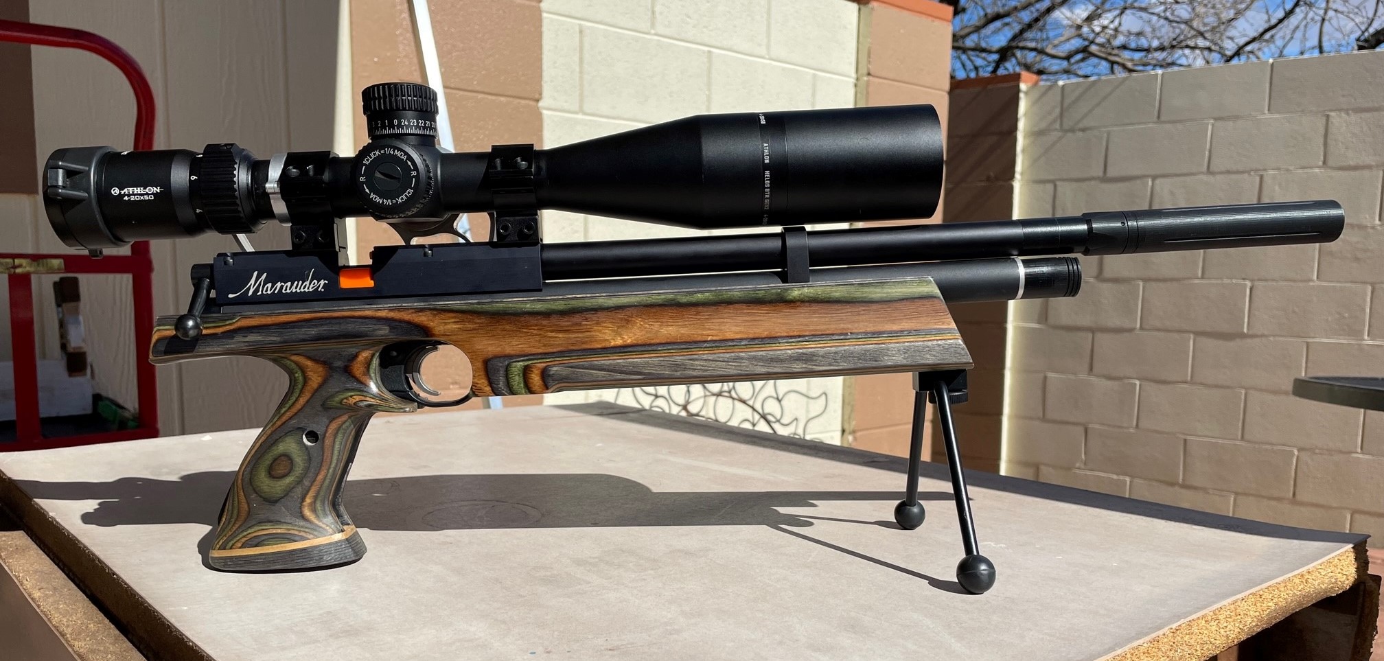

Marauder Pistol for PFT? Crazy idea?
Well, yes, the thread seems to have derailed from the original topic but all's good. Carry on.
Not much to report with the project. Have had snow and nasty weather till the last day or two so no outside airgunnin' going on lately.
Today I shot up most of the tin of Predator GTO pellets I ordered trying to find some speed the gun will tell me it likes. Might need to buy more. $$$$
So far the pistol's not talkin to me about a favorite speed.
I've shot them between 640 fps to 675 fps but I'm really trying to stay below the 12 fpe mark.
No good groups to report at 30 yards yet. Maybe I need to start a little closer and then move out from there if I find something that seems to be working.
I bought a tin of H&N FTT Green 9.56 gr to try also but they're not working real great either.
I have some JSB 13.43's sitting here I might try in the next couple days. Can't hurt I suppose.
I don't know this for a fact, but I'm getting the feeling that .22 pellets @<12 fpe may just be flying too slow to group accurately.
I'll keep trying and will report back with anything positive that takes place.
Take Care all........

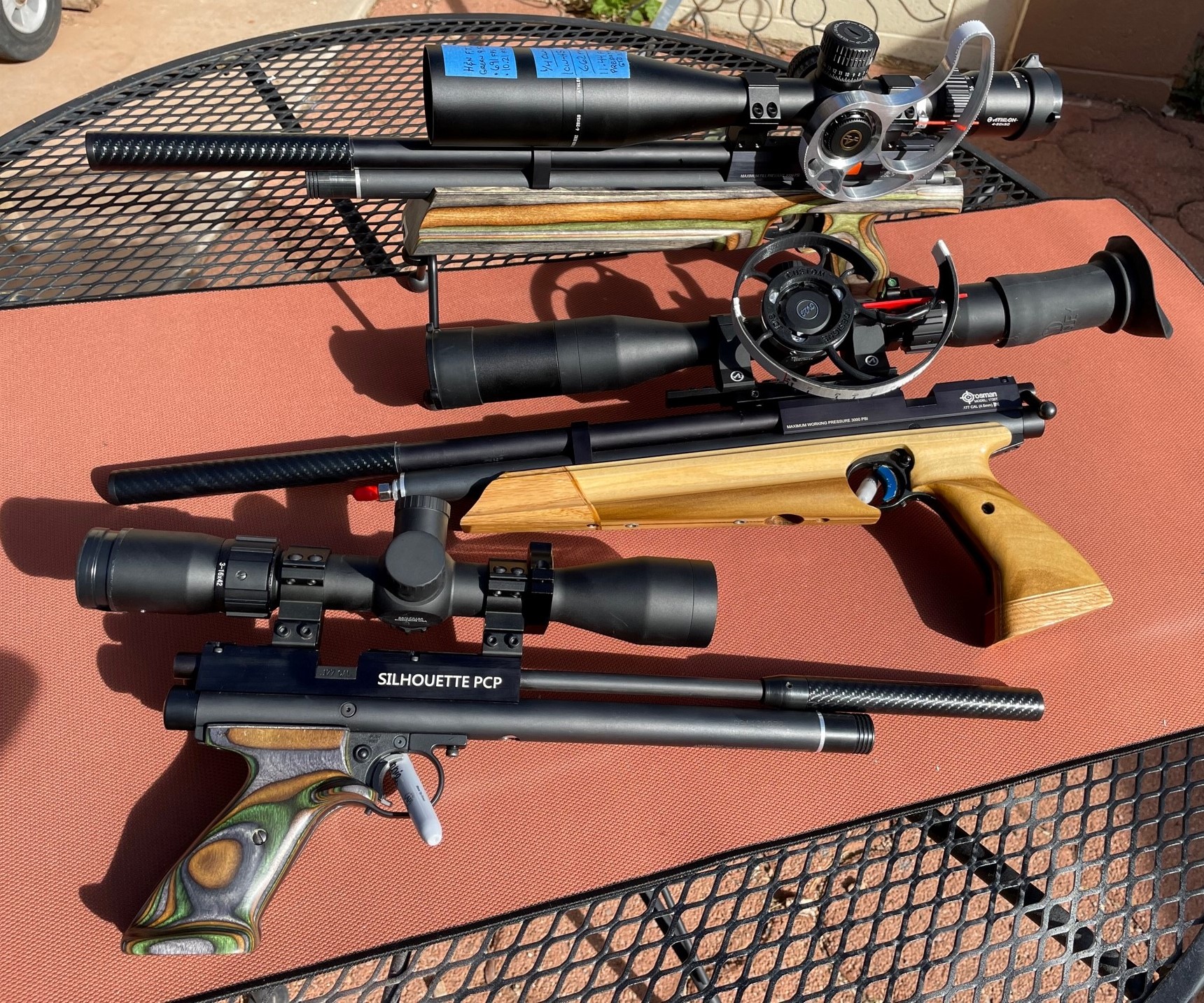

I've set up my 1950s vintage Crosman 180 .22 pistol conversion for AAFTA field target. By shooting 14.3 grain JSBs at maximum power, mounting the scope higher than I usually prefer, and plotting an intelligent zero-range, my point-of-impact is within .40" at all AAFTA pistol field target ranges to 33 yards, and only .61" low at 35 yards. See the 'path' column below for details.
The 1950s vintage Crosman field target pistol-
Close-up of the adjustable trigger mechanism producing crisp-as-glass 8-10 ounce trigger-breaks-

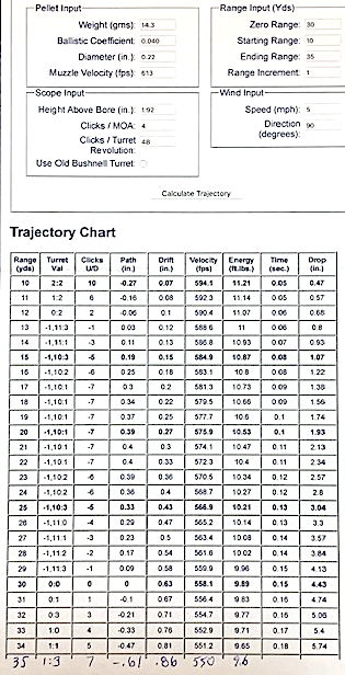

damn damn i need to learn how to graph and chart like that ? APP ?

What moderator are you running? Your rig looks awesome!
Hi Trout,
It is a TKO. Not quite as quiet as a Donny FL Sumo I have, but quiet enough for "backyard" and certainly looks better than the "soup can". ;) Plus, Mike at TKO is a great guy and very interesting to talk to.
The stock is from Steve Corcorran Woods & Water. I originally bought it to use for FT on my 1720T but discovered that I screwed up when I purchased it and that it was really intended more for benchrest than FT. I have what I believe is a Vernon Austin on the 1720T now, so the green laminate stock was just sitting here. That's a little bit of what prompted me to start this project. Maybe I'll get the 3 guns together and take a picture and post it here.

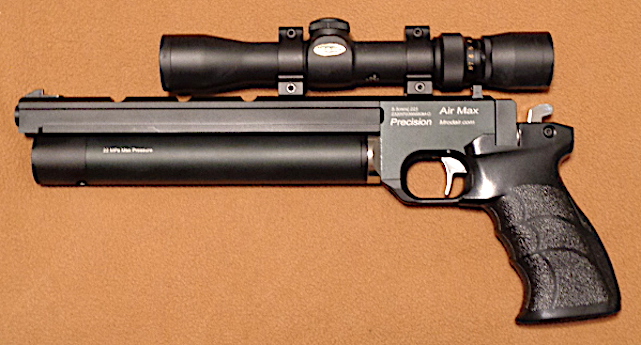

I've gotten great accuracy to 35-50 yards with 14.3 grain JSBs at 12 foot pounds with several pistols; my standard for FT pistols being 3/4" average groups at 35 yards (maximum AAFTA pistol range); 1" average at 50. Among those pistols are a couple PP700's, a PP750, and aforementioned 1950s vintage Sears & Roebuck FT pistol.

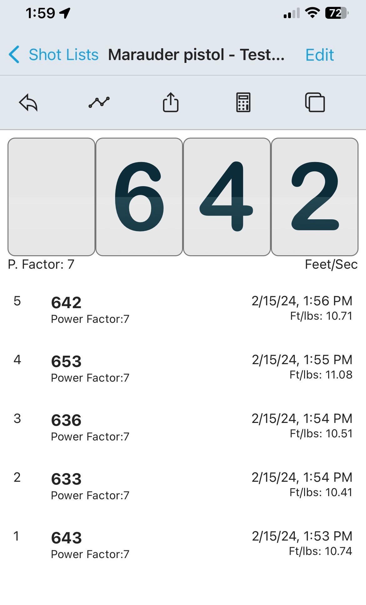

Anyway, I've been fooling around with the Predator GTO's 11.75 gr. I have left today and here's the best "cherry group" I could pick so far:
5 shot group at 20 yards from bench & a bag.
I might be closing in on a speed the gun likes to shoot these pellets but LoL I only have about 10 pellets left in the tin.
The FPS sure bounces around a lot with these non-lead pellets. Do chronographs have a hard time picking up non-lead pellets? Or?
Cameron recommended 650-675 fps, so it looks like his suggestion is about right on the money. Thanks!
I'll revisit this once I order some more of these pellets. Until then I'll play around with some other brands / weights I have around here.

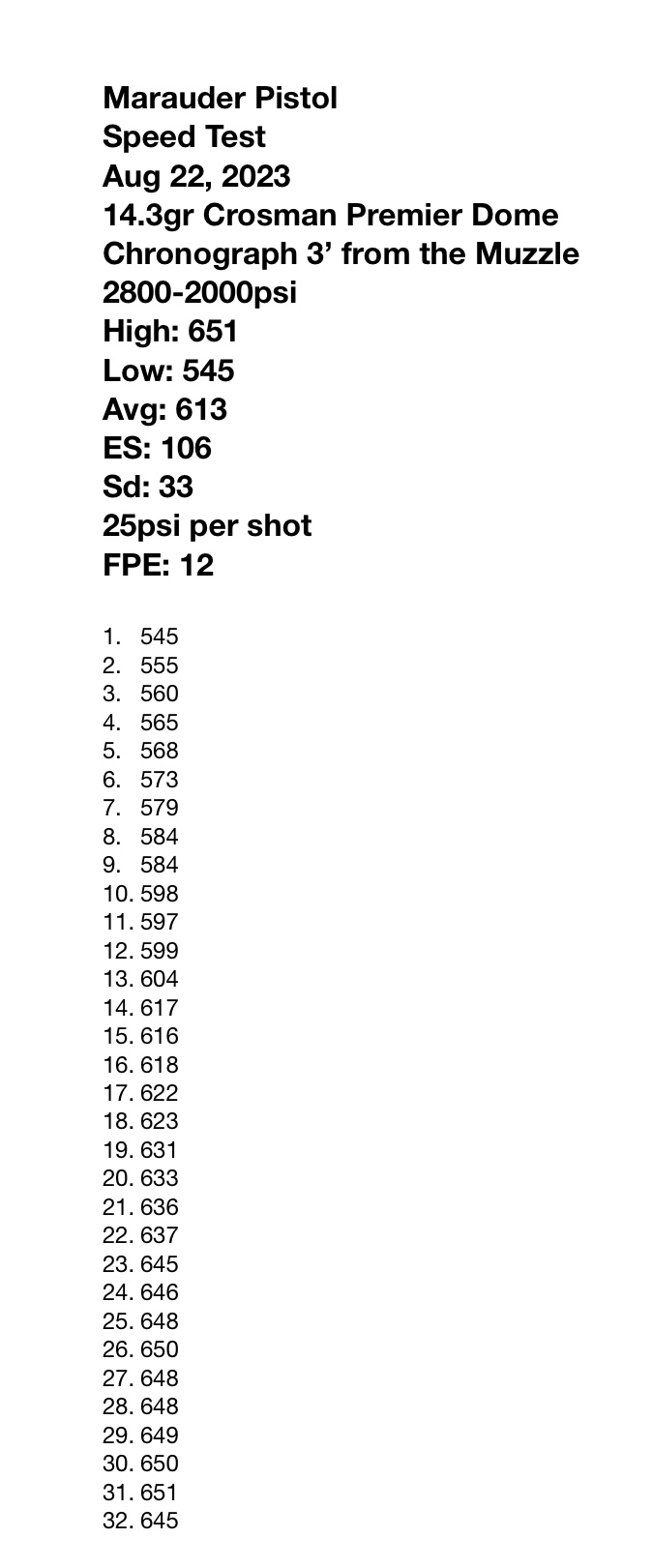

A 12fpe tune.
This tune will stack the Crosman 14.3 domes into one hole, all day long.
Just so you know……This is the factory tune:

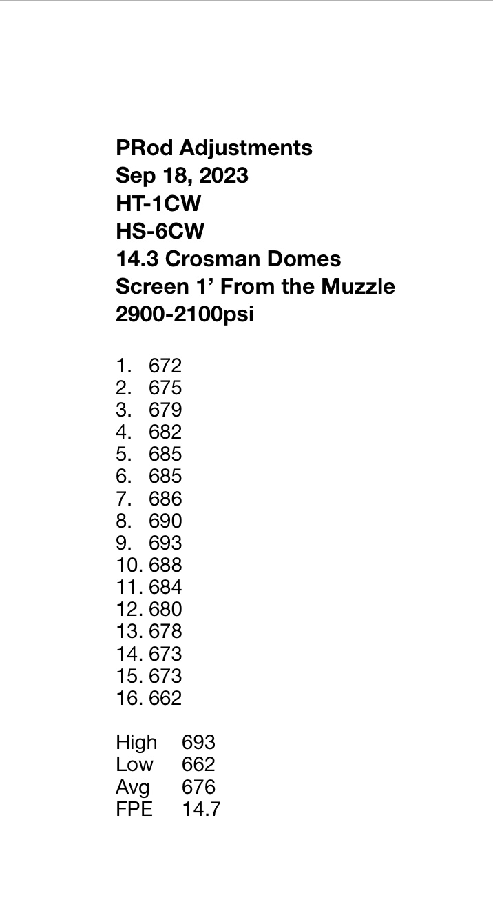

Frank, if you figure out what (lower) charge pressure your bell-curve starts producing about 620 FPS (shot # 17 above) and charge only that high, you can get a nice 20 shot bell-curve power-band with an extreme spread of only about 30 FPS, rather than over 100. Then your one-hole stacks will be even smaller!😁

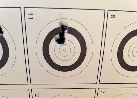

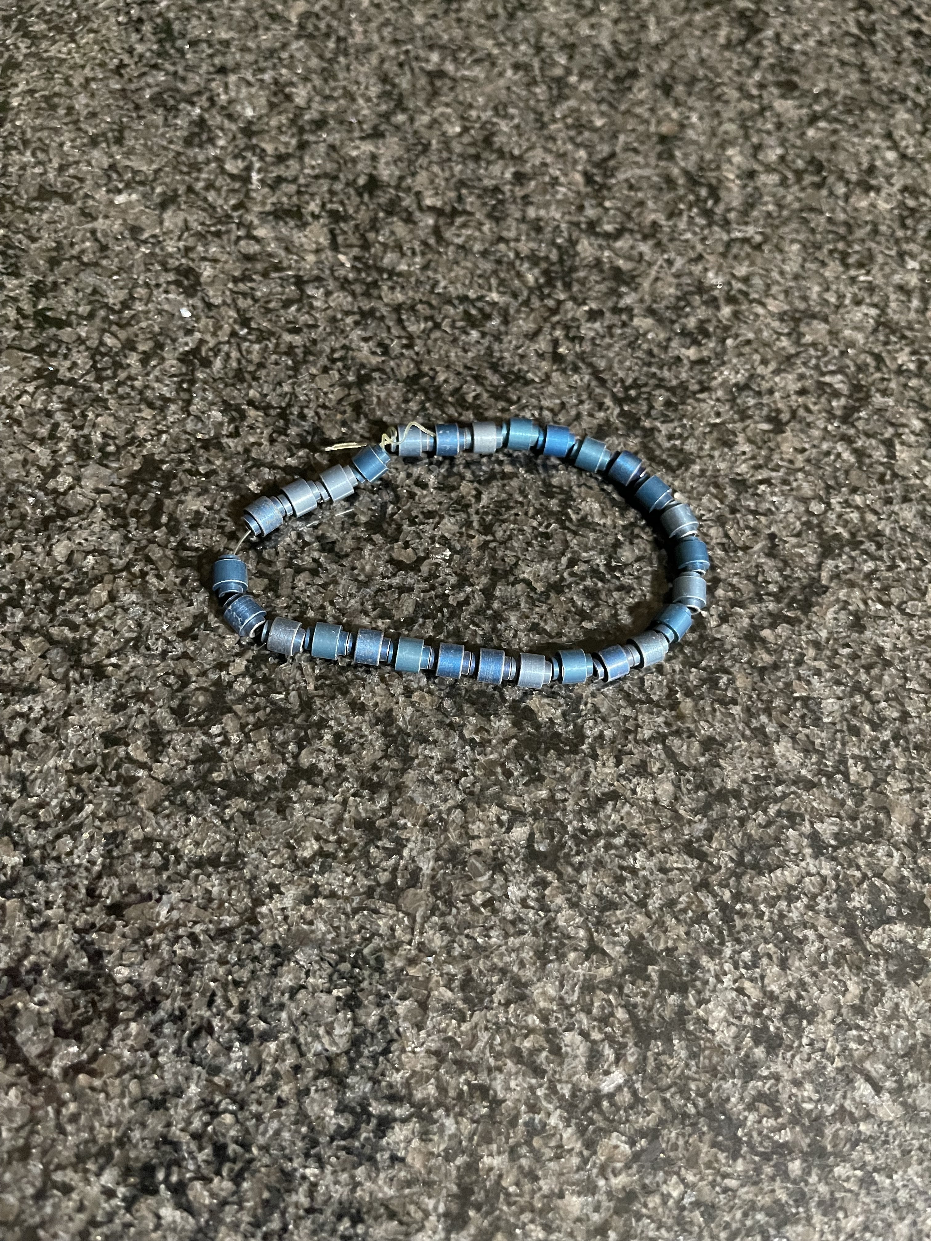

I tuned so many I made a few bracelets 😊
I’ll see if I can add a pic!
