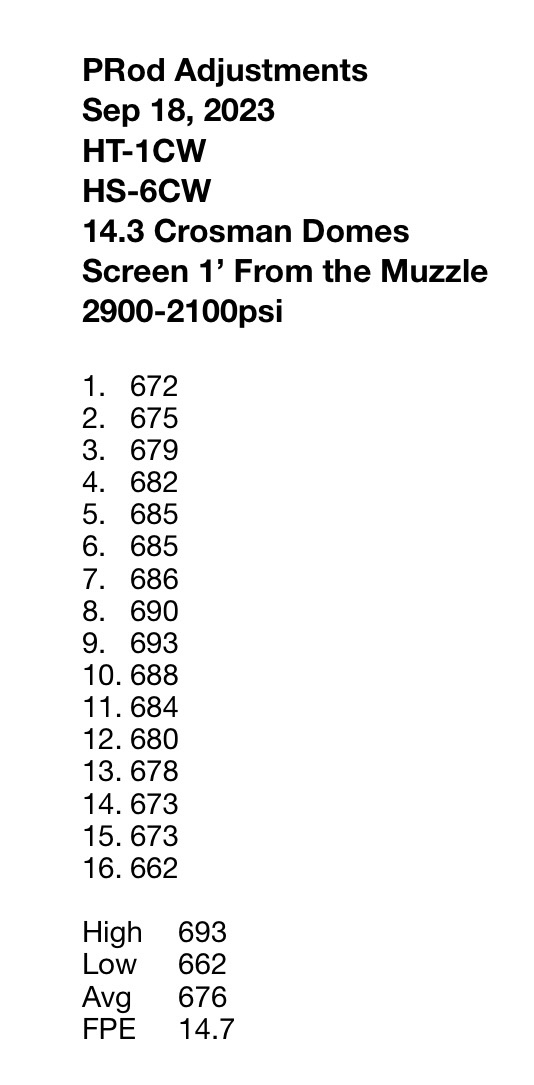

dad wants more than 700fps, which sounds reasonable enough. Increased reg pressure from about 130 to about 140 bar. Started with minimal hammer spring tension and worked up. Still get no more than 620fps even with hammer spring turned all the way up, at which point things go wonky. Also tried increasing hammer throw distance which didn’t do much of anything.

I turned the reg down to 125, set hammer spring tension and throw to their minimums, increasing both slowly, just looking for consistency, which I haven’t yet found. Only get 10 shots before it falls off the reg. Without the reg it gets about 24 shots, which is fine.
