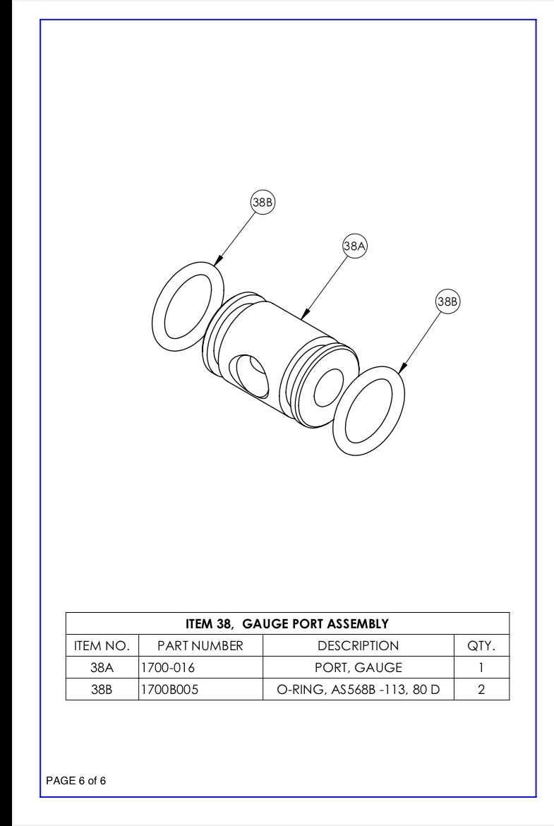

Your mistaking the leak. It’s actually coming from the gauge block o-rings. The thread would not leak after this many years. Only the rings would.
Now that you used soapy water you definitely need to take the gun apart or send it to a reputable shop. I say this because the longer the soapy water sits inside the block up around the inside of the tube it will definitely start rusting and pitting the steel. Then your guns shot.
-113 o-rings. Don’t use horrible freight O-rings.

Yes there is. This is the part your gauge screws to and is inside of your tube. And like I said – 113 O-rings. You do not have any washer on the bottom of this block because your gun is too old for the changeover that was 2 1/2 years ago. And yes it will rust out if you use soapy water because between the two O-rings there is a dead space of air there is pressure on both sides or it would leak out like it’s doing to you.

Airgun-revisions has given you spot on advice, the piece in his drawing is inside the tube

Now I get it. So part 38A on the drawing is INSIDE the reservoir tube, and the port right by the arrow at 38a is actually what the pressure gauge screws into, right?
I'm still missing something, mentally. If part 38a is inside the tube, and the pressure gauge screws into it, then it must allow pressure to enter the gauge. Its not sealing pressure away from the gauge. And if the leak is in the threads of the gauge, then how do the o rings (38b) prevent leak from the threads of the pressure gauge? They're not keeping pressure away from that...

it is the 38B o-rings that need replaced, the threaded hole in the port 38A is a close fit to the tube and air leaking by the o-rings will come out and appear as if it was coming from the threads,,, it all needs to come apart,,, and the gauge will need new tape also. now
the drawing does not show the threads in 38A, but they are there
7 years old,,, it is the best bet,,, it is the o-rings and the question is ,,, are you inclined to do the repair yourself?
