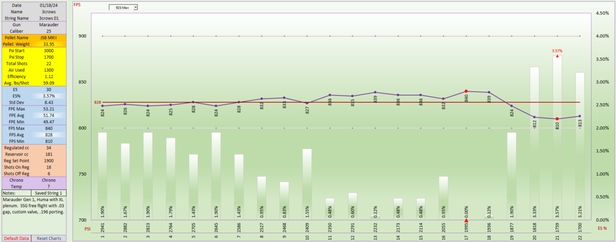

This is for the Huma regulated "Cobra" M-Rod and since this string I tuned the power down (increased hammer gap and reduced slightly spring tension) just a little and went to JSB Hades 26 grain pellets so now it will shoot three magazines at 48 fpe average on a nice flat string.

Mostly true except I get 24 shots @ 60 fpe with 190cc regged.
Port diameter has a HUGE impact on efficiency....mine is .225"

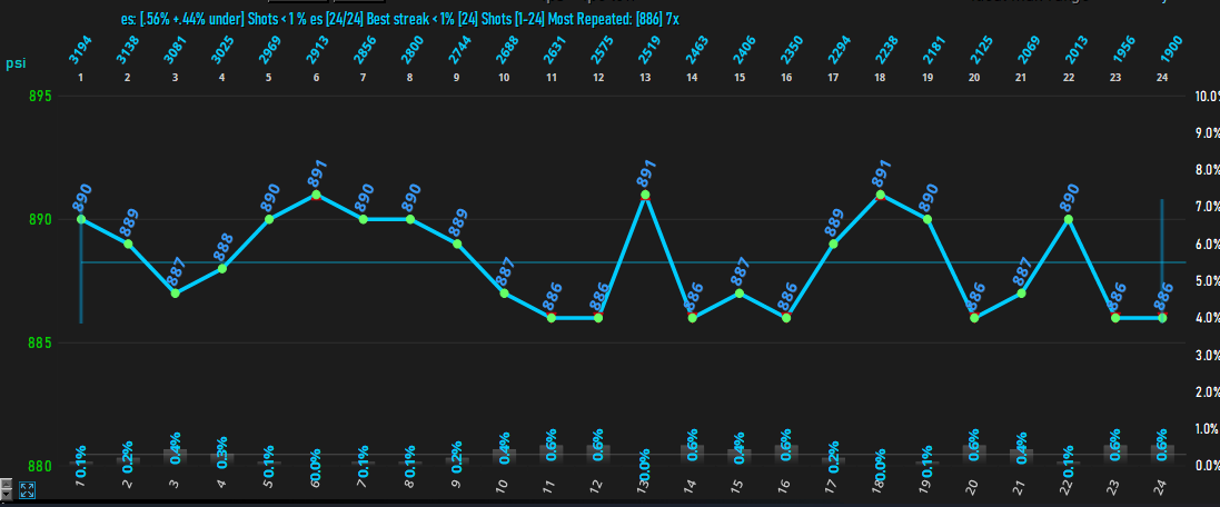

I ty to tune at around 5% below peak on the two regulated rifles. That results in a mini-Bell curve once off the reg and those are still useful shots off the reg.
Curious, what is your regulator pressure? I may need to toy with that again?
