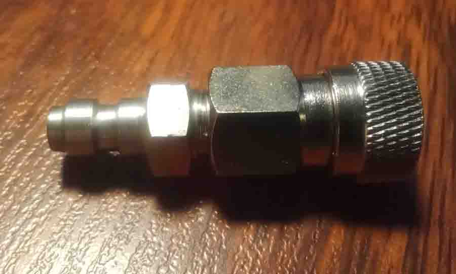

Have a pretty new marauder here... the fill valve does work, but it's very sticky on closing. Opens okay on fill, but hates to close unless I can open the bleed VERY fast. In fact, I cannot fill it off my air tank since it has a push button bleed valve instead of the screw valve like on the nomad compressor, which does bleed OK if done really fast. Simply can't bleed fast enough with the push button I think. Filling off the tank then bleeding simply drains the hose and gun reservoir every time when I press the button. Tried stop and start as well, no change. The airforce guns do not have the same issue for me.
I replaced the fill valve once, but new crossman valve does the same thing. Oiled both, disassembled and cleaned both, no change. My friend has the same gun, but it seems to not have the issue. Ive filled it off my tank and no issue.
Any ideas?
Any ideas?
