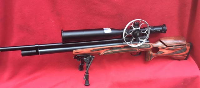

The red Generation 1 below has it all, thanks to motorhead...
Boyd’s’ Blaster stock with Brownell’s Lift kit.
Custom bolt
HUMA Regulator
HUMA Quick Fill
Modified hammer
Modified TP
Custom RAI Trigger guard
HAWKE 4-16X AMX Scope with Compu-Foil Wheel
It does not have an LW barrel because it doesn’t need one.
90 shots at 890fps with 10.34 AA pellets (which you should shoot in yours, BTW).

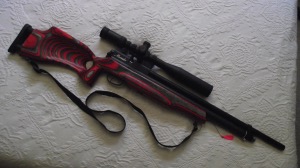

Scott built this rifle for me and for about a 7 month period a shooter in Ohio owned it. I bought it back and Scott had to tune it again...
Custom bolt
HUMA Regulator
HUMA Quick Fill
Modified hammer
Modified TP
