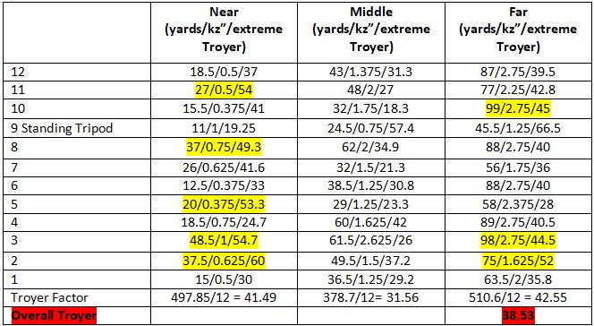

Here are the distance/killzone/troyer factors for all 36 targets.
Other than the standing tripod shots on lane 9, I highlighted (yellow) the theoretically hardest targets. The lowest T of those 8 is a 44.5, the highest a whopping 60. The average Troyer of those 8 "hardest" targets is an eyebrow-raising 51.6. Very much apples to oranges, but foor a point of comparison, the sub 20fpe flavor of field target (AAFTA) considers any single target with a T of over 50 illegal. And any course average higher than a 36 is also deemed illegal in AAFTA. Our course average yesterday was a 38.5T. Ultimate Field Target is a variety of field target that holds true to its moniker of "ultimate." The level of difficulty for the hardest targets is WAAAYYYYY up there for UFT. But there's also targets like the 1.5" @ 32 yards "middle" on lane 7 that can make a newcomer feel a sense of accomplishment.

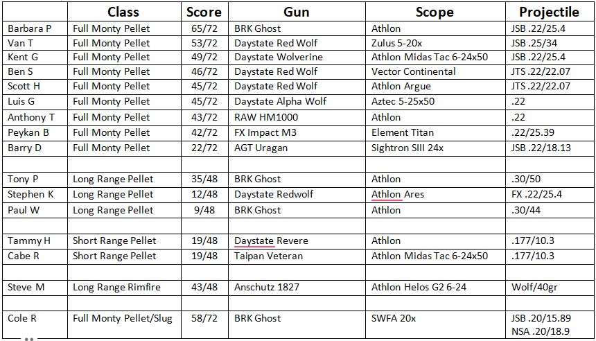

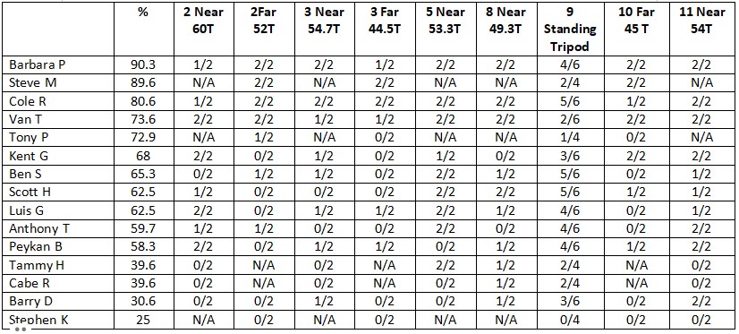

And here is how we all fared...
And some additional stats for comparing everyone. Each column represents the yellow-highlighted targets above. Not very fair to stick everyone in the same chart like this, since we've got 18fpe .177 pellets, all the way up to rimfire, but still interesting to see the breakdown. So, this following chart is offered as primarily a means for competitors to see which of the hardest targets are costing them points.
This was Tammy's first UFT match, with a new gun/scope/rig. Very challenging course for a 18fpe .177. And she did great! Congrats on the win. The tie in her class was broken with longest streak, she had 5 in a row, and Cabe's longest was 4. Always good to welcome new folks out to the matches.
Steve M dusted off his rimfire. I saw or maybe heard him say that he hasn't shot a rimfire at a UFT match for quite a while...maybe he said 2? years, choosing to use an airgun in that timeframe. The time away from his Anschutz didn't appear to bother him, as he turned in a very respectable 89.6% knockdown ratio.
And Barbara. Man o man she's on fire for these UFT matches. If I'm not mistaken, she has been overall match high for 3 months in a row now. Congrats Barbara!!!
