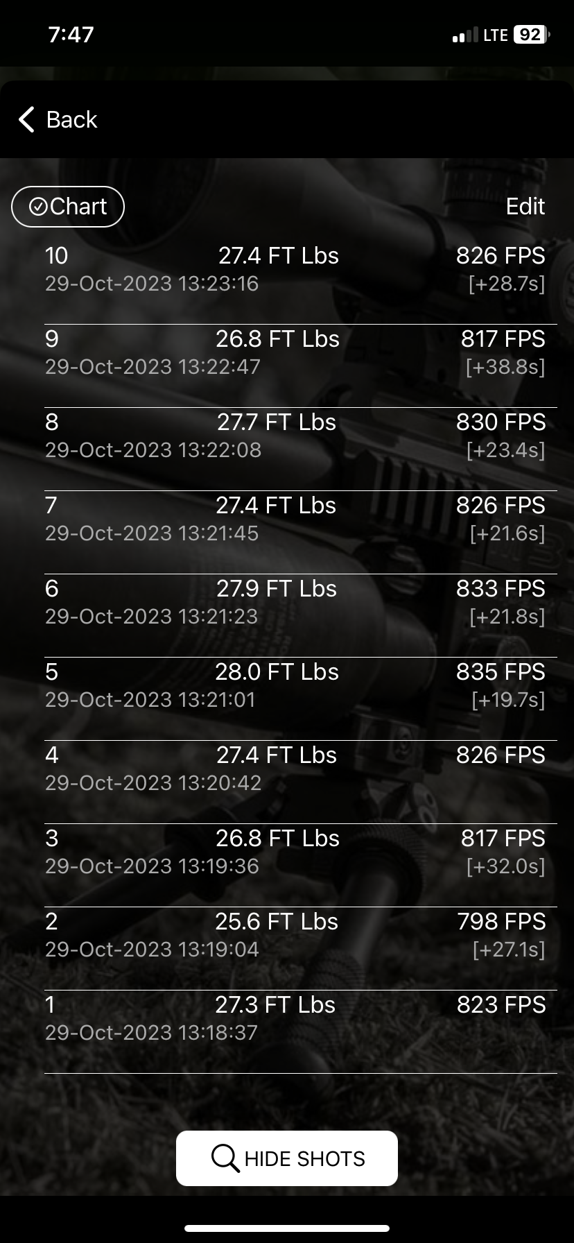

What .22 springer shoots with that kind of power? Maybe your definition of mid-weight is different than mine? 18 grain at 900 is 32 ft lbs. There isn't a Weirauch in the catalog that can do that.
This is a string from my Gamo Magnum shooting 18.1 grains. M
