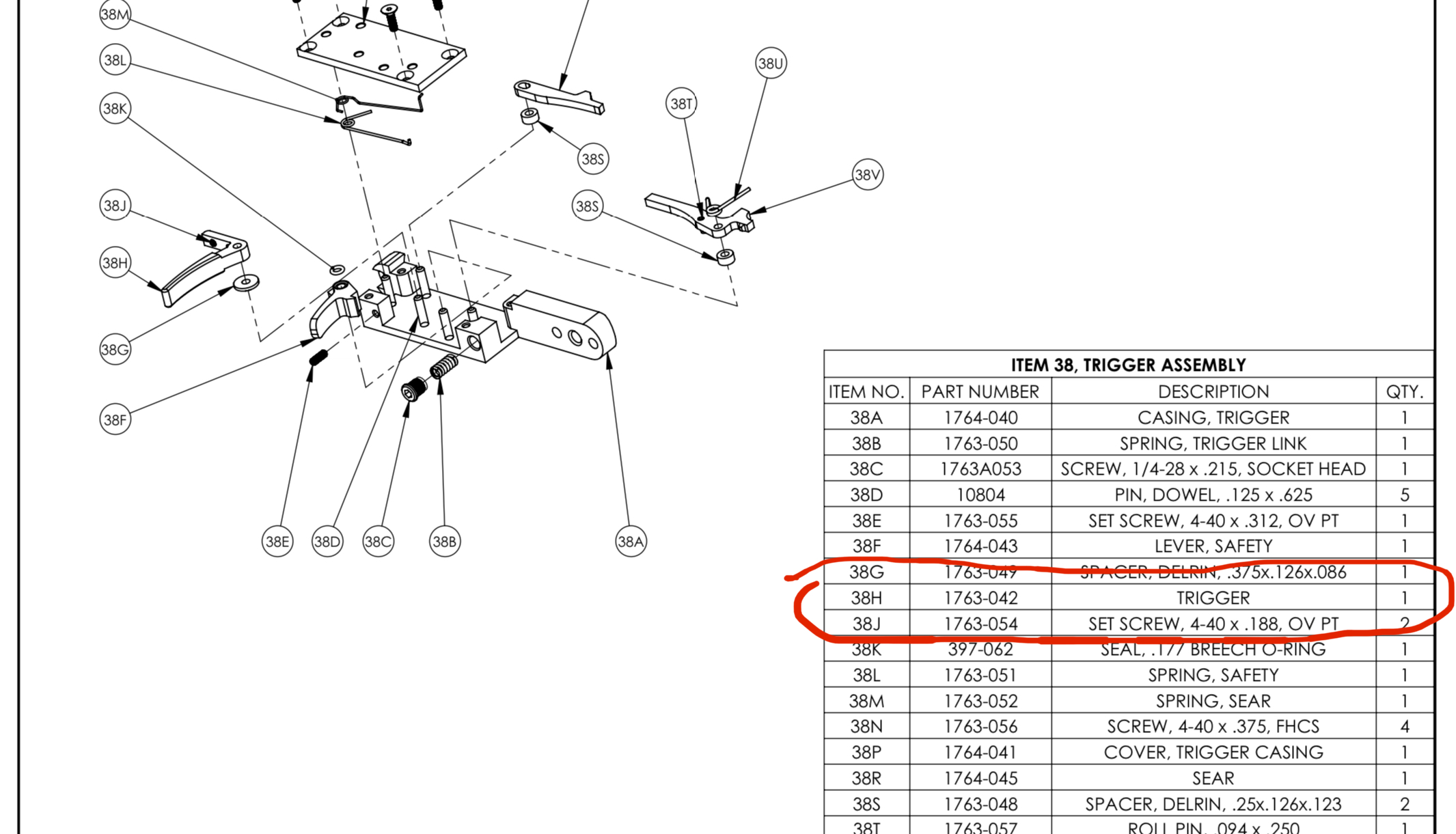

So I need the EVP to get the part number I already listed?
@HW100Tuning I believe so. You posted the model number (BP1764) which is listed on the first page of the EVP. That lets us know that the parts listed in the diagrams (contained in the link that @dan_house posted) will fit the specific .177 Marauder model that you own.
Then you must go into the diagram and locate the part you wish to purchase. In this case it appears that you want the trigger blade. So look at the picture of the trigger blade, find the number/letter combination that points to it, and look for it on the list in the column to the right (in the red circle).
When placing tour order, that’s the parts number that you give to Crossman. If ordering over the phone,they should be able to tell you if the parts are in stock and may be able to provide an estimated shipping timeframe. I’m not sure how it works for people living outside of the U.S. Considering what’s mentioned in the article you posted, I think once you have a rep on the phone that would be a good time to be sure that they understand exactly which part you’re trying to order if there is a difference. I’ve ordered parts from them a while back and that’s how I recall the process going.
