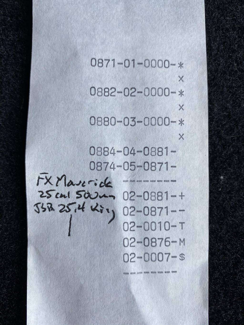

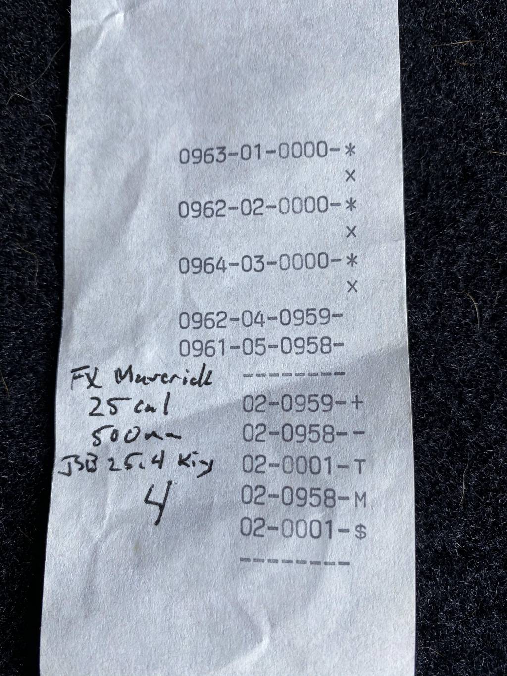

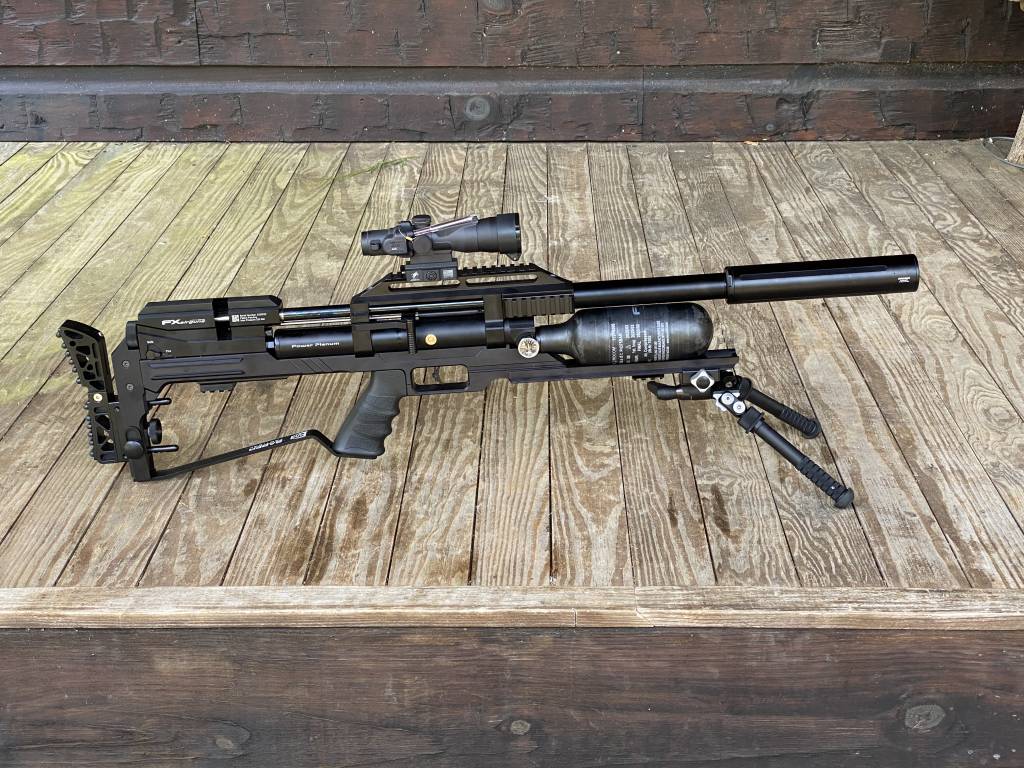

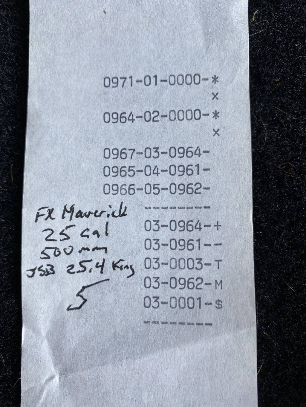

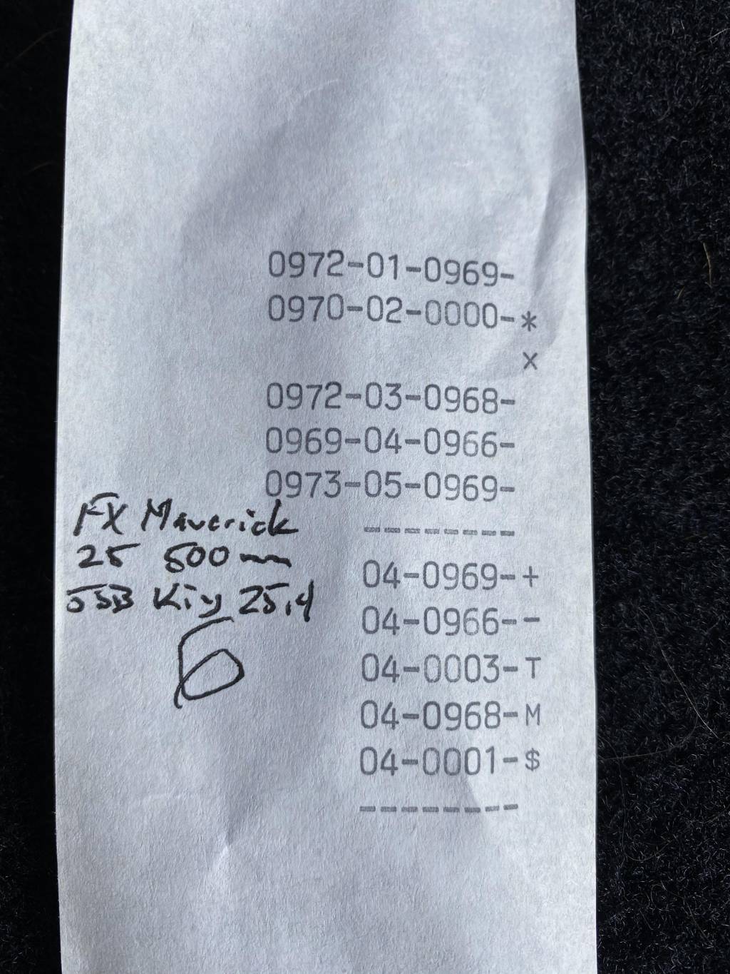

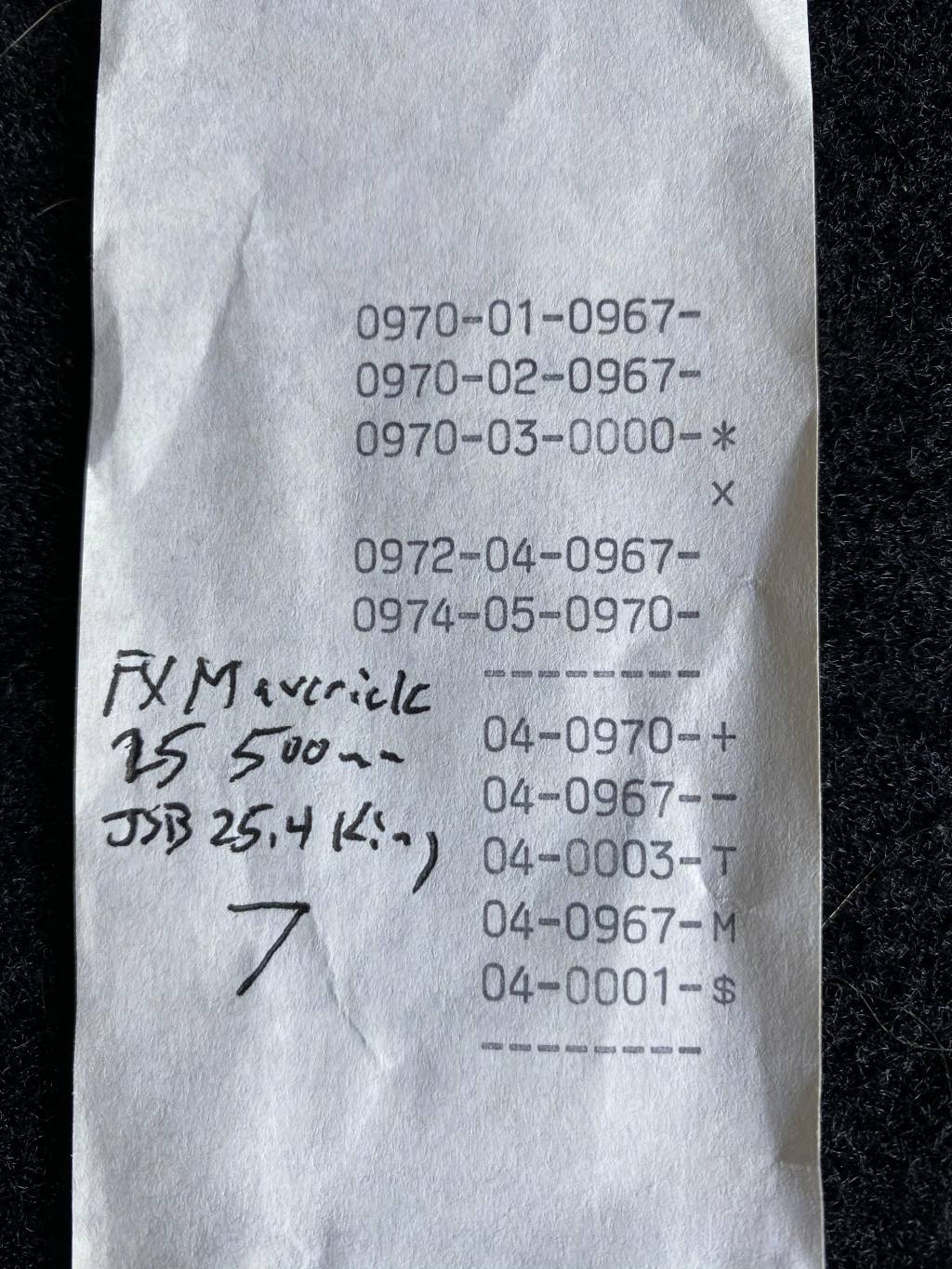

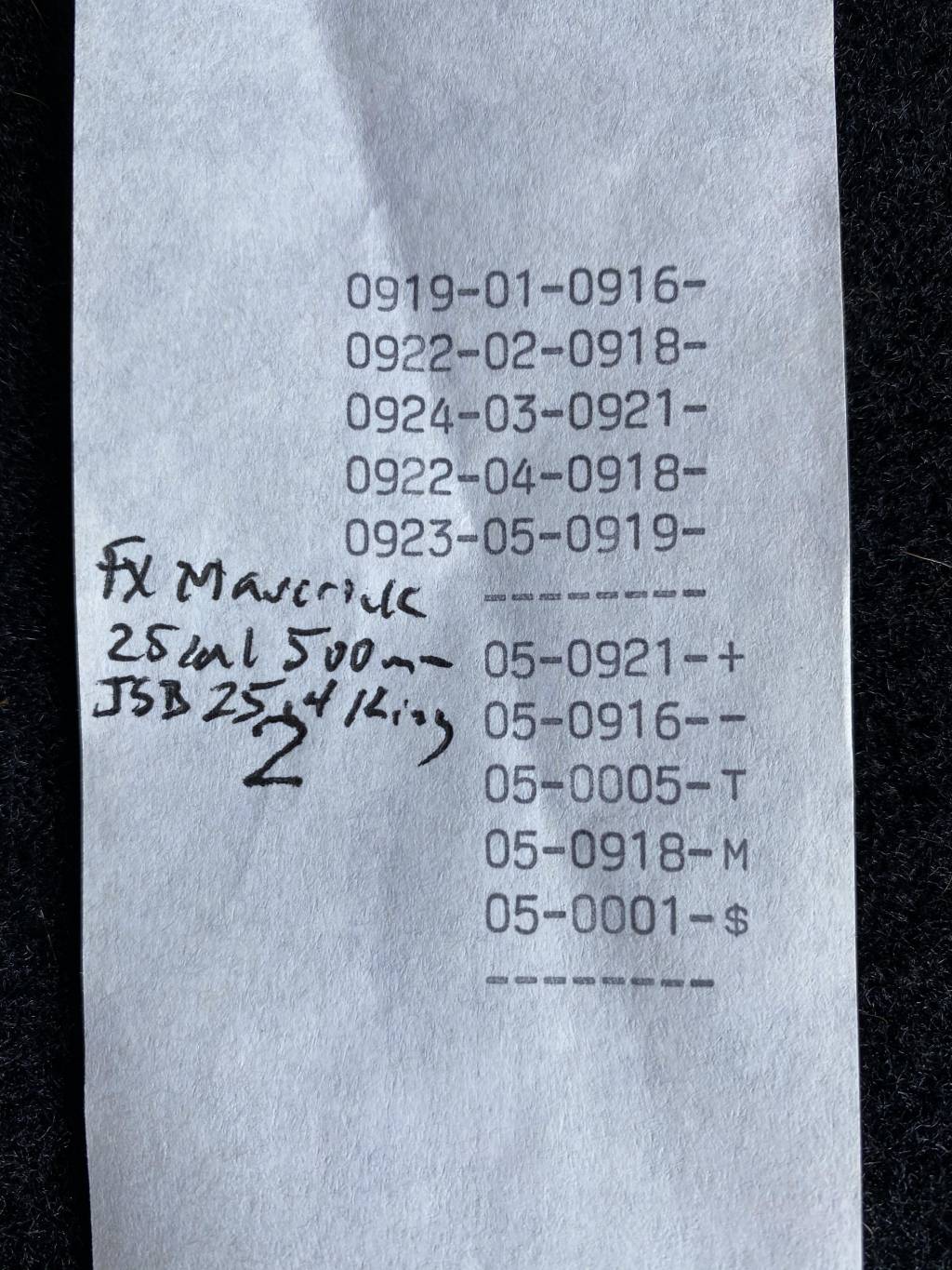

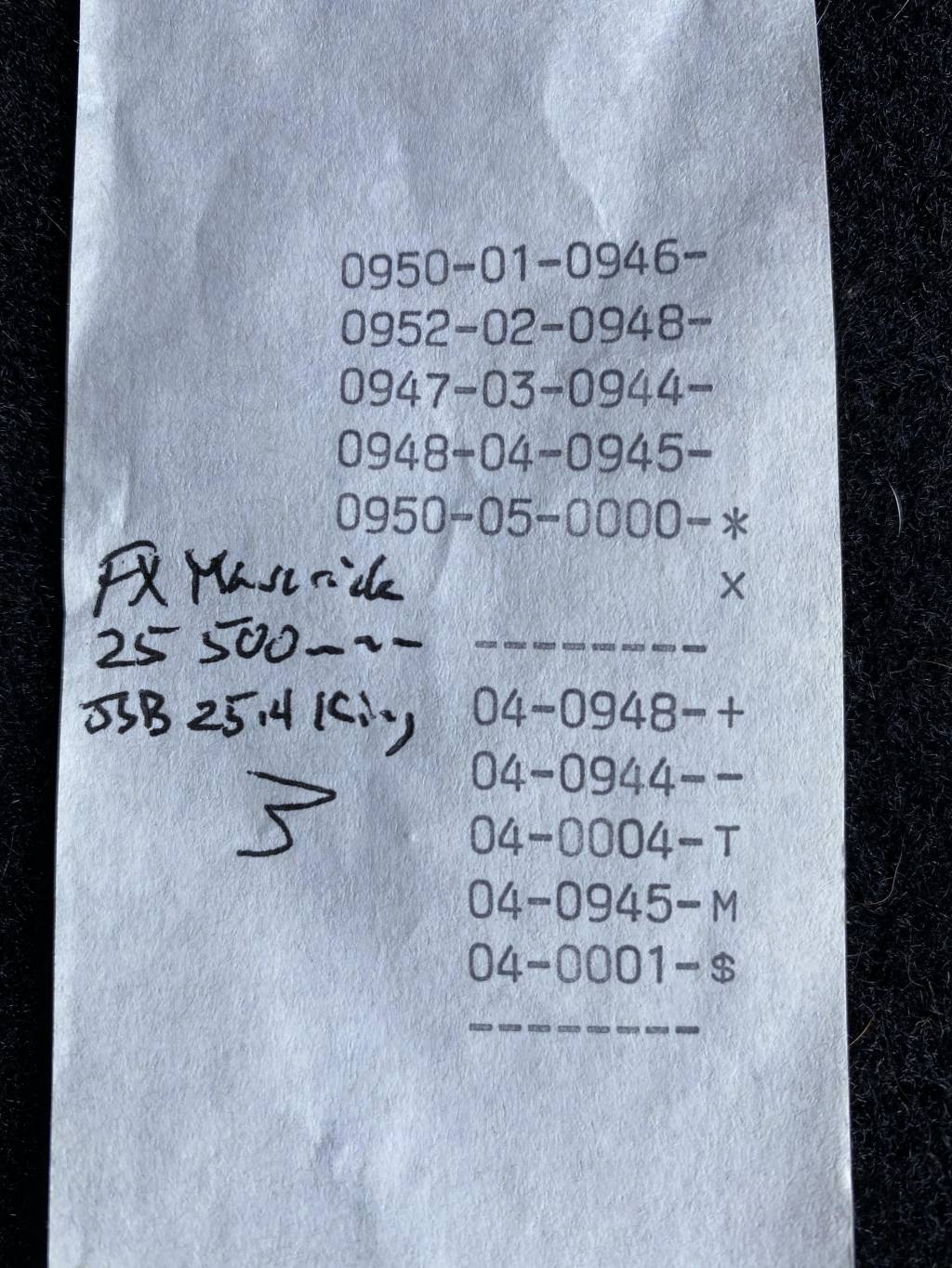

I had my Maverick 30 cal Sniper set to 150/180 on regulators and hammer spring screw maxed out. I recently installed a 25 cal 500mm barrel on it and put a 3 power Acog up top for a lightweight setup. I decided to leave regulators at same settings and use the same 30 cal hammer with screw maxed.
It works surprisingly well with JSB 25.39 pellets. Now if I want to swap calibers all I have to do is change barrels.
