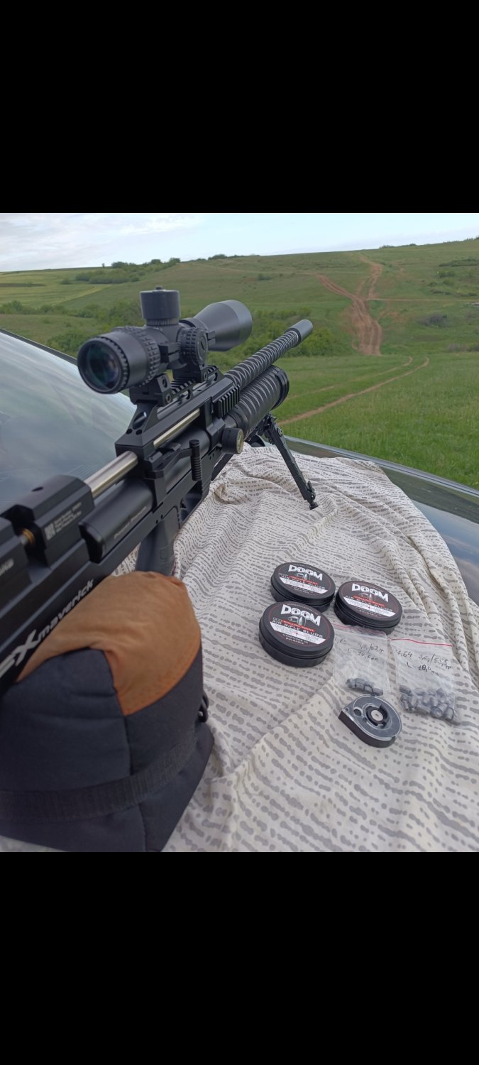

Maverick sniper 700 mm heavy liner, huma-air slug power kit, hammer 26.4 grams, Bulgarian slugs made by friend 55 grain , speed 290m/s or 951 fps, regs 195/165 bar. Good settings for 150 joules.
