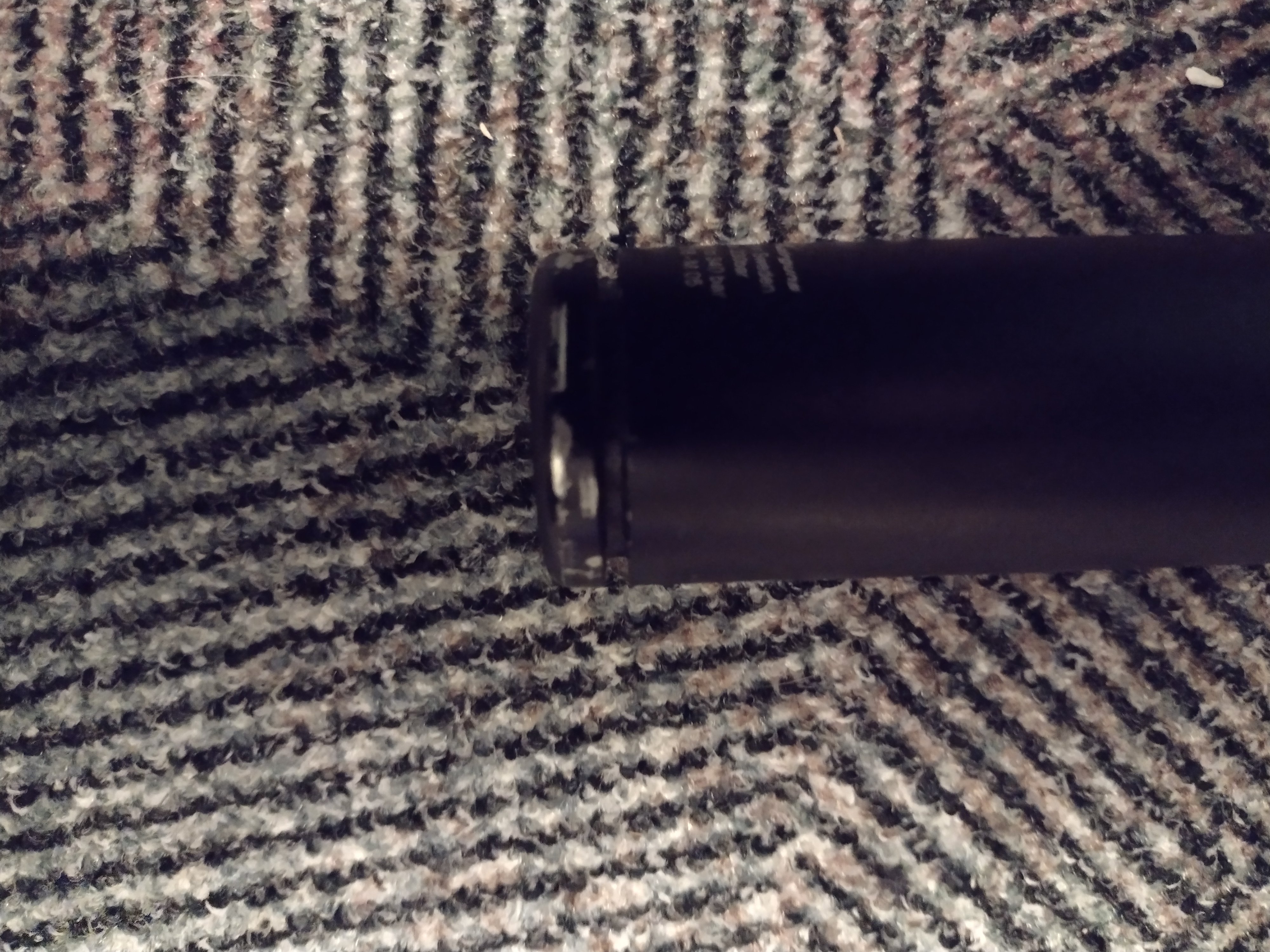

Hi everyone, I'm new here and new to the FX Maverick.
I was wondering if anyone else has had the issue where removing or screwing on a full bottle is almost impossible?
I have been filling and removing the bottles for tuning etc for the last month with no problem, easy and smooth.
Over the last couple of days I noticed they were getting quite stiff. I checked the threads, o-rings etc and all is well.
It has reached the point where it is now not possible without serious effort.
Has anyone else experienced this or heard it happen before?
Many thanks
