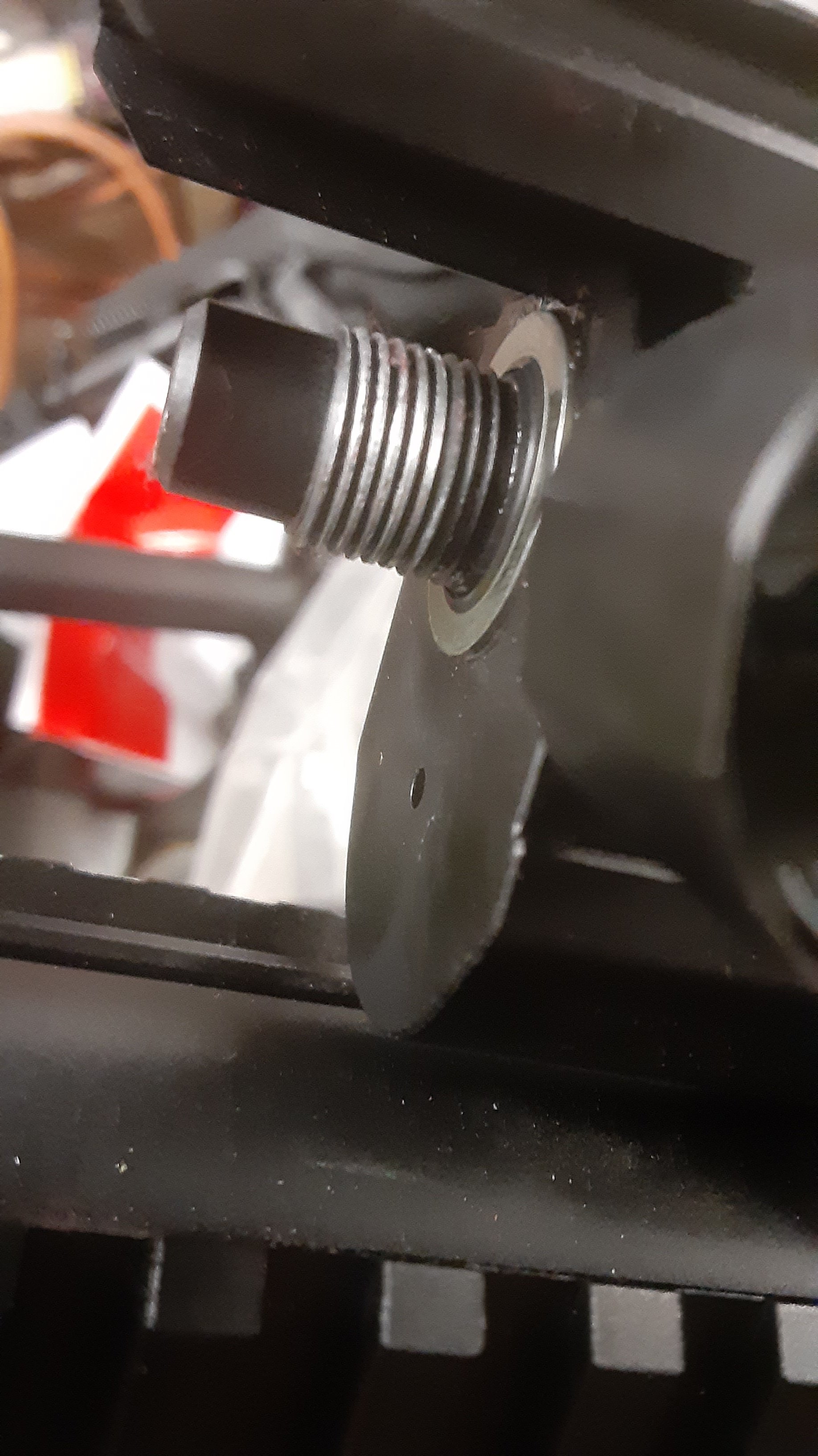

The same thing happen to my Mav. Bottle never was easy to remove but got worse with some time on it. Got to where I had to go 1/2 turn off and a 1/4 turn back on to get it off. I called Utah Airguns where I bought it and they took care of it right away. I haven't had any problems with the new part.
Yikes, toasted threads look like the problem there
