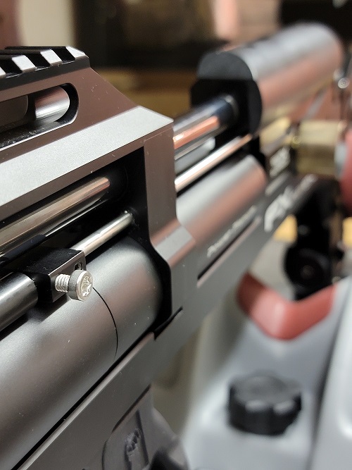

Had a few loose screw issues. Mostly the linkage between the cocking lever and operating rod. Don’t care what anybody says, blue Locktite those dudes. You will only regret not doing it.

Good call Chukar60 👍 I replaced one of mine with a longer star bit thanks to @Bigragu
M4 x 8 low head Torx socket head from Belmetrics.
