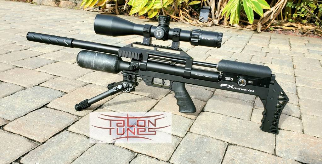

.25 compact with all the bells and whistles shown as well as dual port transfer port and a couple mags...I did purchase a 580cc bottle and 700mm .30 and .25 barrel kits and mags so can swap between compact and sniper versions...

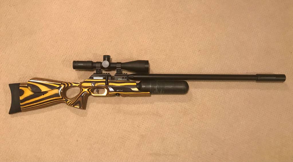

Then, while visiting my local dealer, he had one of the last Crown MKIs in his shop and figured that now the new MKIIs are out, he couldn't get rid of this so he made me a deal I couldn't refuse. Took it home and voila! It shot as good as the MKII. I always kinda like a conventional wood stocked rifle, but never could get my courage up to buying a Crown, but I'm glad I did. Now, I won't have much need for the tuning kit. Does the new Maverick appeal to me?? NAH!
