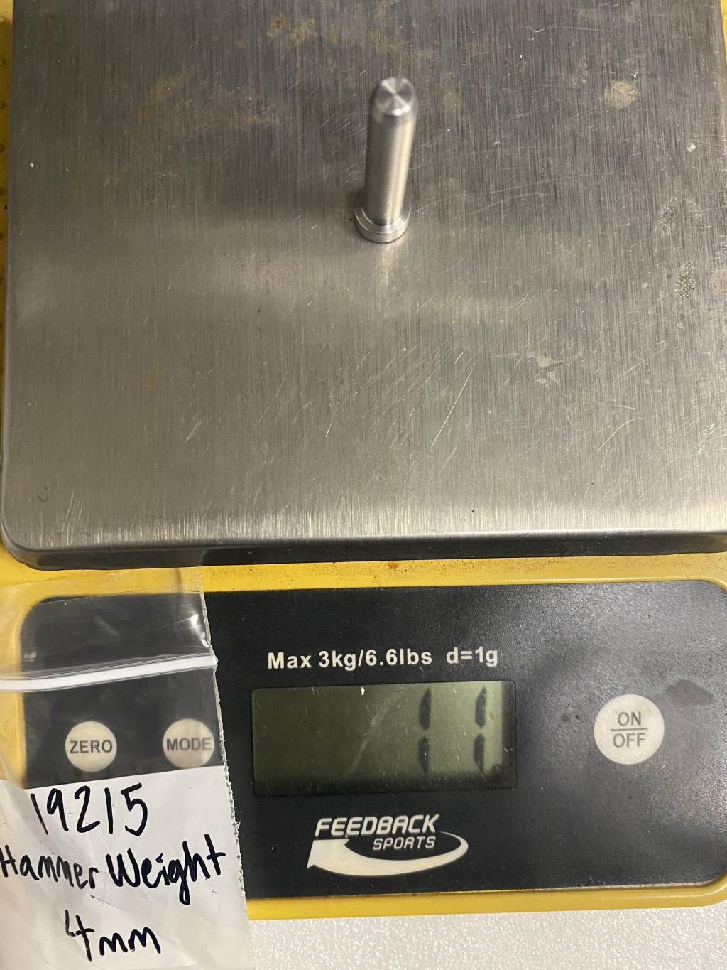

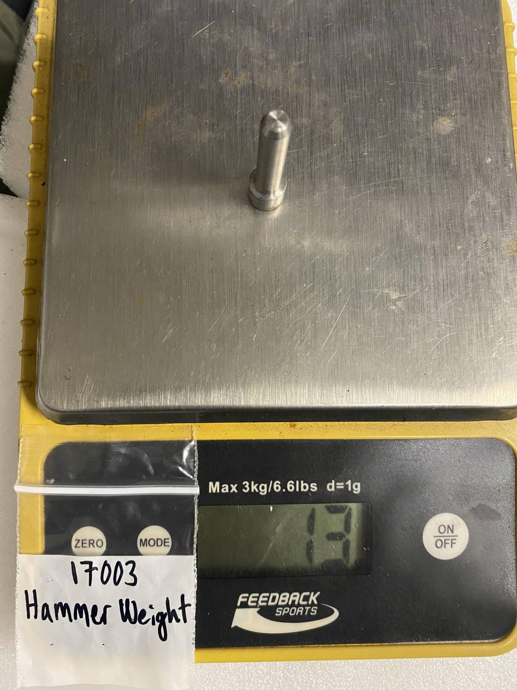

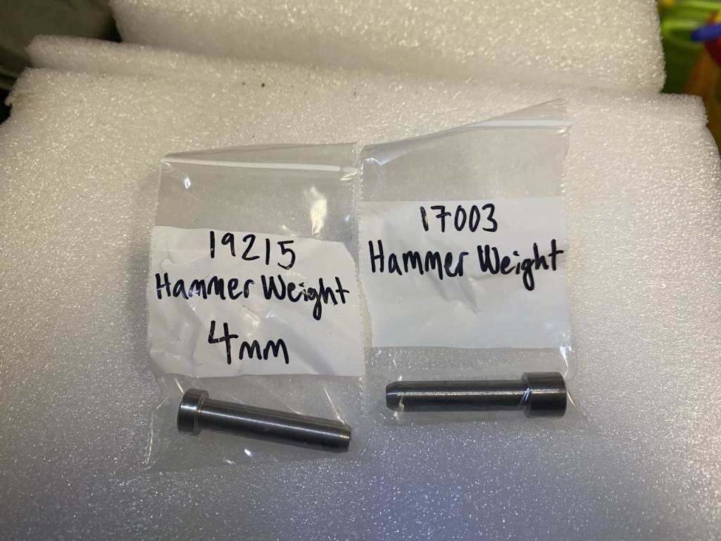

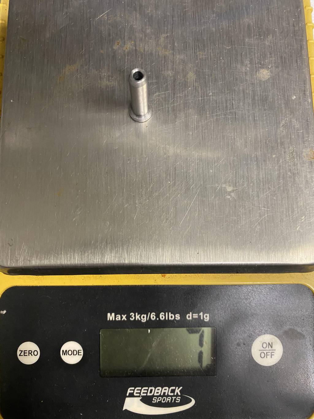

not sure which one is heavier yet.
factory .22 light hammer weight is 7 grams
medium weight hammer labeled 19215 is 11 grams
heavy hammer labeled 17003 is 13 gram.
stock 7 gram hammer weight will shoot 18 grain pellets at 900 FPS with reg at 100 bars and hammer NOT maxed with 500mm barrel!!! that is super impressive power!!!!
Installed medium hammer and this thing is going to shoot HOT! Will see what it does with my NSA sample packs all the way to 28.5 grain. With medium weight think it’s going to be next to impossible to get any pellets under 900 FPS.
