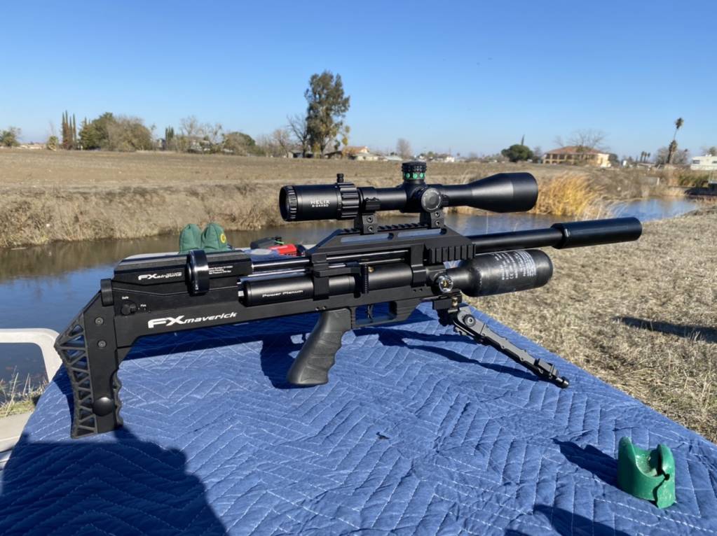

Finally got the Maverick out shoot and boy did it shoot! 30 yards slug on slug 1 hole no matter the wind and the wind was 6-7mph swirling with gusts of 10-12 MPH constantly shifting so challenging condition for sure. Put out a target at 105 yards and the 23 grain slugs @870 FPS is definitely under 1 inch if the wind stay consistent long enough so got clusters of 3-4 shots touching then the wind would change direction then another sub 1 inch cluster. Tried 28 grain which only shot at around 800FPS also 1 hole at 30 and sub 1 inch at 105 yards if the wind doesn’t shift. Over all extremely impressed!!! This is with little tuning if any, just the medium weight hammer with reg at 120 bars so not even pushing it at all. Shot count is about 3 mags at 200 bar fill because my buddy’s tank is low.
this little gun is absolutely amazing!! So amazing it decided to stay at my buddy’s house from now on(he called dibs the day I received it)! Hahahaha
WOW is all I can say when it comes to how well it shoots and this is from a rather spoiled Impact owner!

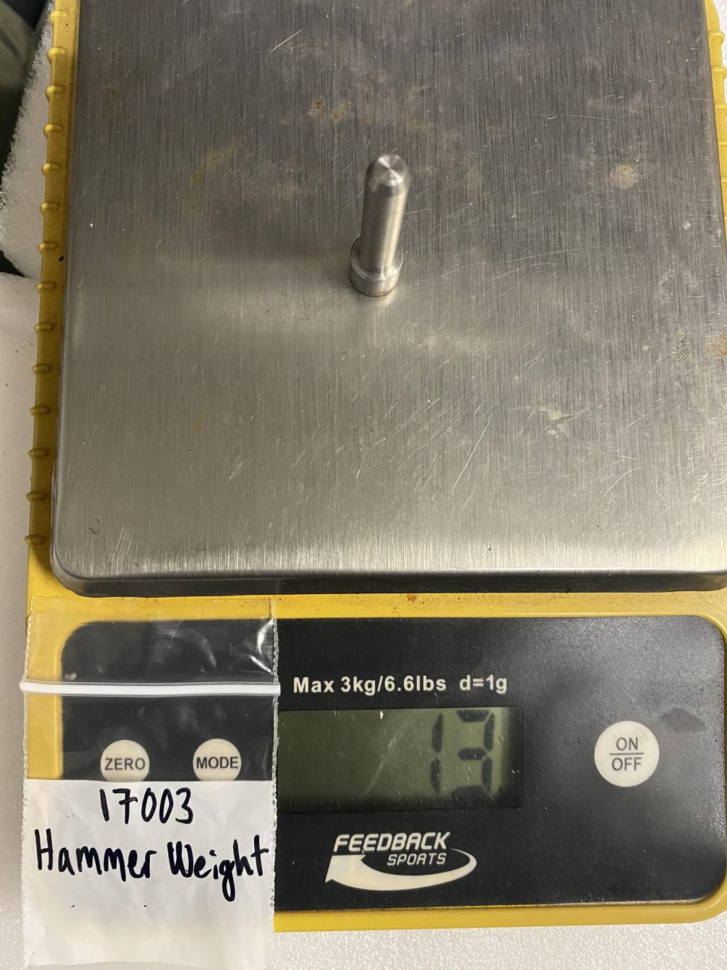

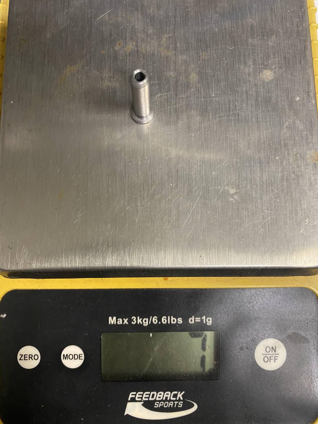

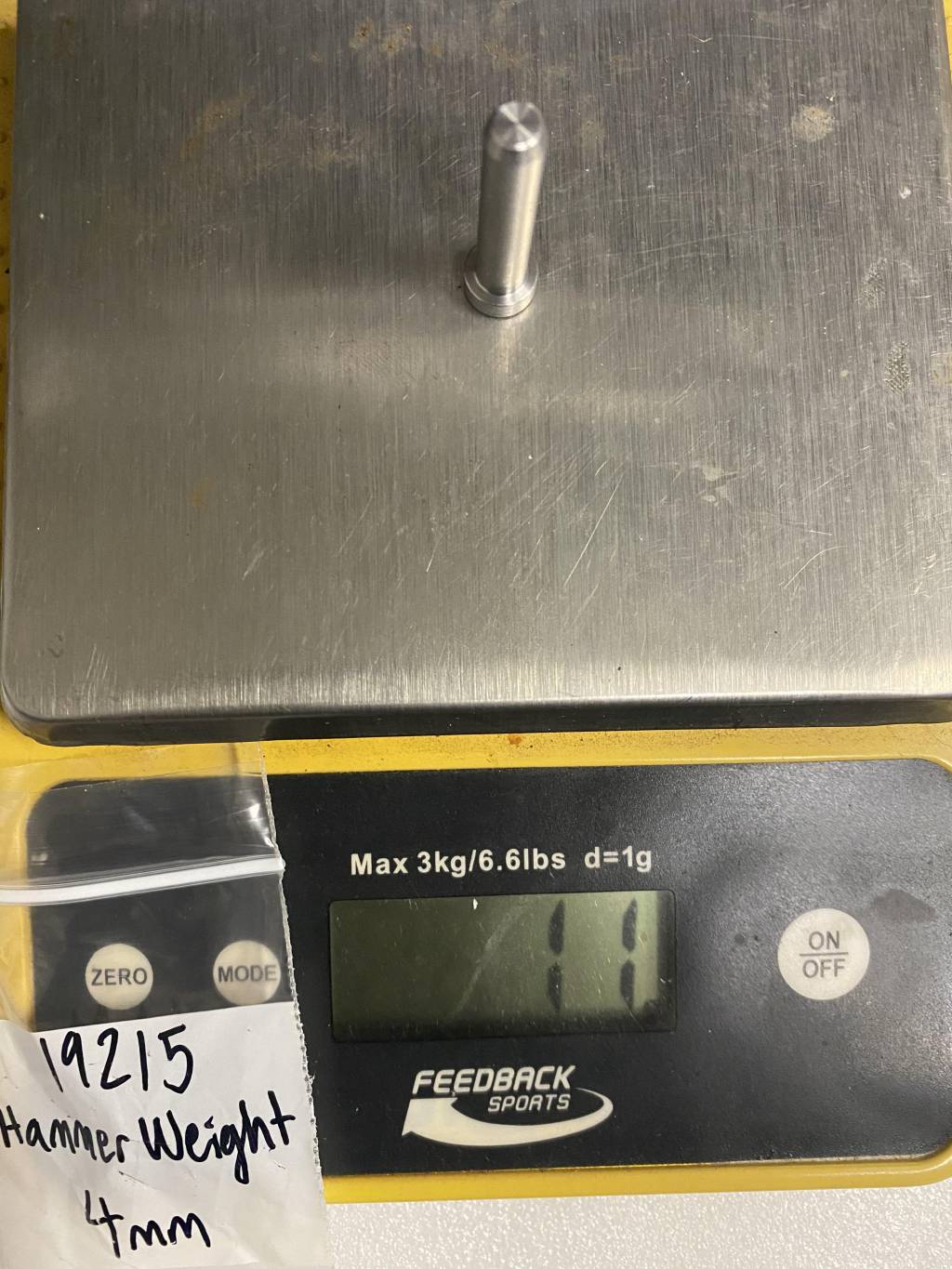

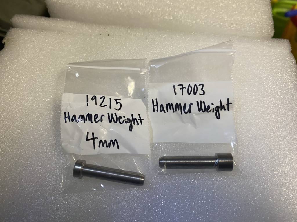

factory .22 light hammer weight is 7 grams
medium weight hammer labeled 19215 is 11 grams
heavy hammer labeled 17003 is 13 gram.
stock 7 gram hammer weight will shoot 18 grain pellets at 900 FPS with reg at 100 bars and hammer NOT maxed with 500mm barrel!!! that is super impressive power!!!!
Installed medium hammer and this thing is going to shoot HOT! Will see what it does with my NSA sample packs all the way to 28.5 grain. With medium weight think it’s going to be next to impossible to get any pellets under 900 FPS.
this got me thinking.....if I use medium or heavy hammer can I shoot the 177 pellets close to HMR speed??? LOL!

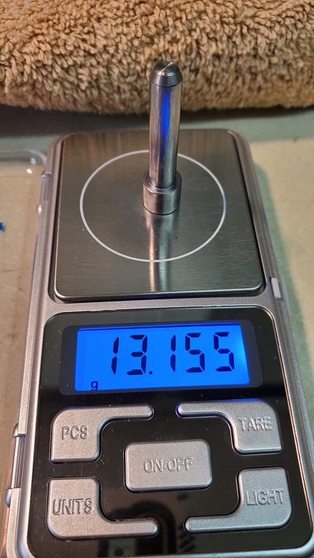

Hi. The question is a little off topic, but tell me the exact geometric dimensions of the part 47: FX Dreamline Hammer Weight-17003 (in millimeters). Since the borders between countries are closed and I can't order this part for my FX Dreamline Tact compact 0,22 cal., I want to make this part. Currently, my air rifle has a Hammer Weight -19215 part installed, and according to the instructions, the hammer weight – 17003 should be installed in it. The maximum speed of a JSB bullet (18.1 grains) at all maximum settings in my air rifle is 238-239 m / s (780-785 ft/s). To increase the power, I wanted to try installing a new hammer weighing-17003.

My Maverick came with the lightest hammer weight too. After installing the heaviest hammer the rifle had no issues pushing heavy slugs.
To get a heavier hammer weight, reproduce the same dimensions as your original weight, but with a longer head and not drilled. It appears the head is twice the length as the original.
