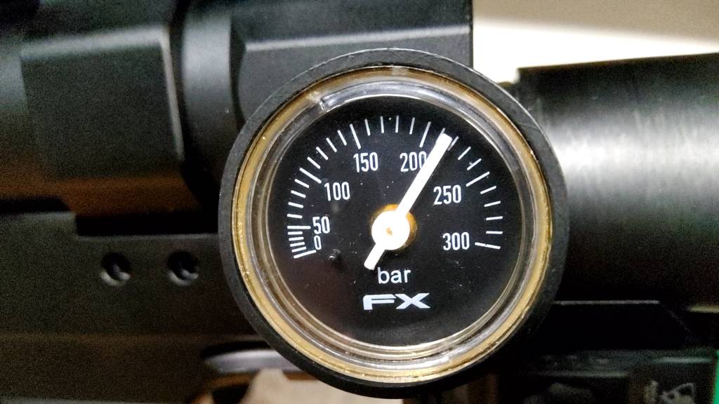

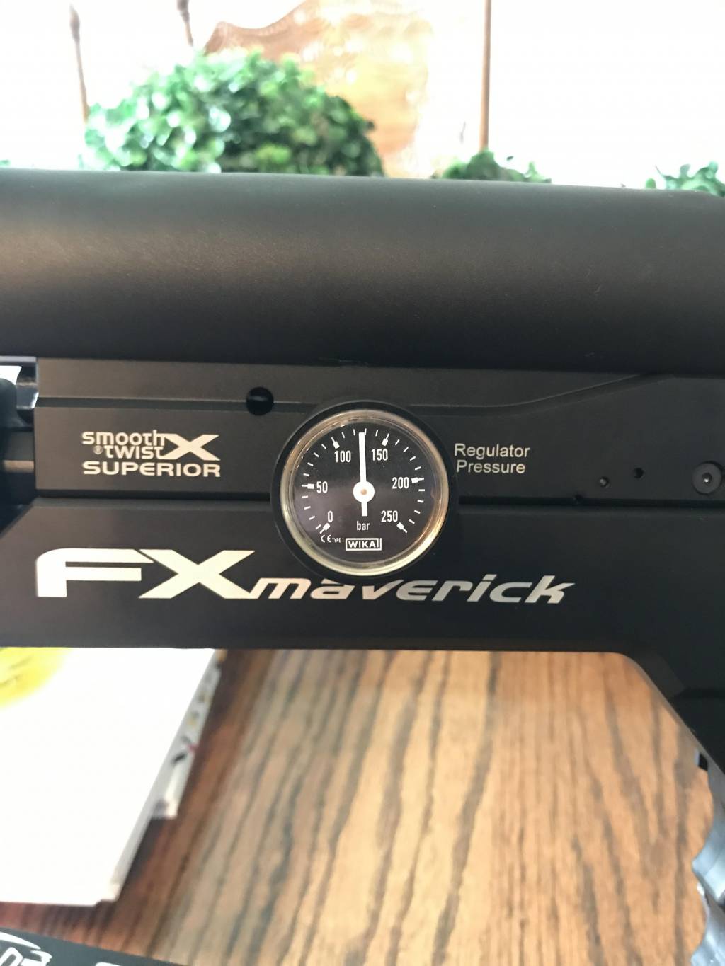

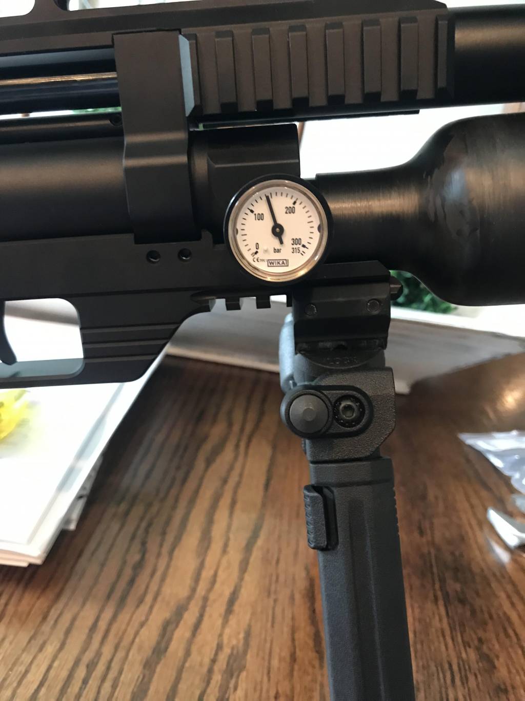

So I finally got around to replacing my gauges on my Maverick. These 28mm Wika gauges are awesome. The reg gauge was off by 20 bar. I was showing 145 on FX. Now it’s showing 125 on Wika. The bottle was showing 170 now it’s showing 145.
